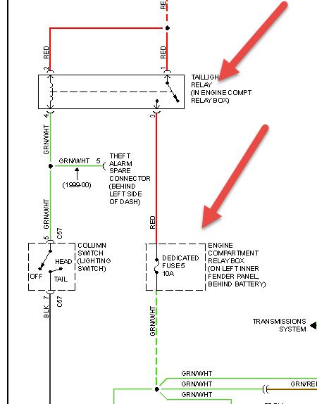

Dash lights and tail lights not working since having towed a flatbed trailer. The fuses and bulbs have been checked and they are good. What else can I check?

check items in pic and see if wiring harness is broken in back where trailer lights are hooked up.
