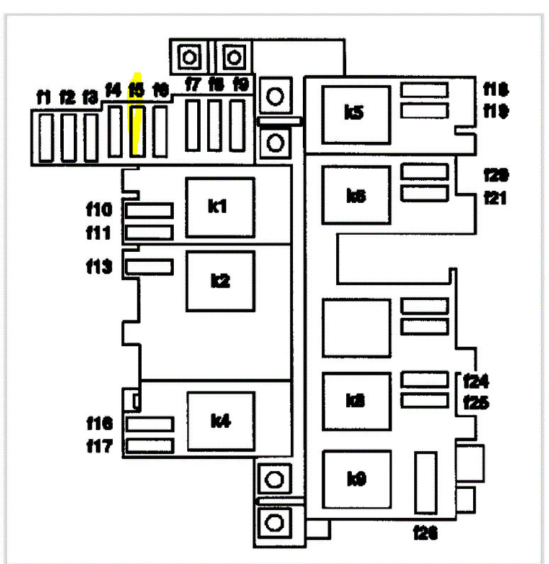

dash lights not working
2005 MERCEDES BENZ ML350
85,000 MILES • 2WD • AUTOMATIC
DUSTY RADABAUGH
The dash lights are not working in the vehicle.
Dec 28, 2020 at 3:09 AM
  • 110,240 POSTS

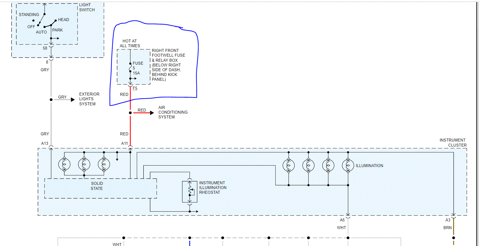

The first thing to check is the 5 amp fuse under the right side of the dash which is designated for the instrument panel lighting. See pic 1 and 2.
In addition to checking the fuse's condition, confirm there is power to it. Here is a link that you may find helpful:
Let me know what you find.
