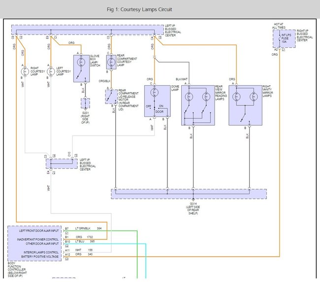

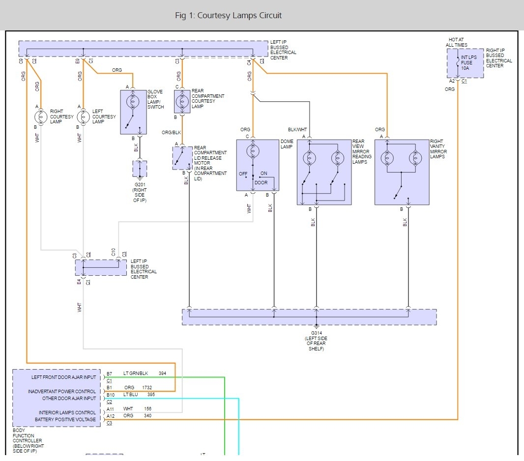

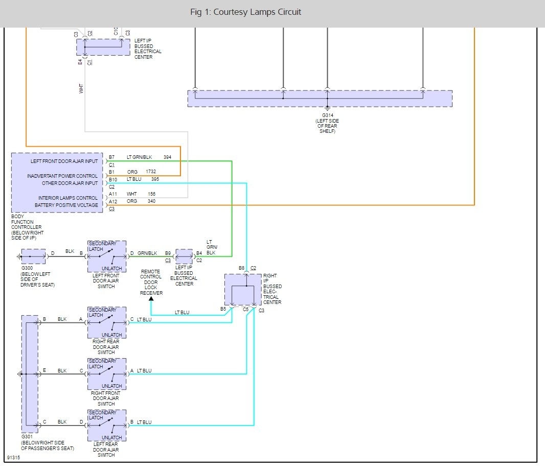

the dash and door lights are not working, but they will randomly come on once in a blue moon, but will go back off after a minute or two. Also, when I turn the headlights on the radio display light goes out.
Feb 19, 2017 at 11:04 AM
  • 55,423 POSTS
Hey COLBY,
It sounds like the BCM module is bad or you have a bad ground here is a wiring diagram and a guide so you can do some testing.
Please run some tests and get back to us so we can continue helping you.
