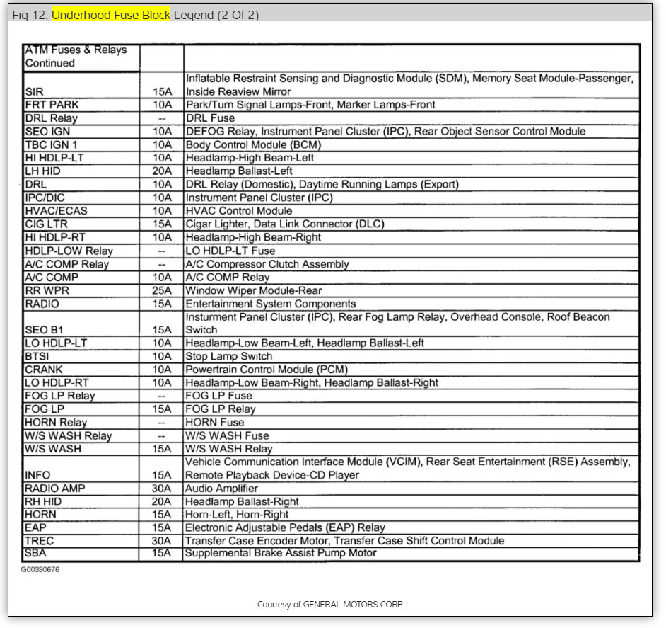

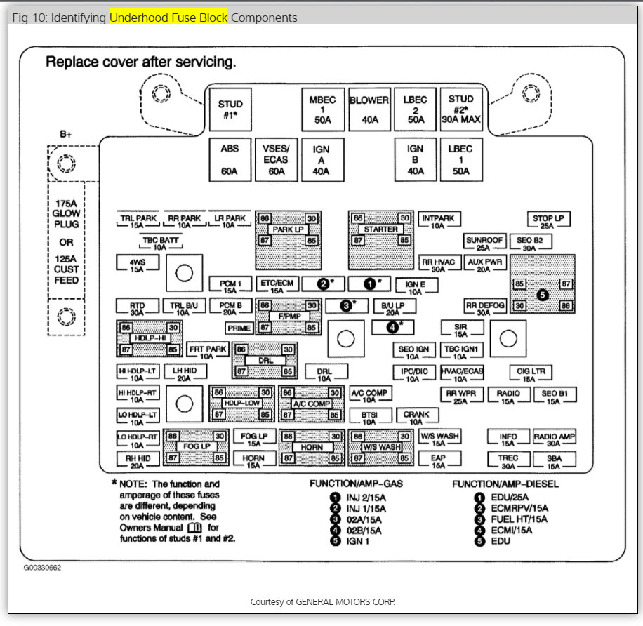

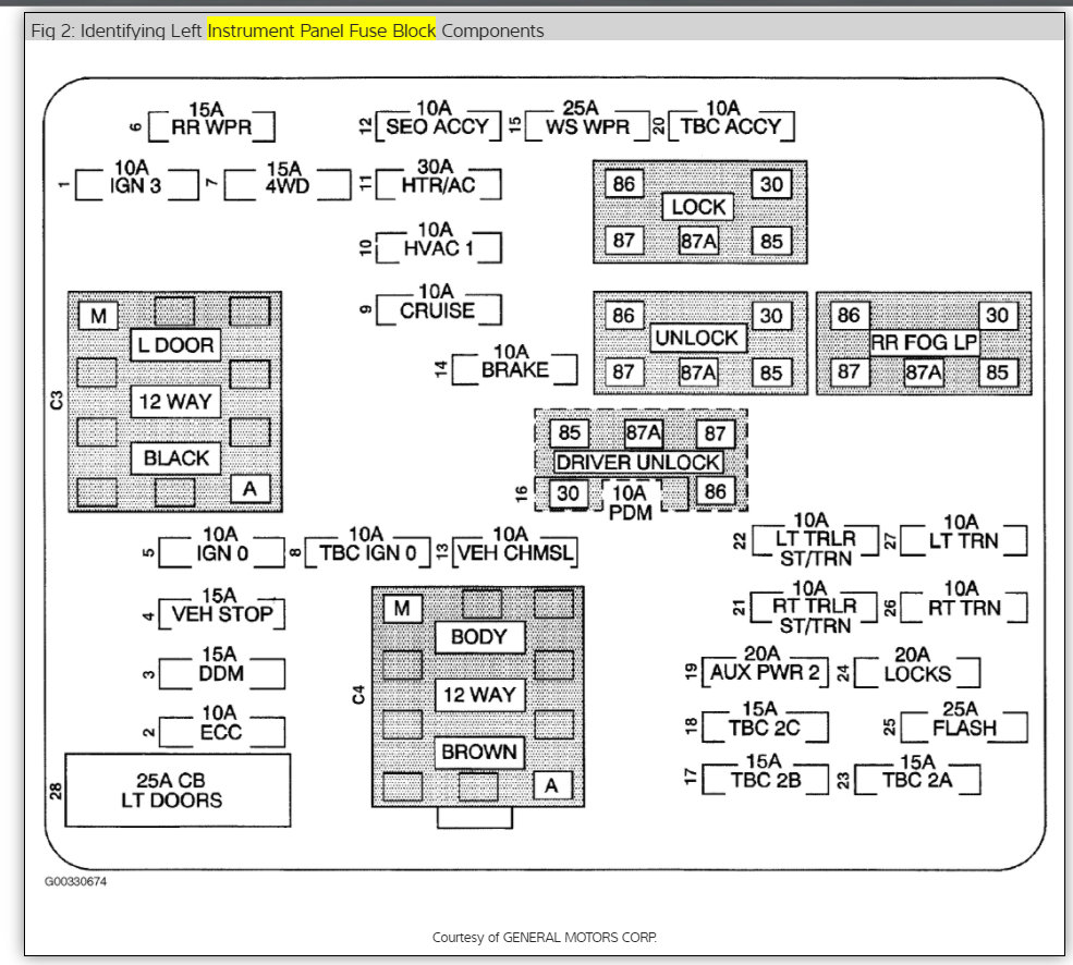

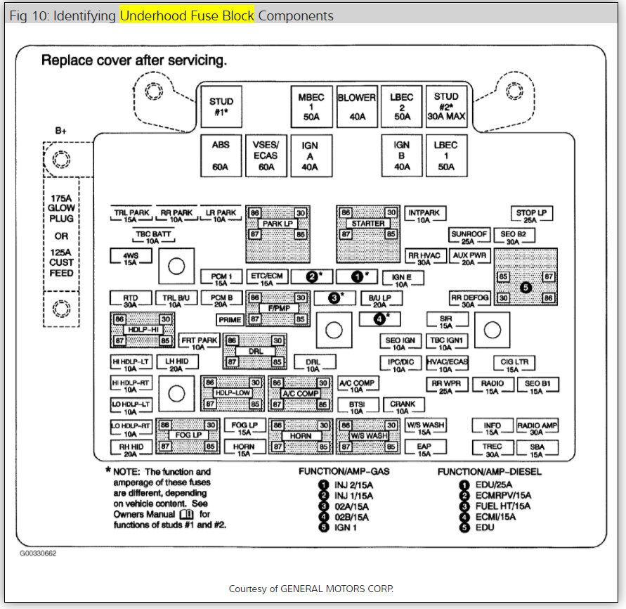

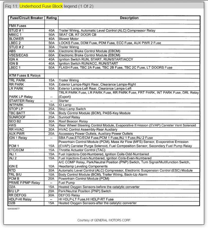

Fuse 48 in the under hood fuse box feeds the instrument cluster.
The data link connector receives power from the cigarette lighter fuse.
What you're experiencing was a common issue on these trucks where the data bus communication signal is lost between the IPC (instrument cluster) and other modules. Most often the cluster requires replacement. There are some rebuilding services on eBay for this.
Dec 20, 2020 at 7:57 AM
  • 55,721 POSTS
Here is how you can check the fuse and the fuse location. If the fuse is good chances are the cluster has gone out here is a video showing you how to change it out:

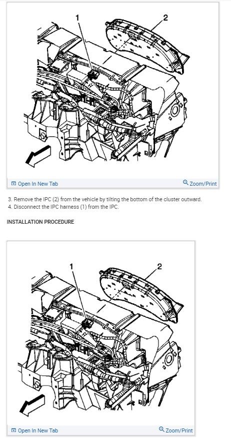

This is common when the instrument cluster goes out which is common by first lets check the fuses by using this guide.
If the fuses are okay I would replace the cluster which is easy. Here is a video to show you how.

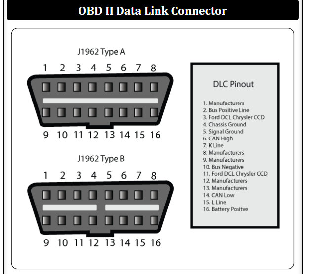

Good afternoon.
With the little information you have given me, it is hard to say. The fact that you cannot communicate with the ECM tells me you either have an issue with the serial data line or the ECM itself.
I would address this issue first as it may be the source of your issue. You need to unplug one module at a time and watch to see if you can communicate with any module. Time-consuming procedure but must be done before you can point a finger anywhere as to the failure. Is the check engine light on?
I do not like to guess and I know you have had a lot of recommendations but you need to start with basics to find the issue.
Check pin 16 in your connector under the dash for power.

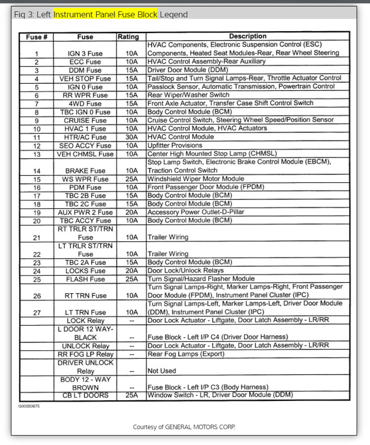

DOCFIXIT
  • 18,828 POSTS

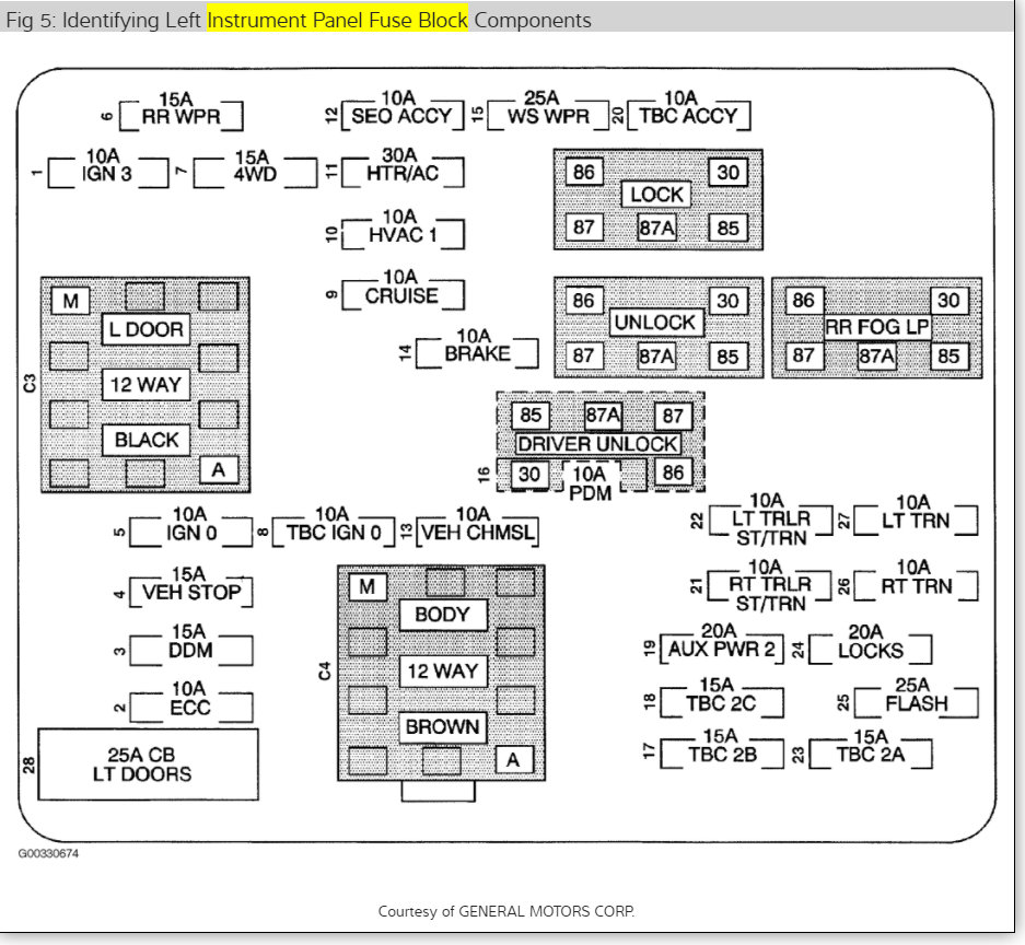

Underhood fuse box check fuse IGN E and IPC/DIC here is a guide with the fuse location in the diagrams below.
Check out the diagrams (Below). Please let us know what you find. We are interested to see what it is.

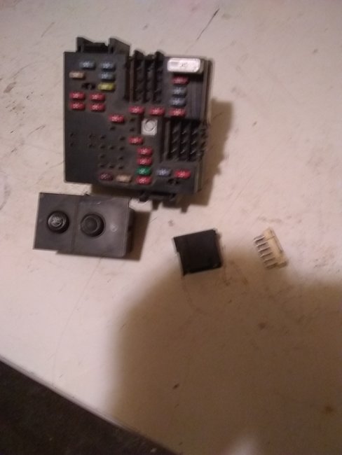

327W2ND
I have power and orange wire going to the doors but the windows locks in mirrors and cluster gauges do not work. I got separated from my wife last winter and I really don't know what happened with the truck since I've been gone. I don't know if somebody harvested some parts or what. but I found a connector driver side behind the light switch above the transfer case shift module that has been plugged into something but there's nothing in it now and no place to plug it in. I think a splicer pack belongs in it or a busbar whatever you like to call it. jumping bar but I'm really not sure it's a 12 pin connector female and it has 10 pins in it. I will send you a picture the top of the connection is labeled f which is like a light brown e which is white d which is purple c which is blue. I'm not sure what the last two letters are what the next color is dark green then in the end one I believe it's purple orange and pink. there's two wires going in it and then on the bottom. I think the letters are j which is gray then h which is blue with a white stripe. the next two terminals are empty and then there's l which is brown and then m which is lime green. I appreciate you reading this hope you can make some sense of it. thank you
Jun 2, 2021 at 5:40 AM (Merged)

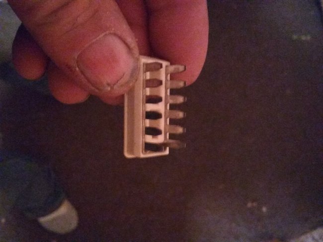

327W2ND
Thank you for letting me post on your site to 2CarPros. This morning I decided to go to a salvage yard that had 2004 Chevrolet Silverado. I told him what I was in search of and asked him if I could go dissect one of the trucks and I was correct somebody had taken the splice pack out of the connector in my truck. so it harvested the one at the salvage yard and I scored a couple extra parts to for $42.00 I'm relieved. thank you guys I'm just in hopes when I put it in all is good.
  • 55,721 POSTS
That is a good one, it looks like it might be heated on one side of the connector? Please let us know if that fixes it.

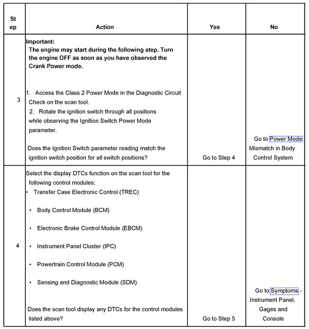

  • 110,248 POSTS

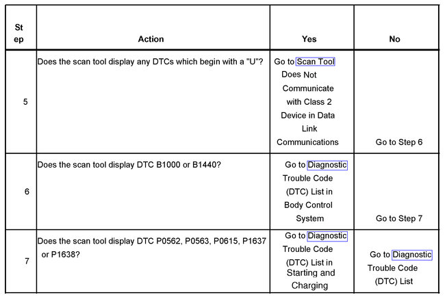

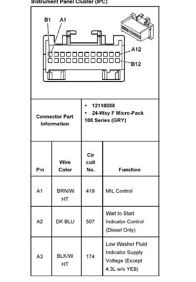

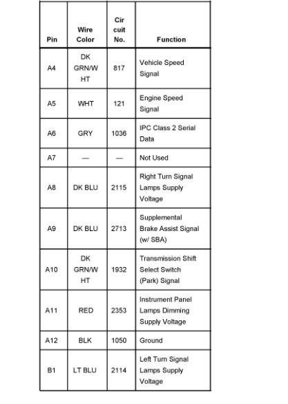

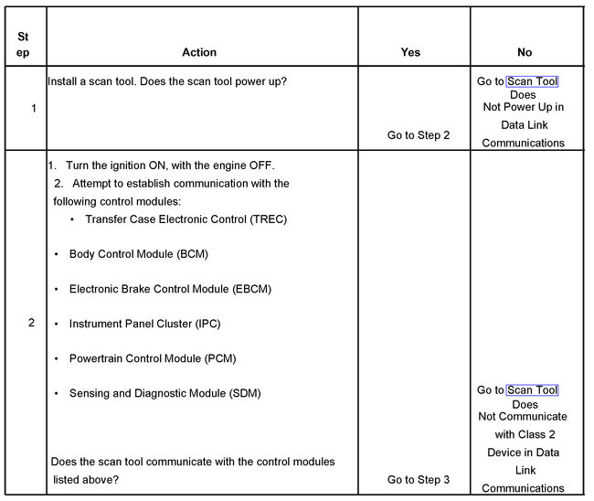

A lot of the instrument clusters failed and needed to be replaced. With that being said, you need to run a diagnostic check on the one in the vehicle to determine if it is bad. Based on your description, I believe the internal circuitry has shorted causing the high beam light to get power all the time but not nothing else is getting power.
To test the cluster requires a scanner. I don't know if you have one, but if you look through the three pictures I attached, you will find they are the instrument cluster diagnostic flow chart. I am attaching them for you in case you have a scanner or have access to one. Also, the following correlates with the test.
The numbers below refer to the step numbers on the diagnostic table.
2. Lack of communication may be due to a partial malfunction of the class 2 serial data circuit or due to a total malfunction of the class 2 serial data circuit.
The specified procedure will determine the particular condition.
4. The symptom list in Symptoms will determine the correct diagnostic procedure to use.
5. The presence of DTCs which begin with "U" indicate some other module is not communicating. The specified procedure will compile all the available information before tests are performed.
If you are able to perform the test, let me know the results so I can further advise you.
Let me know if you have other questions,.

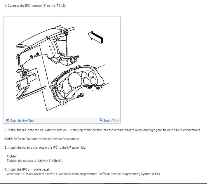

  • 110,248 POSTS

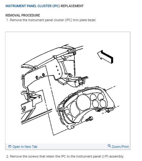

The instrument clusters in these trucks had alot of issues, you may need to replace it. You should be able to do it at home if you have a small amount of mechanical ability
See the attachments below for instructions on how to change the gauge cluster.

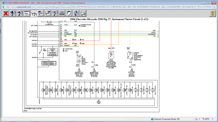

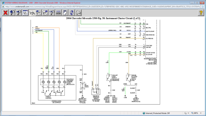

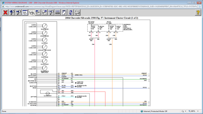

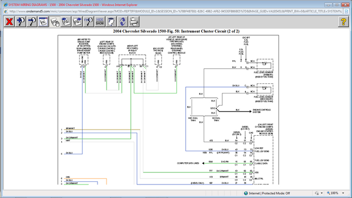

RIVERMIKERAT
  • 6,106 POSTS

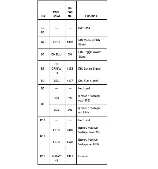

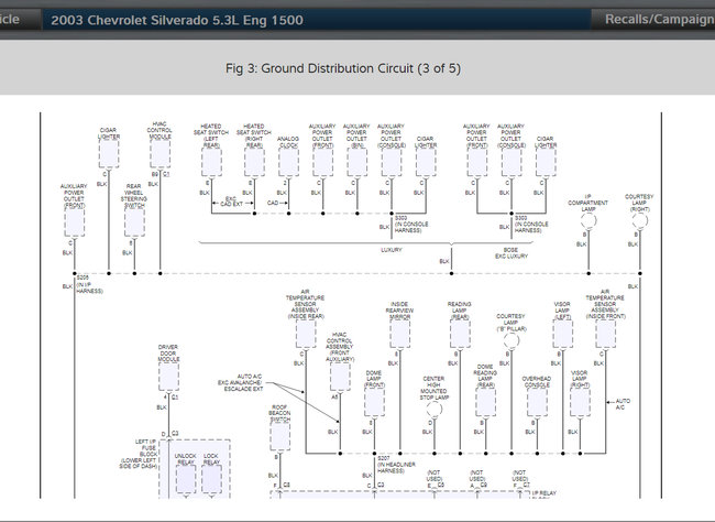

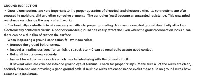

Check the wiring and fuses. Pay special attention to instrument panel grounds. I have attached the schematic for the instrument panel. Each page is in 2 parts for clarity.

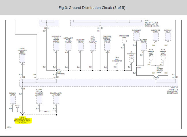

ULUMPY2
  • 5 POSTS
Went golfing one day, came back out to go home. Turned truck on and gauges, power windows/locks, some lights, blower motor and climate control. Every thing worked awesome. Until that day. It was super hot inside of the cab. I've been trying to get this fixed no for a few months now. Could use some insight.

SCGRANTURISMO
  • 4,897 POSTS

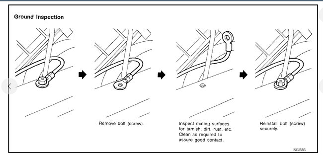

This could be a problem with ground #200 which is located behind the right side of the dash near the "A" pillar. Today's modern vehicles have a lot of electronics and electrical systems on them. People tend to focus on the power side of circuits but forget that it is only 1/2 of the circuit. The ground side of the circuit is the other half. In fact 75% of all vehicle electrical problems are poor or bad grounds. Because of the many electrical circuits in today's vehicles, they will share a common ground, so if the ground goes bad, it will effect many systems. In the diagrams down below I have included a ground distribution wiring diagram for your vehicle as well as ground location and how to inspect a ground for your vehicle. Please go through these guides and get back to us with what you are able to find out.

ULUMPY2
  • 5 POSTS
Sorry it took me so long to get back, I was very busy with other people's cars. Yes, this was helpful. The gauges was just a matter of getting a new cluster. The HVAC controls is a matter of finding power from the main fuse box in the engine compartment. The door locks is still a mystery. It has power running to the switches but no ground anywhere in the door. If I supply a external ground, the power will work. The switch has been tested, but once it gets ground and positive running to it, the switch goes dead. Still a mystery.

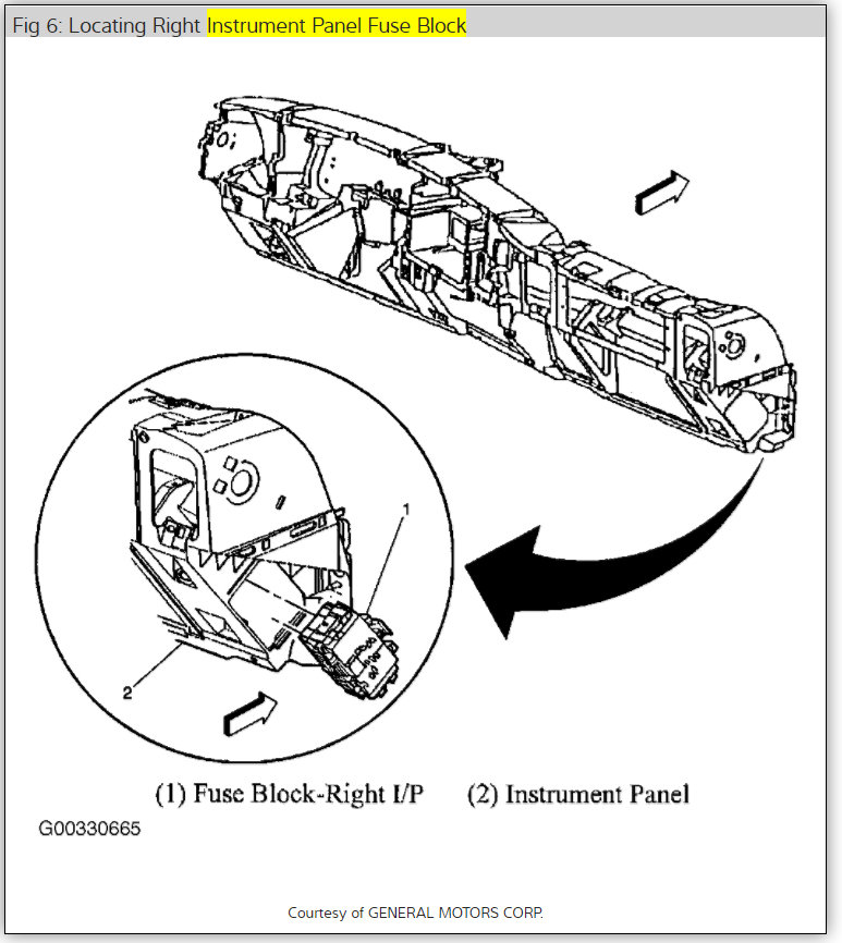

I've been looking at the wiring diagrams on your truck and I find the main power wire but it may be in the fuse box at the end of the dash on the driver side, opened up the drivers door and remove the end cap from the dash and check your fuses. THis guide can help

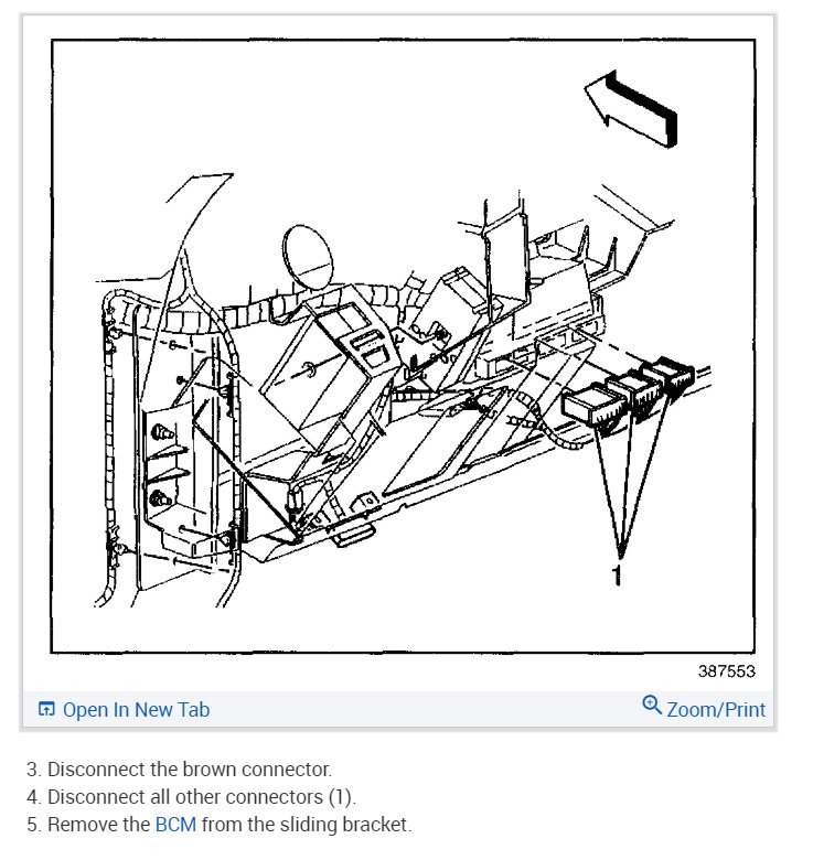

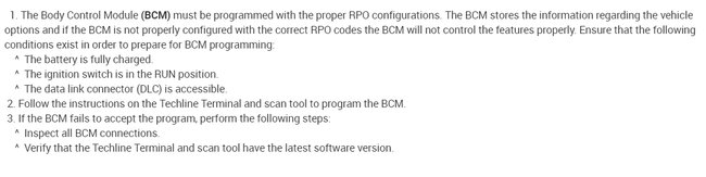

RCFNICK
thank you. I have been wiring race cars ,street rods, and classics for 40 years, but I can't fix my own pickup. when I turn off the key and the instruments power down, pull the key out and wait 30-40 seconds and the gas and temperature gauge power up again without key on. to power down again do these steps, each one will work for 30-40 seconds and it will power up again. open the door flash high beams put key in ignition-don't have to turn it on when it powers up again. do the same things or pull key out, if you leave the door open nothing happens until the interior light goes off then the gauges power up again. I pulled the cluster and checked all the solder connections and they look really nice. I also put in a new ignition switch and harness, no change. I don't expect free advice I need help. thank you, Larry
Jun 2, 2021 at 5:41 AM (Merged)

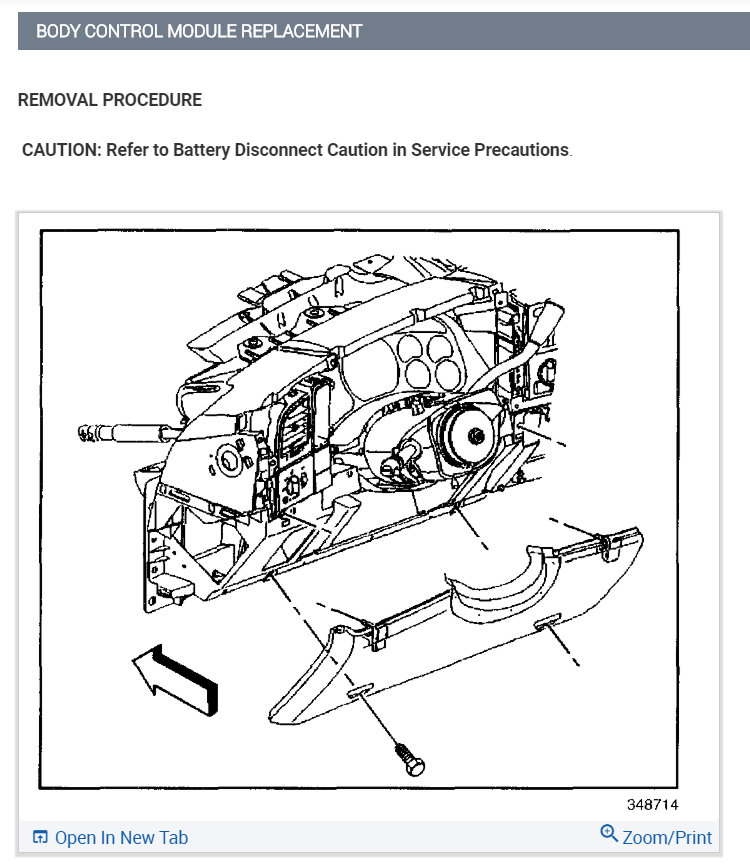

  • 55,721 POSTS
It sounds like the BCM is out. To be sure here is a video doing a CAN scan which is the future of car repair you can get one for about $50.00 on Amazon:
https://youtu.be/InIlnsjOVFA
Here is how to replace the BCM in the diagrams below in case you need it. Check out the diagrams (below). Please let us know what you find. We are interested to see what it is.
