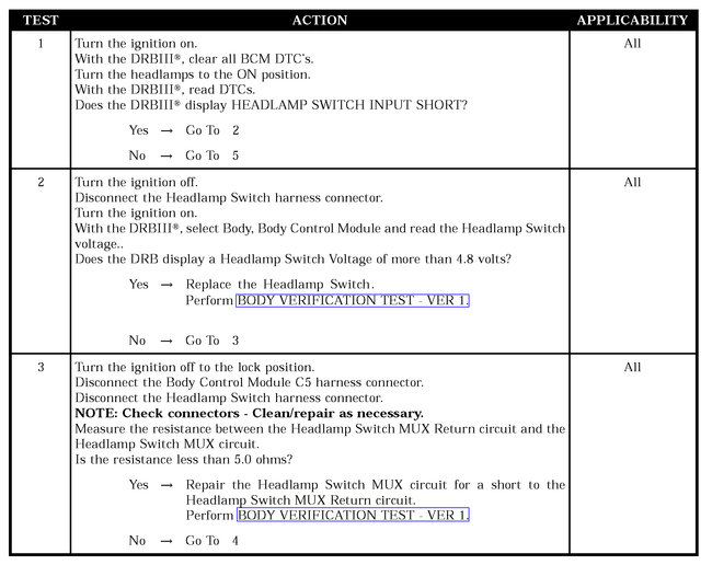

When i turn on headlights i have no low beam, but i have high beam. My dash lights go dim when i turn on my on my headlights, when i turn the headlights off the dash lights are normal brightness.Is the problem in the wiring or my light switch?
Feb 26, 2021 at 5:54 PM
  • 110,241 POSTS
Chances are the switch is bad. However, it could be related to the body control module. Do me a favor. Take a look through these diagnostics and let me know if it is something you feel comfortable doing.
____________________________________________
2006 Chrysler Pacifica V6-3.5L VIN 4
Headlamp Switch Input Shorted-BCM
Vehicle ALL Diagnostic Trouble Codes ( DTC ) Testing and Inspection Manufacturer Code Charts Lighting Headlamp Switch Input Shorted-BCM
HEADLAMP SWITCH INPUT SHORTED-BCM
Test 1 - Test 3
see pic 1

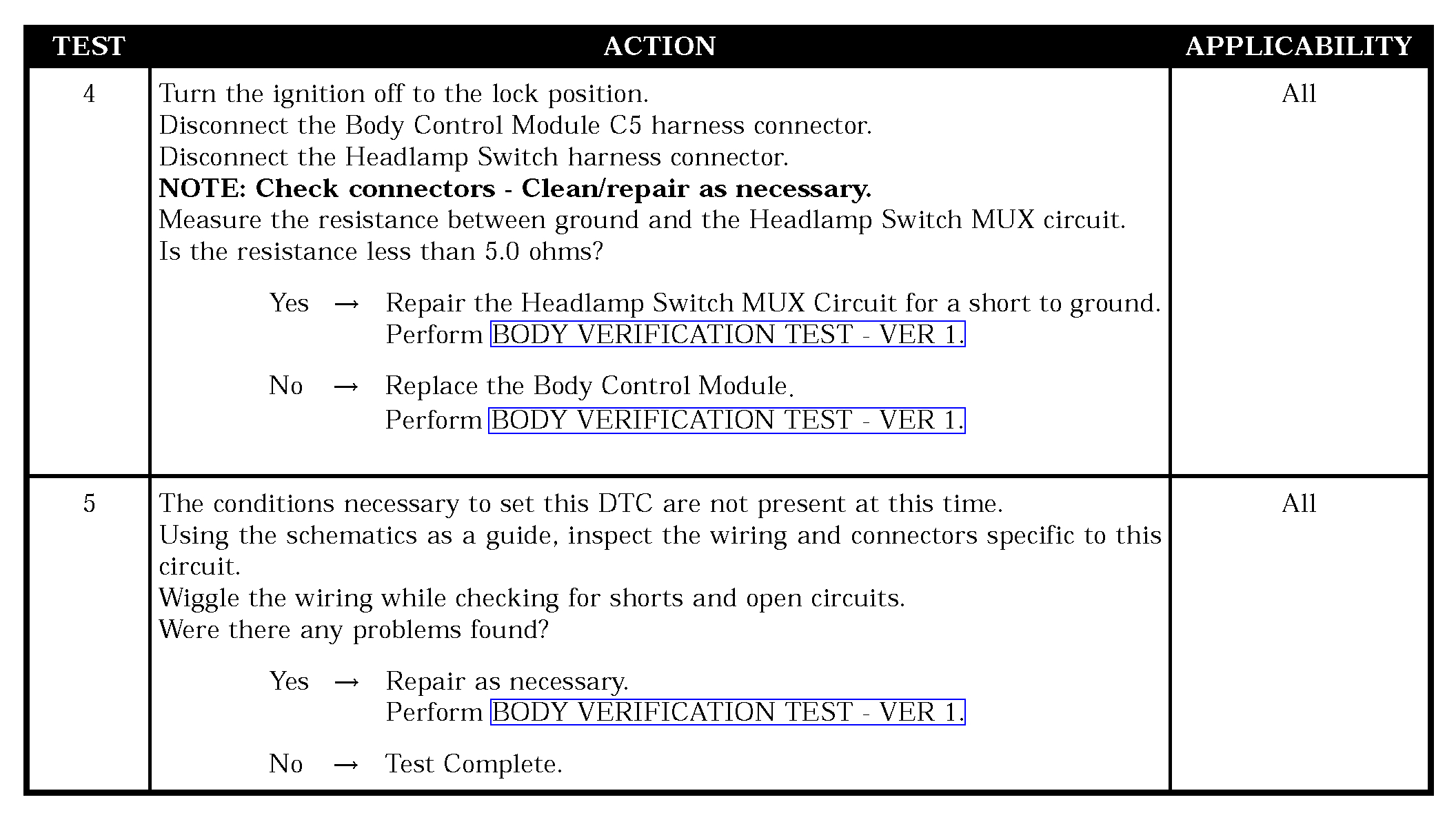

Test 4 - Test 5
see pic 2
SYMPTOM
HEADLAMP SWITCH INPUT SHORT-BCM
POSSIBLE CAUSES
- Headlamp switch shorted
- Headlamp switch MUX circuit short to MUX return circuit
- Headlamp switch MUX circuit short to ground
- Intermittent wiring and connectors
- Body control module
