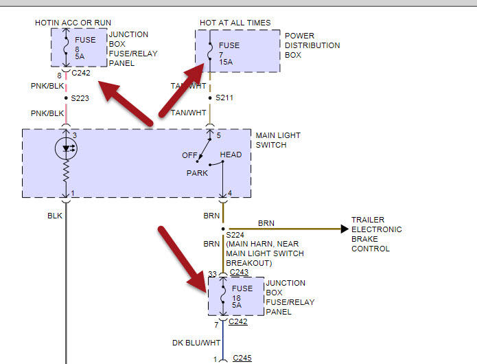

While I drive my dash lights come off and on unexpectedly while driving. I have checked battery terminals and they are tight. What could be other problems? Thanks.

check for poor connections and fuses that are shown. it may be a bad gem module or connection at junction block gem module behind center of dash.
