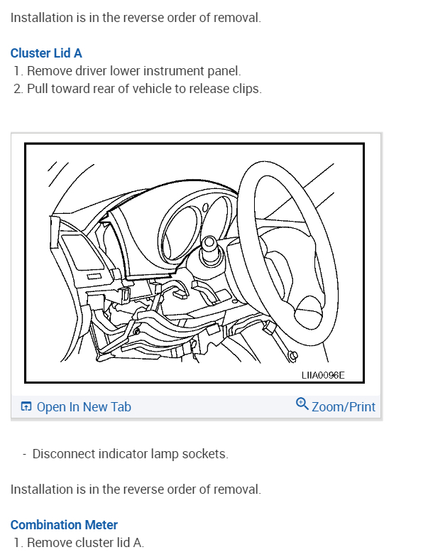

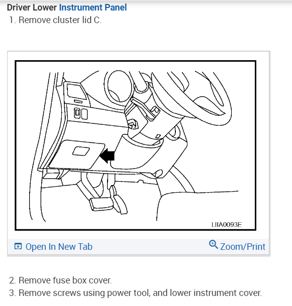

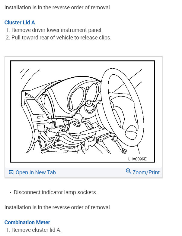

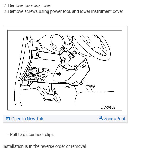

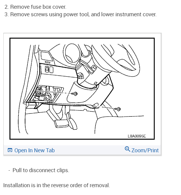

It sounds like the IPC might be bad, but I would check the fuses first and then run the codes to see if any are stored. Please go over these two guides:
and this is how to do a CAN scan. You can get a CAN scanner (Controller Area Network) which will work on most cars from Amazon.
https://youtu.be/u-4syLc-ifQ

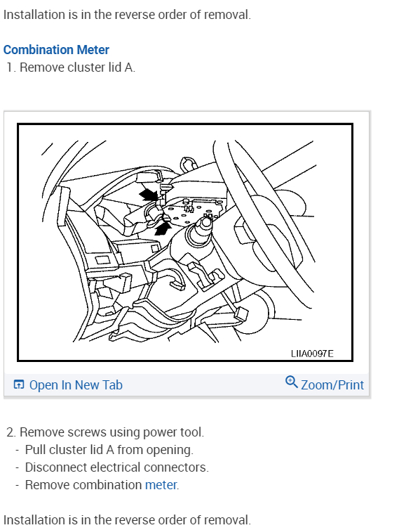

Here is how to change the cluster out, you can get a preprogrammed unit by searching Google or Ebay.
