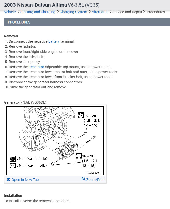

The battery light comes on when the battery does not get charged properly by the alternator. Typically, it points to a bad alternator or a wiring issue from the alternator to the battery.
When the battery light gets triggered, a good first step would be to test the alternator output to the battery. It should be 13.6V to 15.2V with the engine running.
Here is a helpful guide:
Nov 4, 2021 at 11:41 PM
