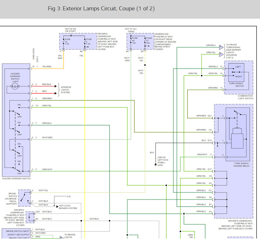

running light wiring diagrams?
170,000 MILES • 2.3L • 4 CYL • 2WD • AUTOMATIC
LUIS BATRES
I already checked all the fuses. my driver and passenger fuse and the fuses under the hood they are all good. I do not know to much about this. can anyone help?
Apr 3, 2018 at 11:28 AM
  • 55,684 POSTS

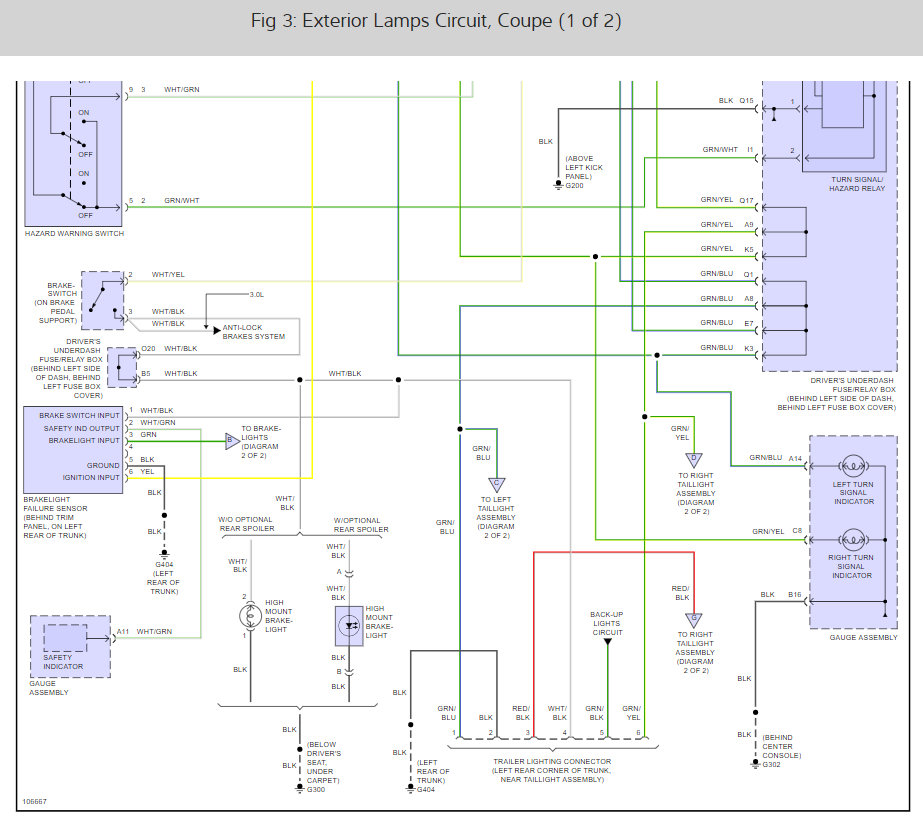

It sounds like the headlight switch has gone out, but to be sure lets run this test by following this guide.
See if power is coming out of the switch, check out the wiring diagrams below showing you which wires to test.
