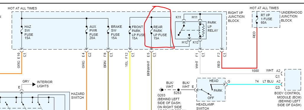

Hi, I have the car listed above LS model. My rear parking lights are not on at night and dash lights don't work at night. also don't know what is going on. need help fixing the problem.

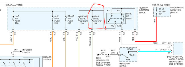

Are any of the rear lights working? Also, have you checked the bulbs as well as fuses? There is a fuse for the rear tail lights in right side instrument panel fuse box. See the attached pics. Lets start there. Check to make sure it is good.
Here are a few links you may find helpful:
Let me know what you find. Please keep in mind, this could be related to a bad headlight switch.
