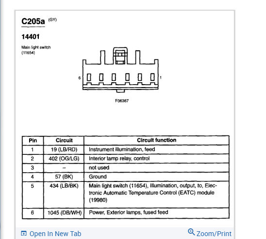

So whenever I turn my headlights on, my dash lights do not come on (but my high beams and all that still show it’s mainly just the gauges). and the lights for the radio don’t show up (except the time) and my steering wheel lights, 4x4 lights switch and
head light switch don’t light up. any help would he appreciated.

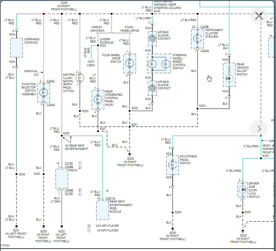

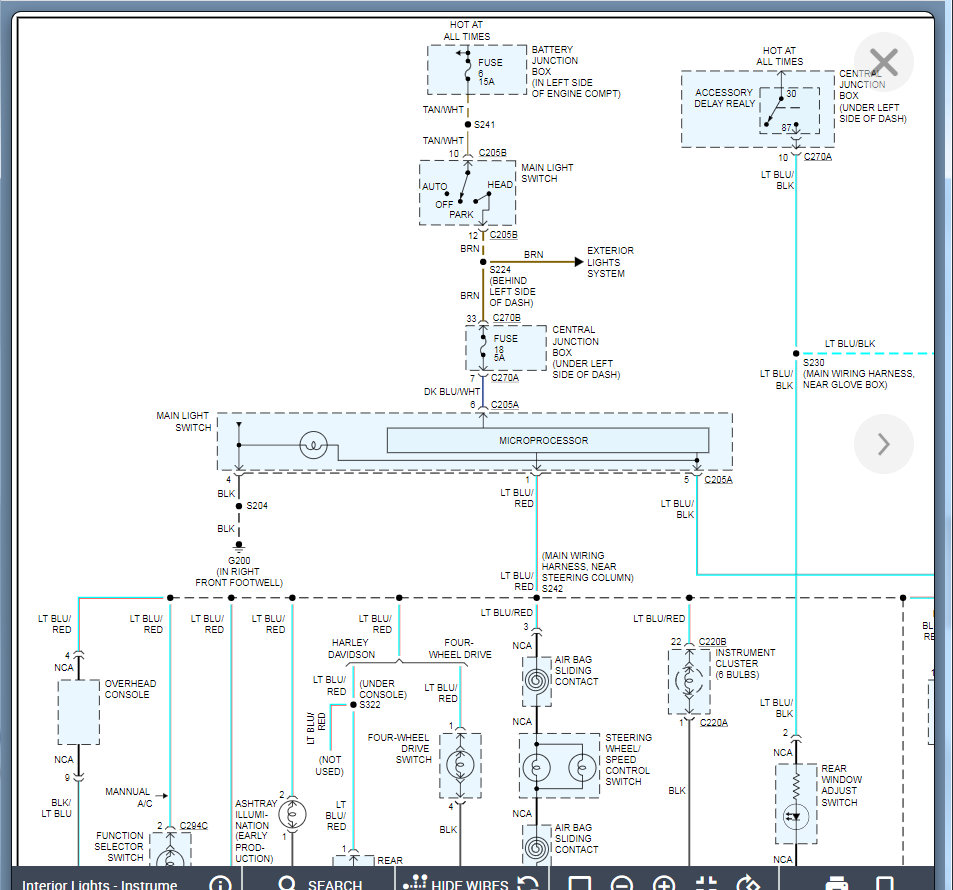

I suspect this is the main light switch as the issue because it has a microprocessor in it that controls the back lighting circuit which is what these lights are part of. I attached the wiring diagrams for us to start testing for voltage to trace it back to the switch. If we have no voltage coming out on the light blue/red wire then we should go ahead and replace the switch.
Let me know what you find and we can go from there. Thanks

Also, I should note that my headlights still do work, and before this all happened, my dash lights would flicker for a few minutes.
Aug 3, 2020 at 2:20 AM
Okay. This microprocessor could still be the issue due to the fact that the circuits coming out of it are different. So the headlights circuits are unaffected and the flicker is an indication of a connection issue.
Clearly this could be another issue but this would make the most sense. Let me know if you have other questions. Thanks

I would start with going to one of the lights that is not working. Remove the connector and you should see an light blue and red wire. When the light should be on, you should have voltage on that wire. If not, jump up to the switch and find the light blue and red wire and check for voltage with the lights on the same way. If you don't have it coming out of the switch then the switch is the issue.
I am telling you to go to one of the lights first because they would be easier to remove then the switch so if you have power on that circuit then the switch is not the issue. However, I doubt that because I don't see anything else in common with all these.

Sorry this is so late. It was the headlight switch. Thank you.
