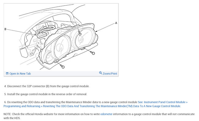

I'm just wondering how to go about changing the light bulbs behind my cluster (like the speedometer etc.) i bought lights that said they'd fit my car but can't find light bulbs in it anywhere. Also, don't know where they are for the heated seat buttons either.
Jun 5, 2022 at 8:22 AM
  • 55,711 POSTS

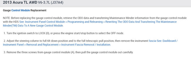

The bulb should be accessible from the rear of the cluster. here is how you can remove the cluster and get to the bulbs, if you have any trouble, please let me know. Check out the diagrams (below). Let us know what happens and please upload pictures or videos of the problem.
