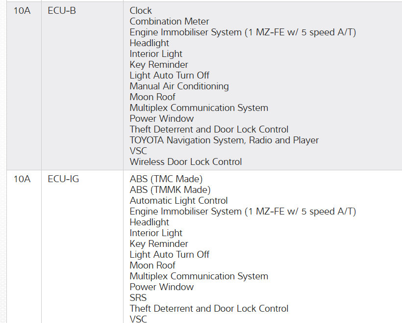

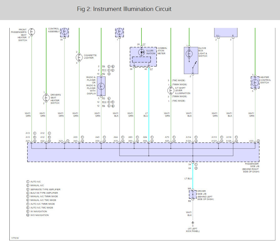

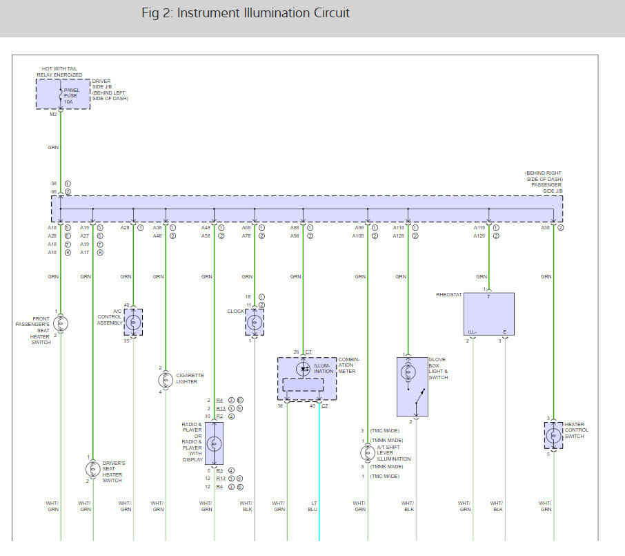

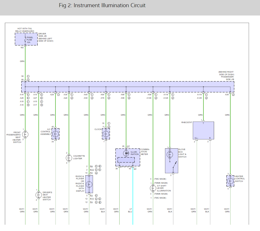

All indicator lights are working but the dash light is out.
Sep 21, 2018 at 5:22 AM
  • 55,746 POSTS

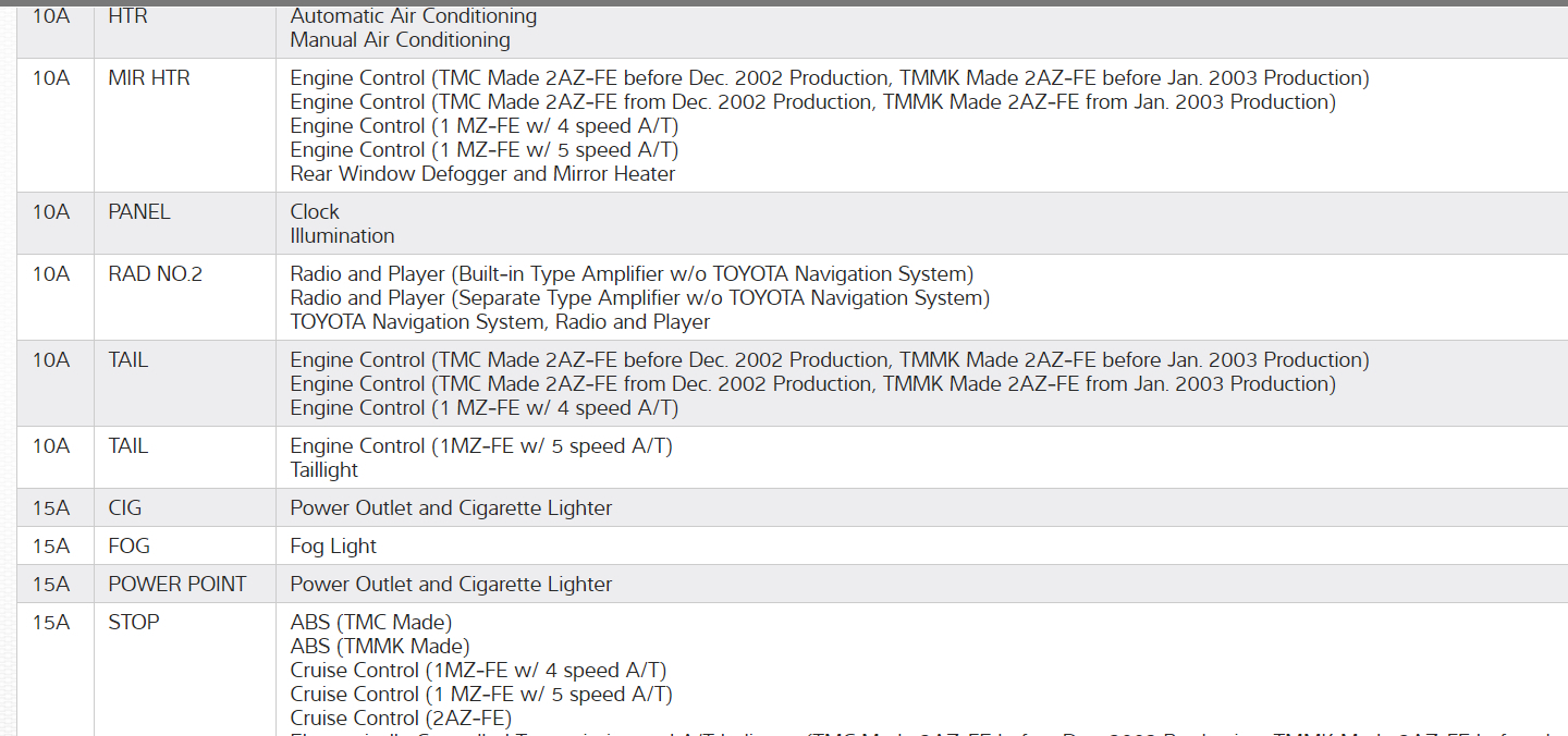

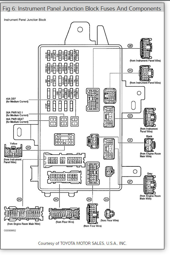

There is a panel fuse that needs to be checked because it powers the instrument cluster lighting. Here is a guide to help you and the fuse location with the wiring diagrams for the cluster lights so you can see how the system works:
