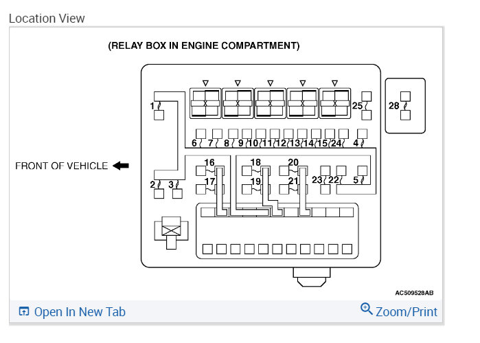

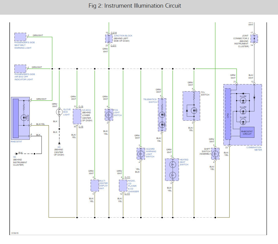

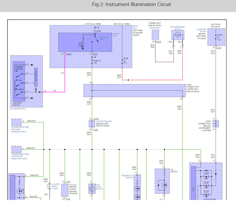

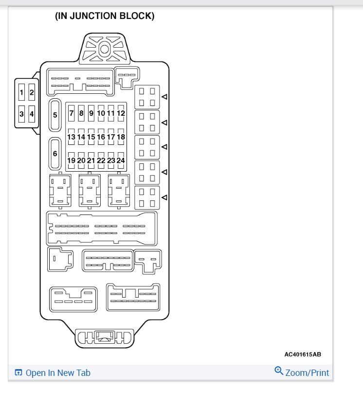

It does sound like the rheostat is bad be to be sure let's check the fuse #20 and #22 in the fuse panel under the hood and fuse #23 in the fuse panel on the left side of the dash. Here is a guide to help with the fuse locations in the images below and I have included the dash illumination wiring diagrams so you can see how the system works.
please go over these and get back to me.
