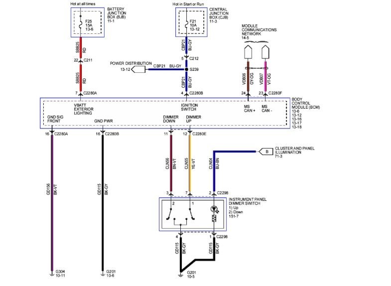

After a body shop replaced the upper crash pad and passenger airbag module I have a draw that is draining the battery. The steering wheel, HVAC cluster, and shift panel lights stay on after the vehicle is locked with the remote but all other dash and exterior lights go out. These lights stay on at least forty five minutes to an hour before I notice they turn off. I have another Fiesta that all interior lights come on when opening the door but shut off after thirty seconds or so, or immediately if I lock with the remote. I assume this is the way it is supposed to react. The body shop has been no help. No other lights or codes. Help

The body control module controls the timing of the lights remaining on time. The module may have been damaged in the accident.
Do you have an advanced scan tool to monitor the body control module inputs and outputs?

Snap on modis edge with latest update. Can check tomorrow to see what pids I can access.
