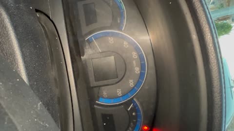

Hi , i noticed this problem yesterday , and i noticed that dome light at door open mode is not turn off even if i shuts down car and lock it , the bulb i used is led one and i used it for years and last time iv replaced it was 5 months ago , but i dont know the cause of this flickering that started yesterday ?? The flickers continue for 30 sec (and continue even i turn off car ) and returns every time i open and close door .
I noticed that the problem resolve when i remove the led bulb , and i replace bulb with new led but problem returned . Can u please till me what to do ? , does halogen light should be used despite the led bulb has no problems for years , or is it the switch itself that change light mode ( on, of, door open ) or other major problem at BCM
The car door sensors are ok as car dash show when open any of them .
I did decrease light degree at dash area , i thought this will make dome turn off but not work . Can u help please

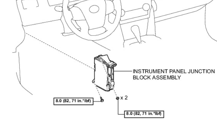

Yes, I would remove the LED and replace it with the stock OEM bulb first. Then, if that does not fix it I would do a CAN scan to see if any codes are stored, chances are the main body ECU (BCM) is bad but you can try doing a hard system reboot as well I have seen this fix the problem as well. Please go over this video.
https://www.youtube.com/watch?v=INiDRO5A5MY
here is how to do the can scan
CAN SCAN - https://youtu.be/u-4syLc-ifQ
You may have corrosion on the electrical connector @ the BCM as well, I have seen that cause the issue as well FYI, disconnect the 12 volt battery first. Here is the location of the main body ECU. Check out the images (below). Please upload an image or a short video in your response.

Hi sir , thanx for reply , i did install halogen oem light and problem resolved , but ihave two questions .
First why led become not tolerated by car despite iam using them for more than 10 years with out problem ?
Second : i want white color bulb and halogen is yellow , is there way to reuse led again or other alternatives with white color bulb ?
