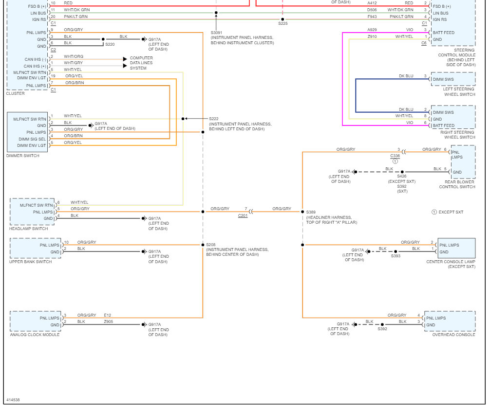

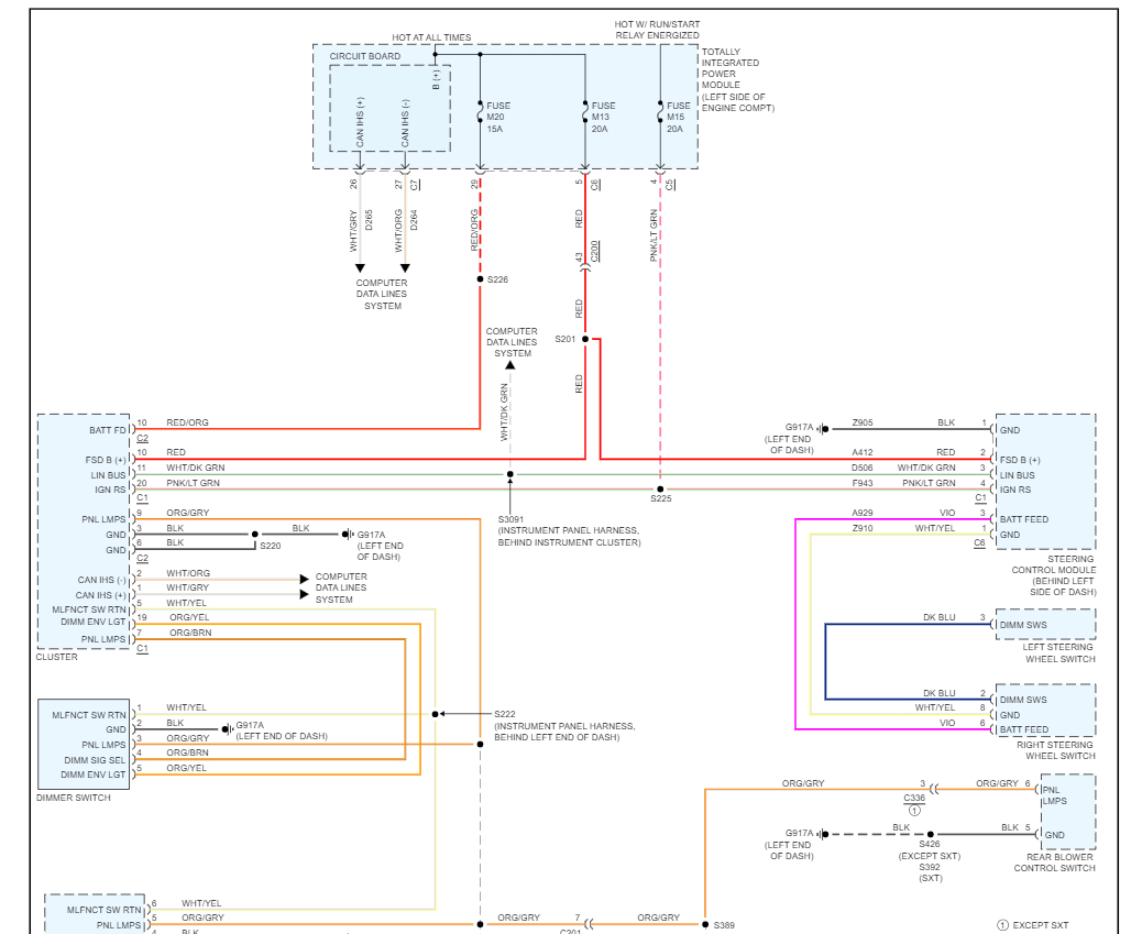

The dash lights and gauges go out but sometimes come back on. I replaced instrument cluster and TIPM, do you have any idea what could be going on?
May 4, 2023 at 9:45 AM
  • 55,845 POSTS

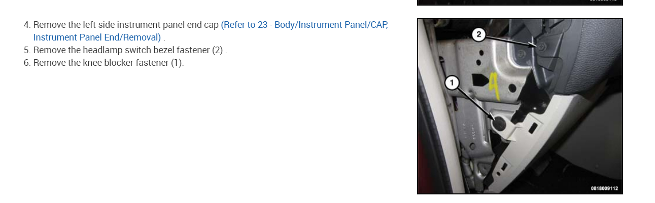

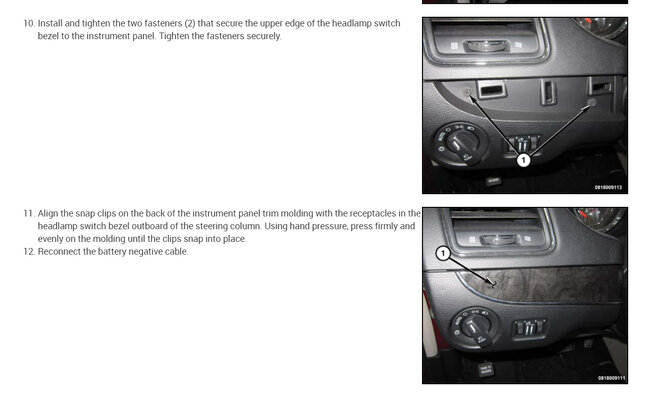

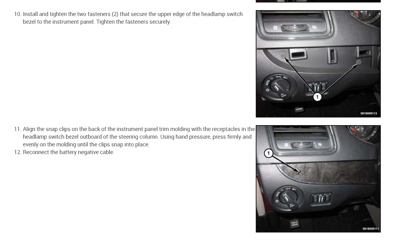

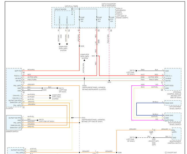

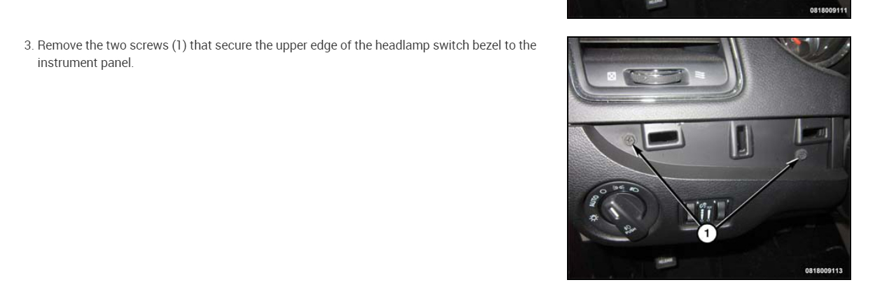

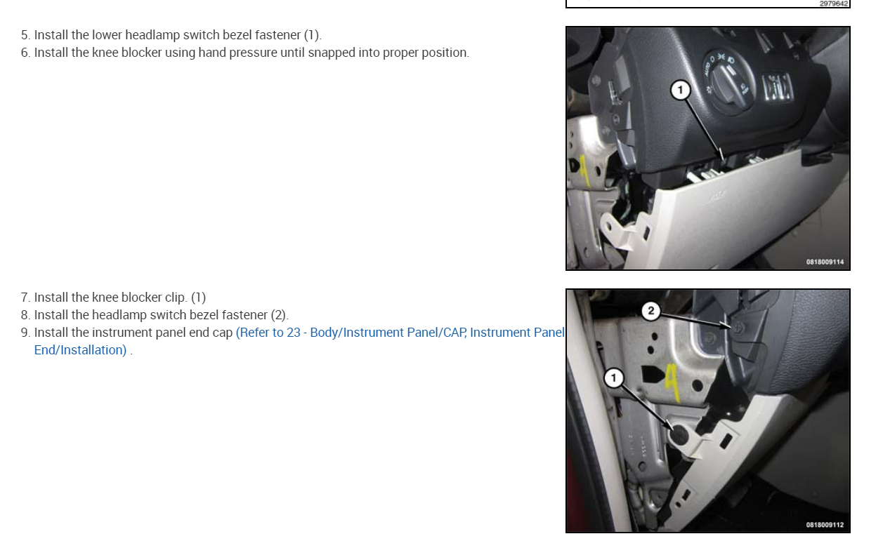

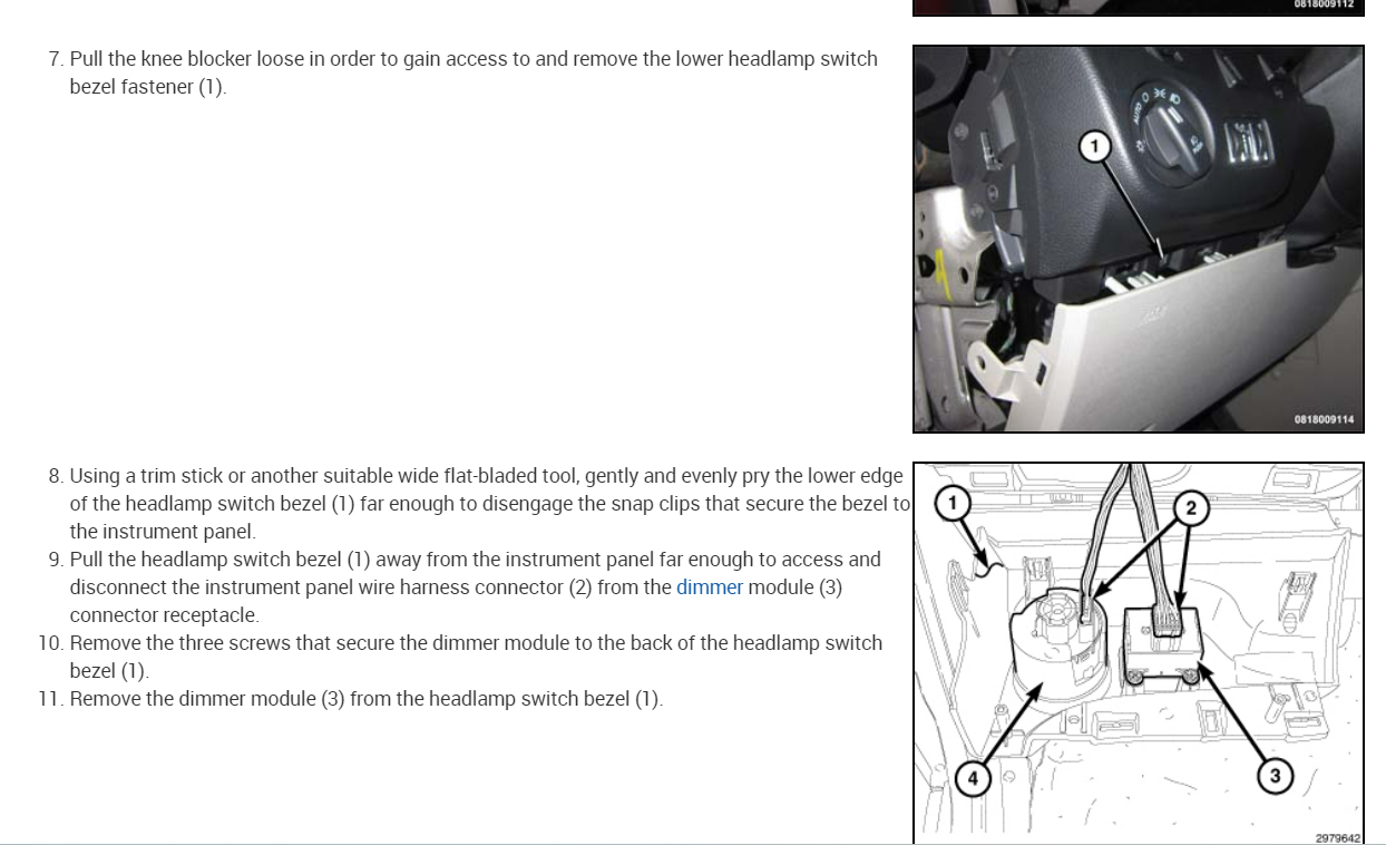

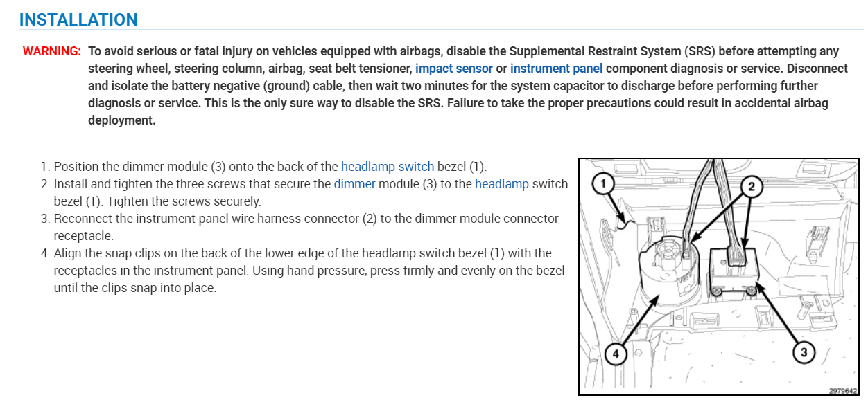

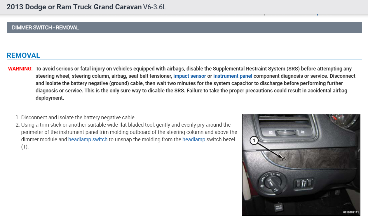

This sounds like the dimmer switch is going out here is the instrument cluster lighting wiring diagrams so you can see how the system works and I have included how to change the dimmer switch out as well. Check out the images (below). Please let us know what happens.

Is this diagram for a 2013 Dodge caravan? Also, I forgot to mention wipers come on gauges don't work, turn signals won't work, and dash doesn't light up. what could be happening?
May 5, 2023 at 11:39 AM
  • 55,845 POSTS

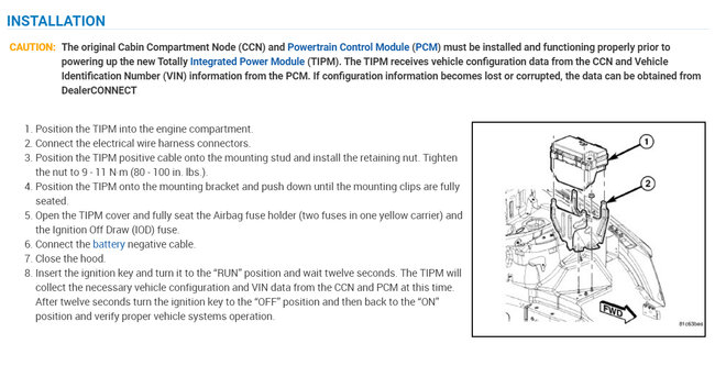

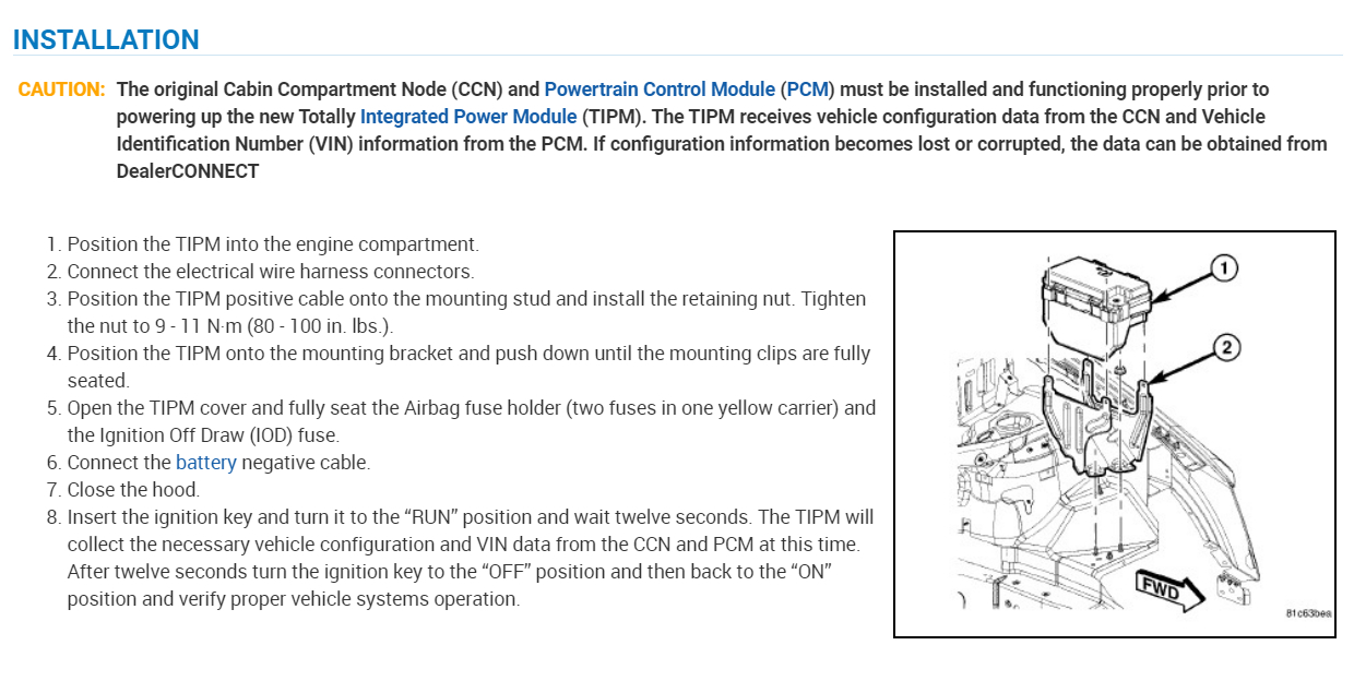

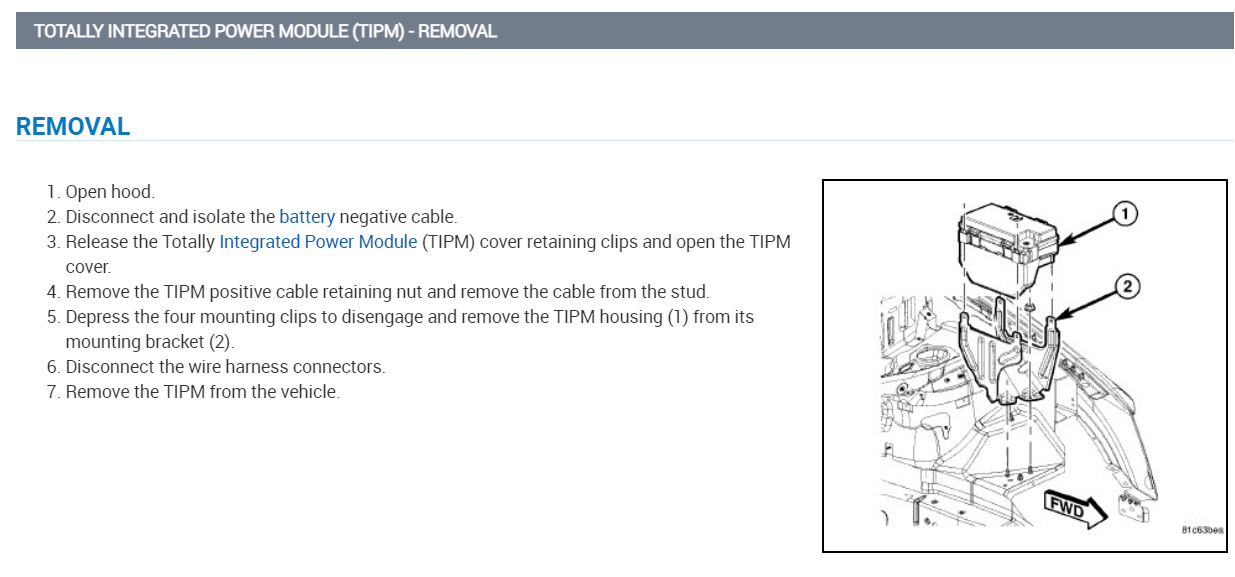

Yes, the diagrams are for a 2013 Dodge caravan. It sounds like you have a defective TIPM, but to be sure let's do a CAN scan. You can get a CAN scanner (Controller Area Network) which will work on most cars from Amazon.
https://youtu.be/u-4syLc-ifQ
and
Here is one for about $99.00 if you need it:
https://amzn.to/3ZixY4v
Here is how to replace the TIPM in case you need it. It is easy because it-self learns. Check out the images (below). Please let us know what happens.

we just had the TIPM fully restored.
May 6, 2023 at 9:24 AM
  • 55,845 POSTS
Does that mean? replaced? reprogrammed?
May 7, 2023 at 4:17 AM
DODGE PERSON
we sent it in to get fully refurbished.
May 7, 2023 at 4:19 AM
  • 55,845 POSTS
Okay, lets do a CAN scan to see what comes up, sometimes these rebuilders do no do a good job, the CAN scan will tell us if the TIPM is the problem.
