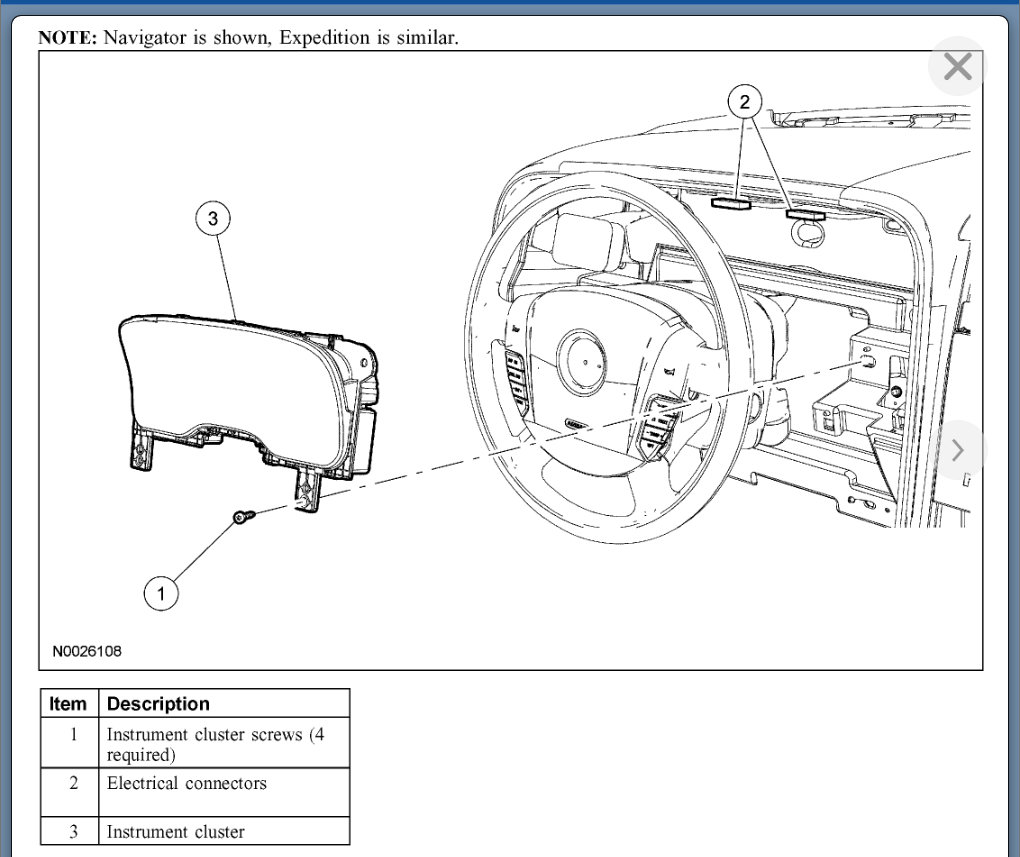

My dash lights work fine. But the information window in the middle goes out I can see a faint light of the letters. Sometimes if you hit the top of the dash it will come on and then go off again.
Jun 12, 2022 at 12:01 AM

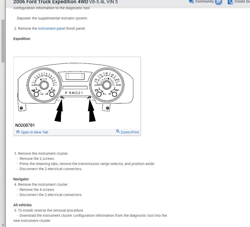

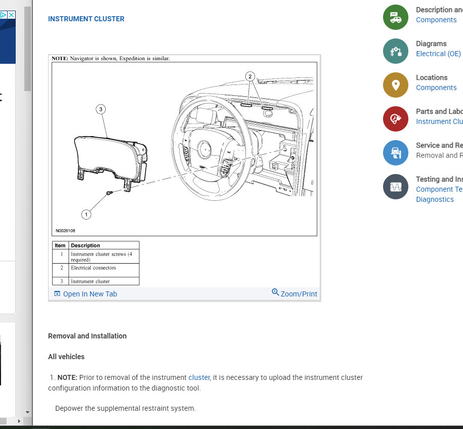

Unfortunately, it sounds like the cluster has an issue on the circuit board that is causing the dimming of the panel.
This is not uncommon when they fail so I would suggest we replace it.
However, if you can get a video or picture of what this is doing then that may help with confirming the issue.
Due to hitting the dash to get it to work is also a key indicator.
So, let's start with all this and we can go from there.
