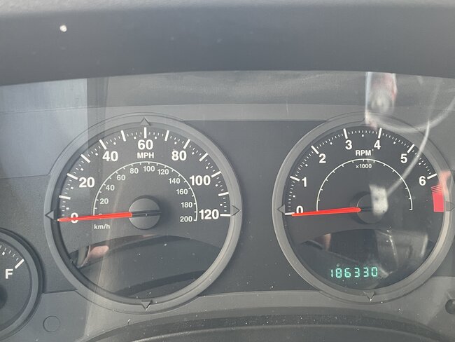

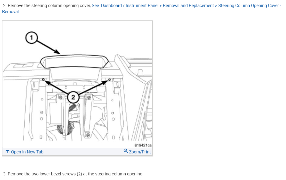

I have noticed the left side of my dash information center does not illuminate but I hear a beep or ding sound sometimes and I’m assuming it’s that side. Is it a fuse? Picture included for reference.
Nov 4, 2023 at 5:05 PM
  • 55,421 POSTS

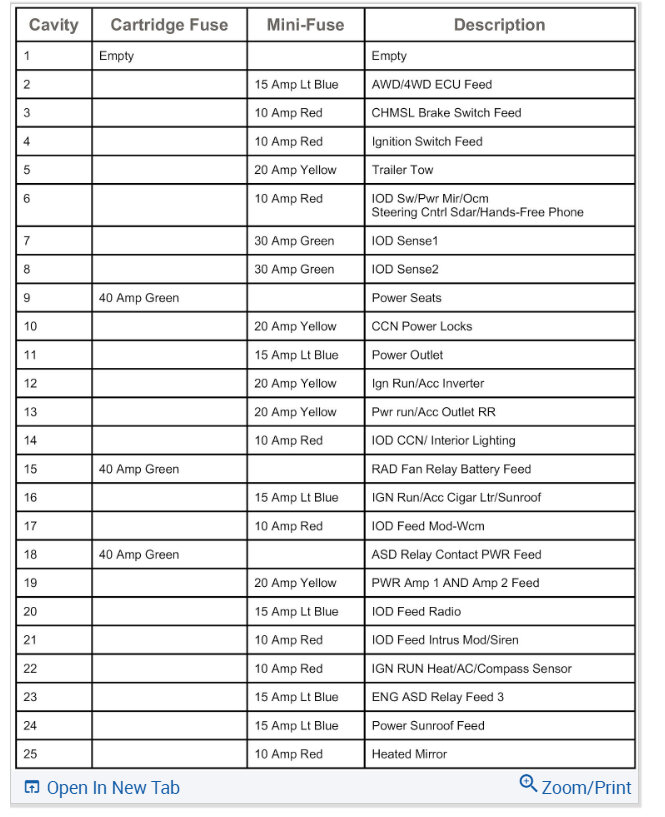

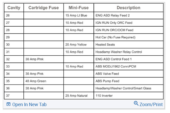

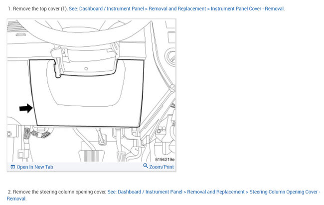

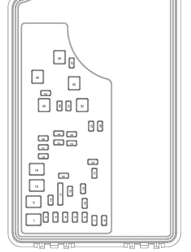

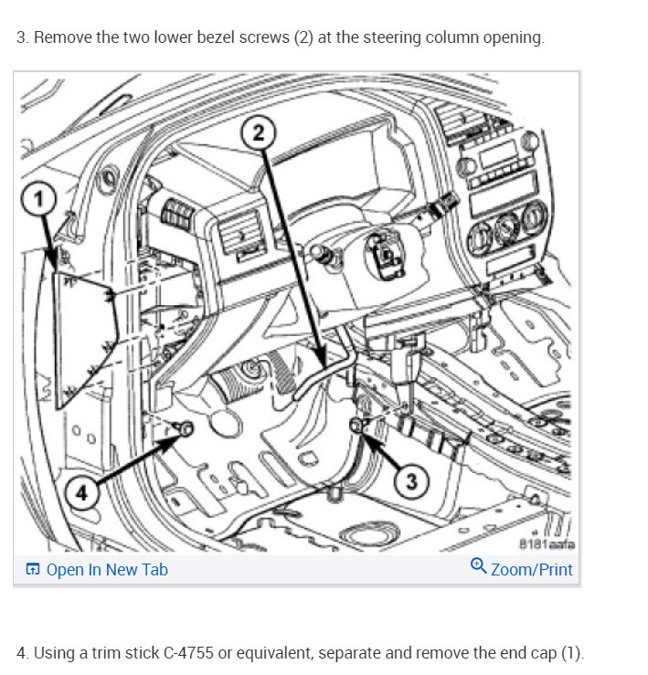

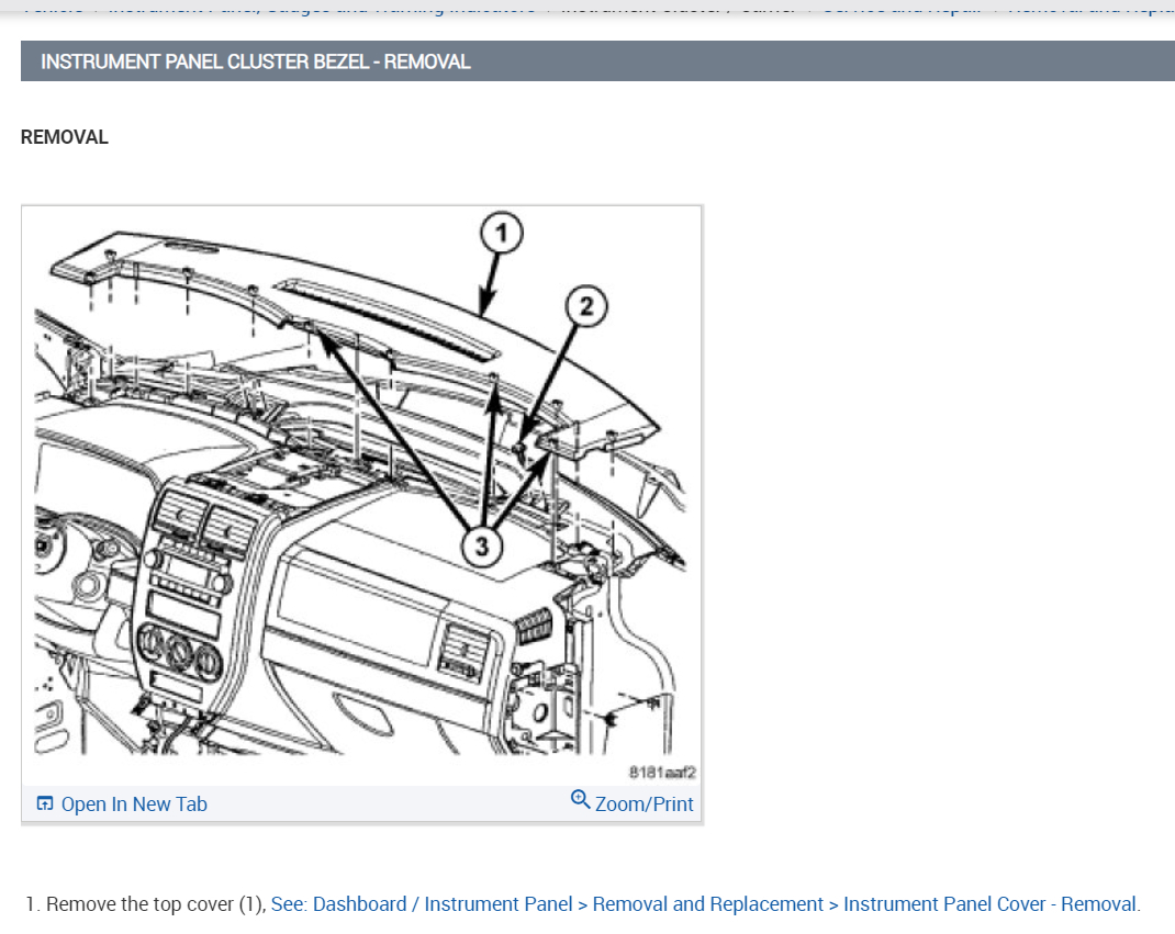

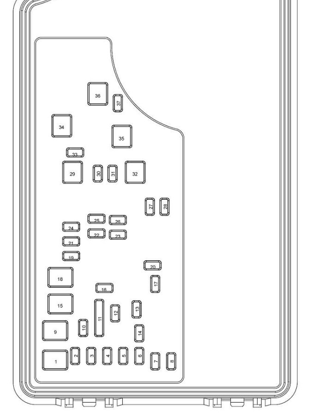

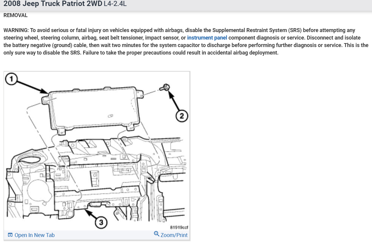

I have seen the cluster go out and cause this, but we should check the fuses first. This guide can help, and I have included the fuse location in the images below for clarification. Please check the fuses with the key on.
If the fuses are good, you should do a CAN scan which will help you by showing the codes.
You can get a CAN scanner (Controller Area Network) which will work on most cars from Amazon.
https://youtu.be/u-4syLc-ifQ

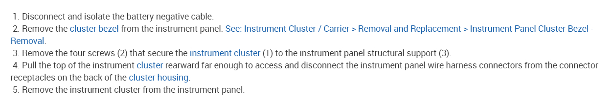

Here is how to change out the cluster, you can get a preprogrammed unit by searching Google or Ebay. Check out the images (below). Please let us know what happens.

Which fuse would it be? Number 14 under the hood?
Nov 5, 2023 at 2:40 PM
  • 55,421 POSTS
Please turn the key on and check them all. Takes 2 minutes.
