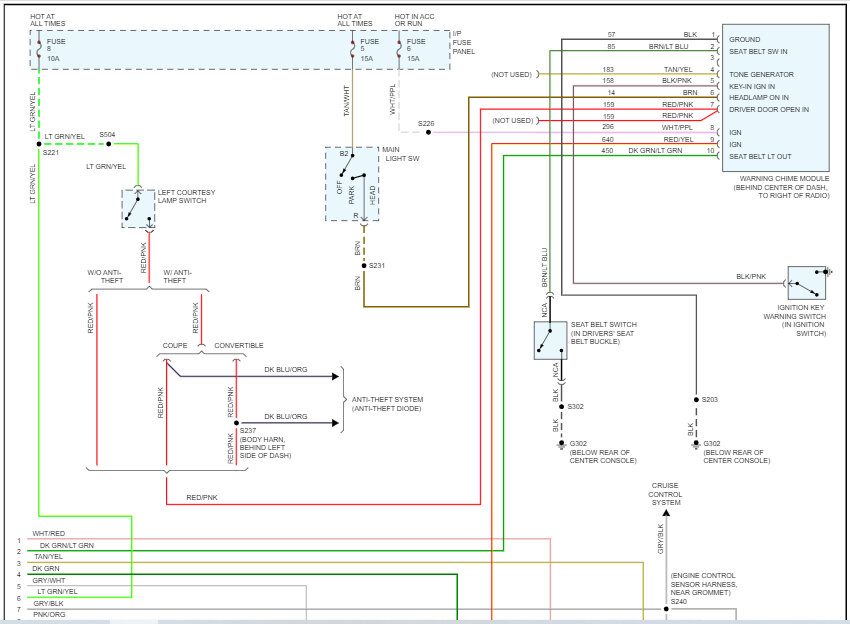

The car listed above is a GT. I gutted the whole interior; I bought a 1998 dash harness and want to thin the harness down for drag racing but don't know what the connectors connect to. I don't have the dash and can't find diagrams of what they connect too.

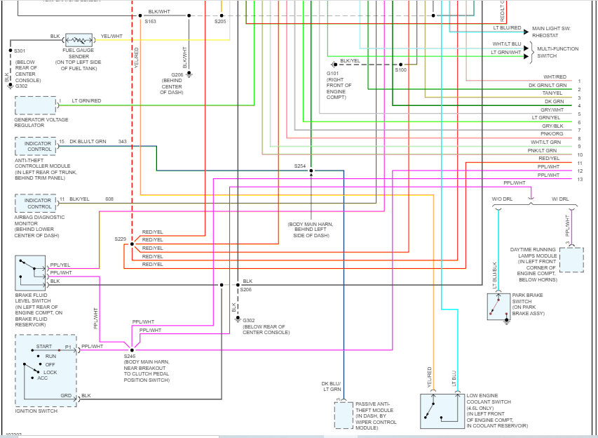

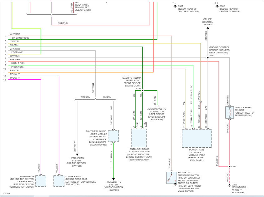

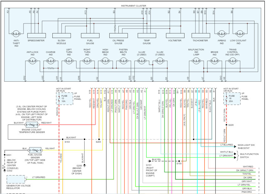

That is a tough one. I say that because you have the instrument cluster wiring, ignition, and under the dash you have wiring for the radio, heater motor, signals, and so on.
I attached the schematics for the cluster below. If that isn't what is needed (I think it is) let me know. Also, the schematic is for a 1998 GT. If you need something for the 1995, let me know.
See pics below. Note: The schematics were two pages long. I had to cut each page in half to make them readable for you. I did overlap them so you can follow from one to the next.
