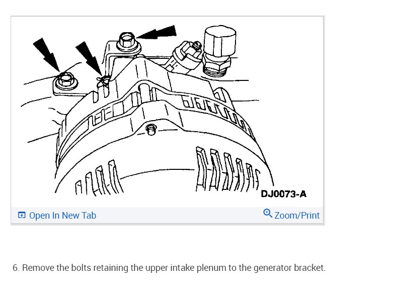

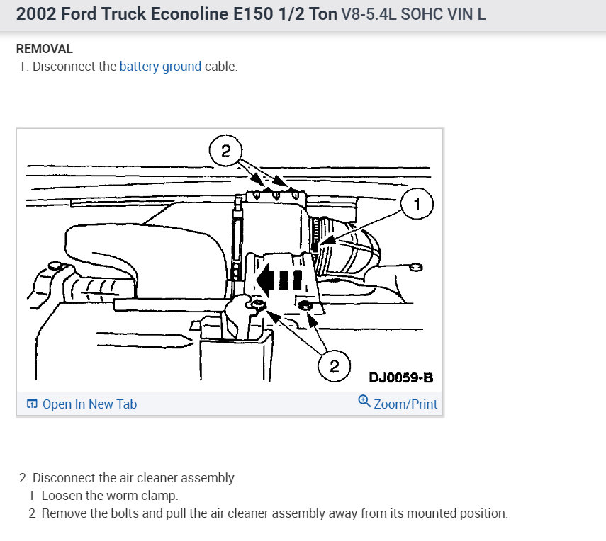

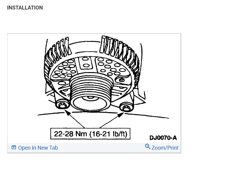

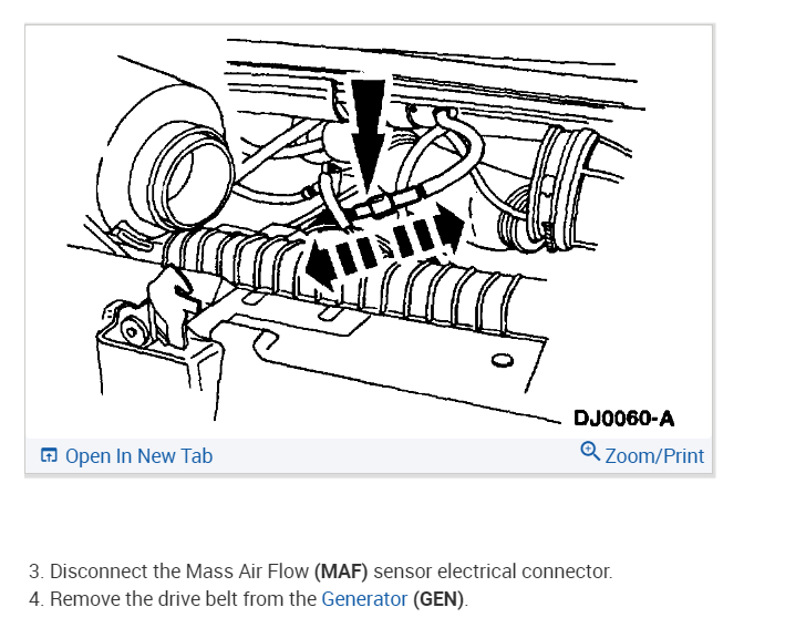

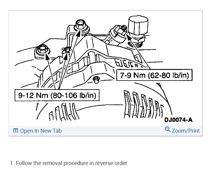

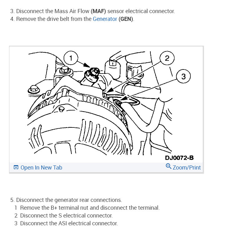

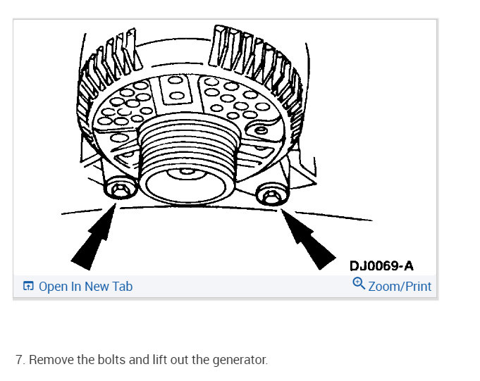

How did you check the battery? Also, the battery light on while you drive. Because it sounds like the alternator is not working. To be sure this guide can help walk you through how to test it:
If it is not charging here is how you can change the alternator out in the diagrams below. Check out the diagrams (below). Please let us know what happens.
