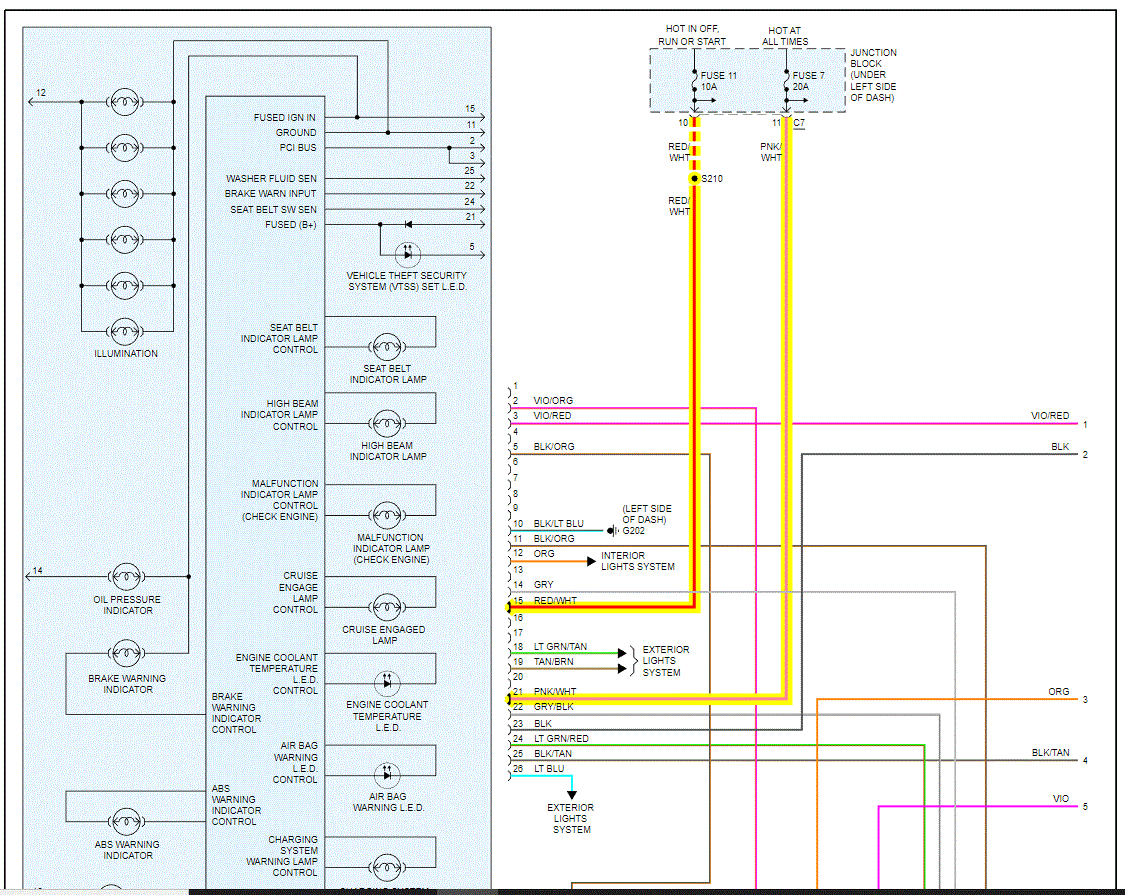

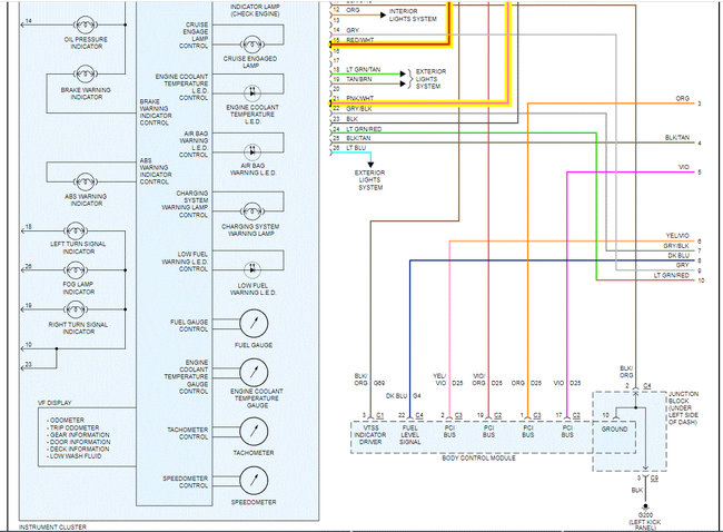

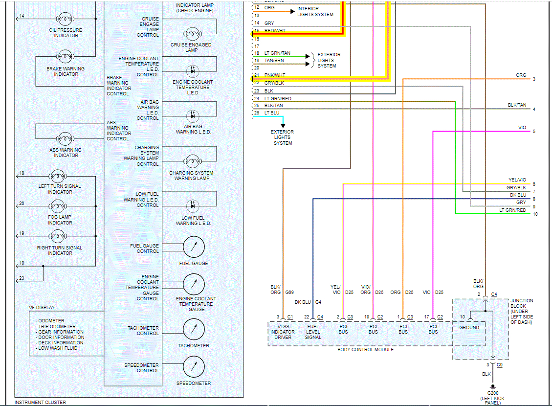

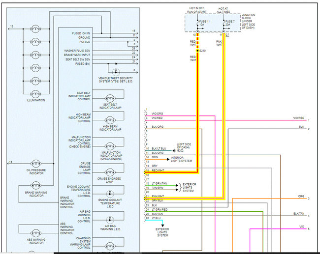

I just started the car up after I had driven earlier and now the gauges do not work and the dash lights just blink on and off. I checked a few fuses, but they are still not working.
Jun 13, 2022 at 7:03 AM
  • 110,244 POSTS
In addition to confirming the fuses are good, did you also check if there is power to and from them? If you haven't, I suggest trying that. Here is a link you may find helpful:
If they have power to and from the fuse, the next suggestion would be to confirm the connector at the back of the cluster isn't loose, damaged, or corroded.
Start with this and let me know what you find. Also, I attached the wiring schematic below for the cluster and highlighted the fuses to check.

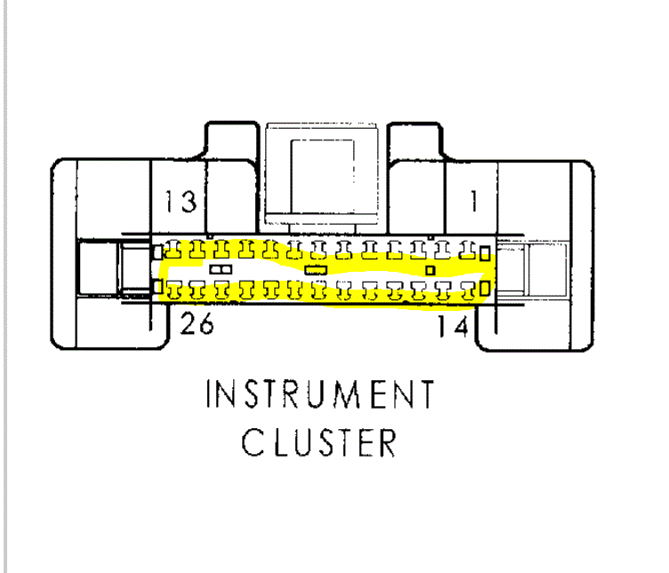

My wife did not have any problems with the dash lights, but she parked in the driveway, the car sat outside in the sun for about 2 1/2 hours and when she started it to put it in the garage the dash lights and gauges did not work. After about an hour in the garage, everything was ok again. so, it is a heat problem and no clue where to look to solve.
Jun 15, 2022 at 10:59 PM
  • 110,244 POSTS
Hi Glen, it does sound like the heat is causing something to expand and lose connection. The first thing to check would be behind the dash where the connector connects to the instrument cluster. With the key off, disconnect the connector and see if anything seems out of place or damaged in any way.
If it looks good, get yourself some dielectric grease and put it on the connector pins. The connector is a 26-pin connector, so anything could be causing it to lose connection.
I attached a pic of the connector below. Keep in mind, this could also be the printed circuit board in the cluster itself.
Let me know what you find or if you have questions.
