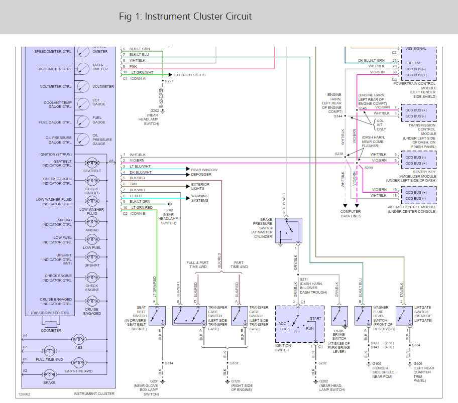

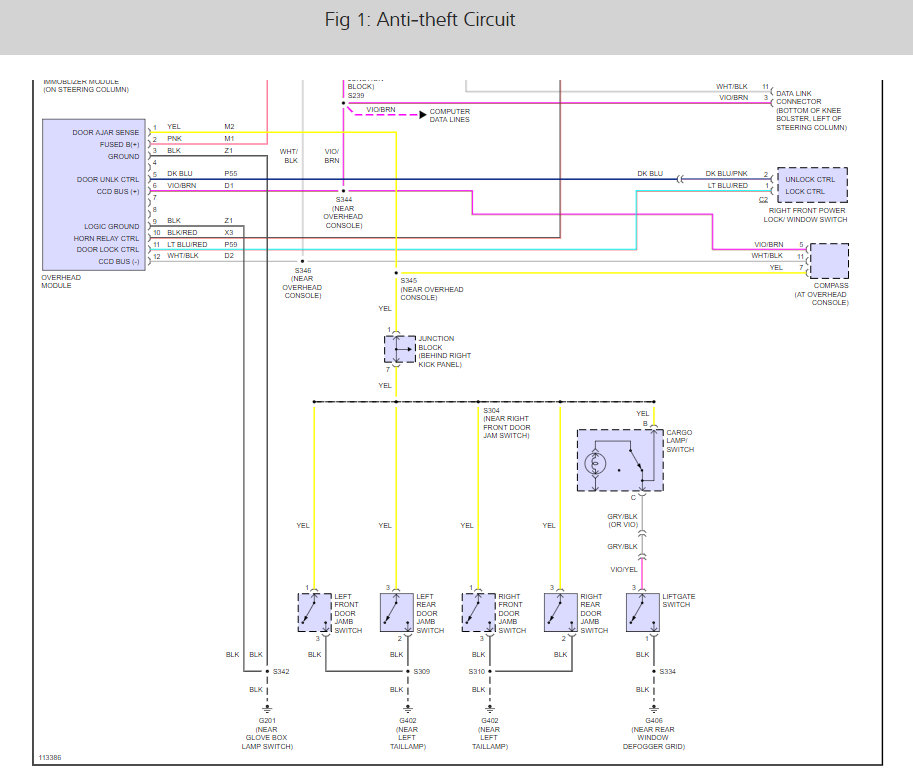

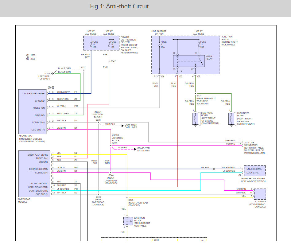

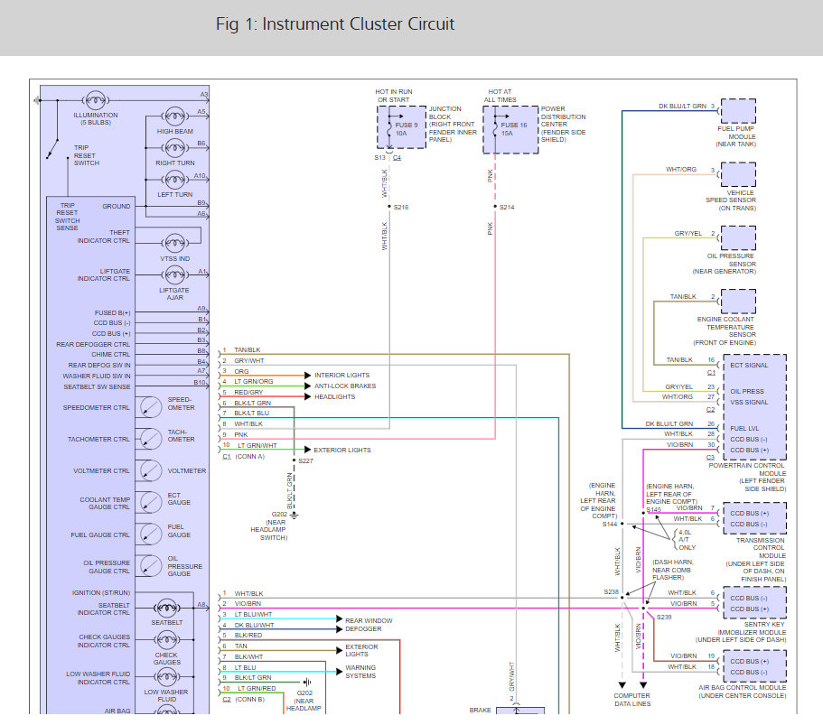

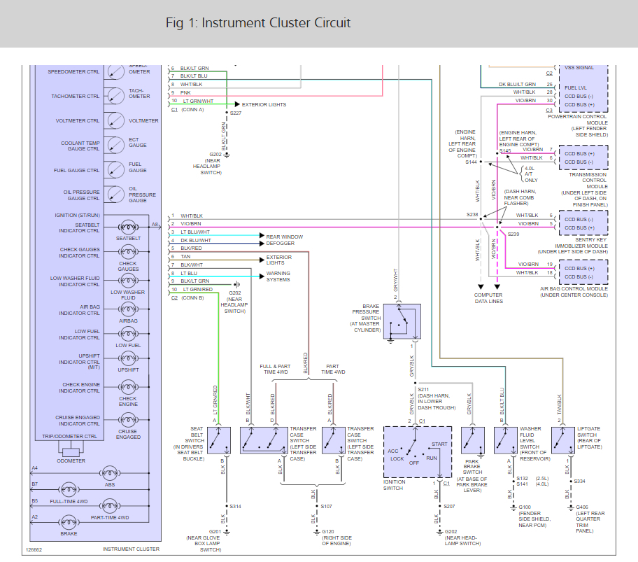

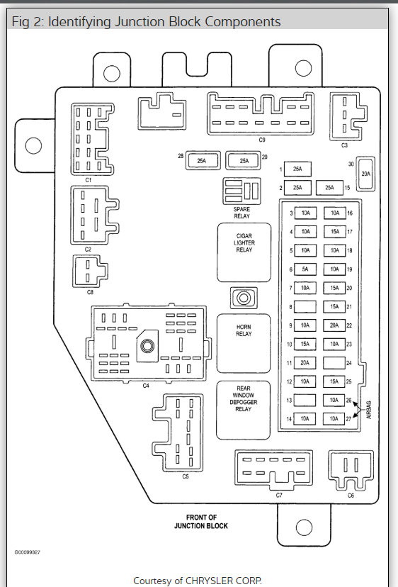

These system share fuse #9 and #16 can you check to see if the fuse is loose it its holder please. Here is a guide that can help with the wiring diagrams for both the cluster and the security system so you can see how they work and the fuse locations:
