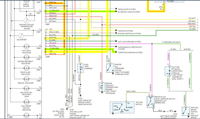

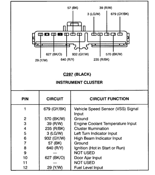

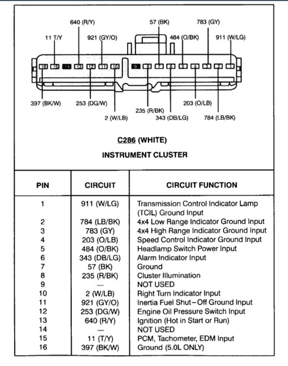

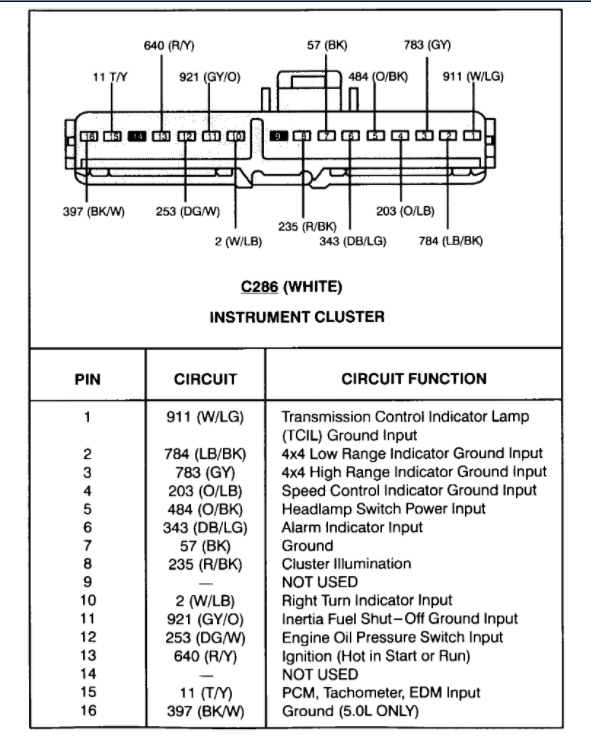

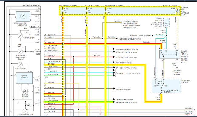

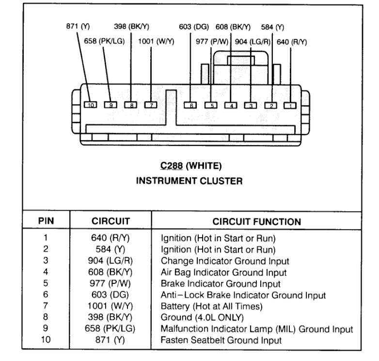

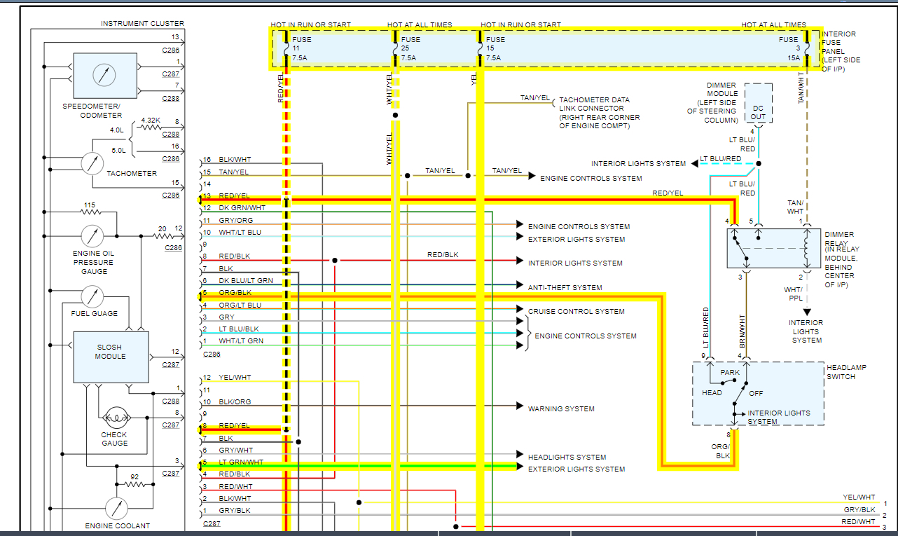

The gauges stopped working. the dome lights, radio, and headlights all work. just no gauges.
Dec 26, 2020 at 12:51 PM
Good morning,
I attached a video for you below to remove the gauge cluster. You need to verify powers to the cluster. From the sounds of it, the cluster is the issue.
https://www.youtube.com/watch?v=dFn5SrV-5EU
I also attached a wiring diagram for you to view as well. It shows the fuses that control power to the gauges.
