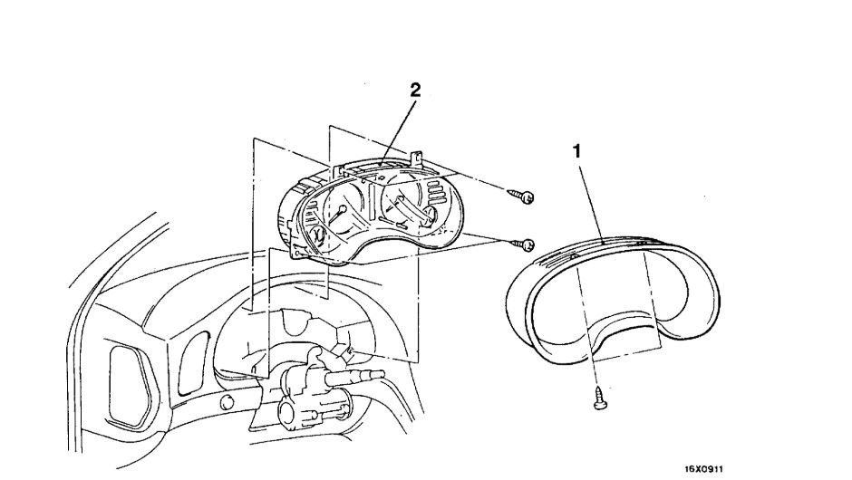

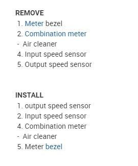

Planning to sell car but can't display that it only has 45,000 miles on it. The car listed above Jxi convertible with V6 Mitsubishi engine in otherwise pristine condition. Approximate cost to repair?
Mar 8, 2020 at 1:42 PM
Good morning,
This sounds like the cluster has failed internally.
We remove them and send them out for repair.
Cost-wise, I would allow about $300.00 to $500.00 with parts and labor.
