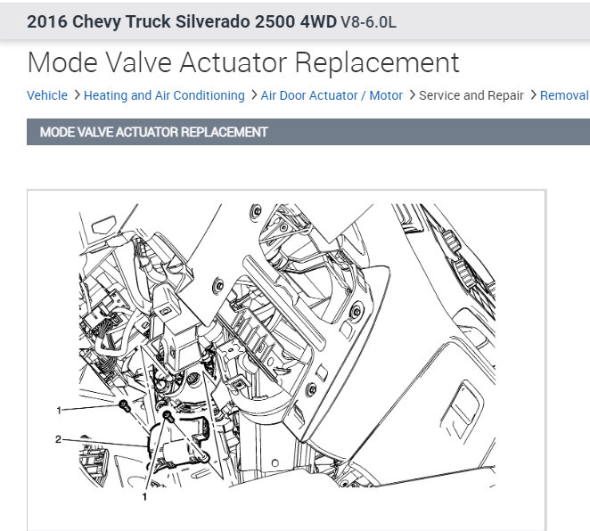

More flows out the floor vents, I'd say 75% floor and 25% dash, when I switch between dash and floor/dash blend nothing changes.
I found the hot/cold blend actuator but cannot find the one I am referring to.
Jul 27, 2023 at 5:00 AM
  • 110,244 POSTS

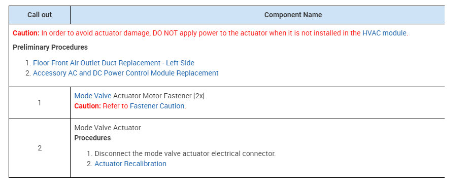

I believe you are referring to the mode door actuator. It is responsible for airflow direction.

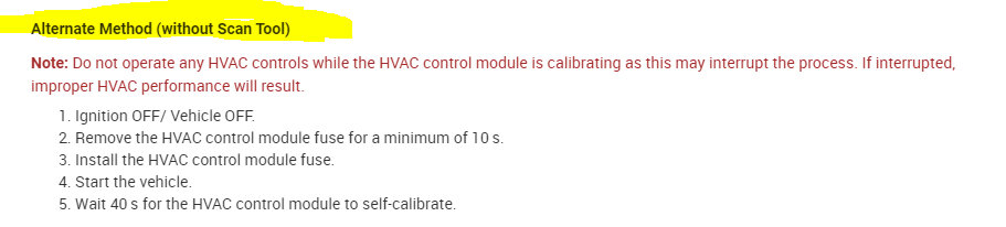

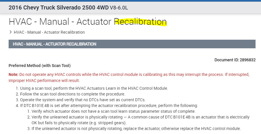

If you look below, I attached the directions for replacing it. Once you replace it, it will require calibration. The last two pics are the directions for doing it. Note that pic 3 is if you have a scan tool to recalibrate. If you don't, go to pic 4.
Let me know if this helps.
