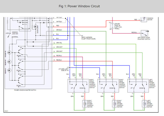

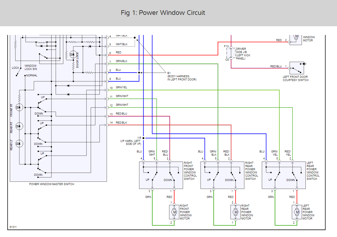

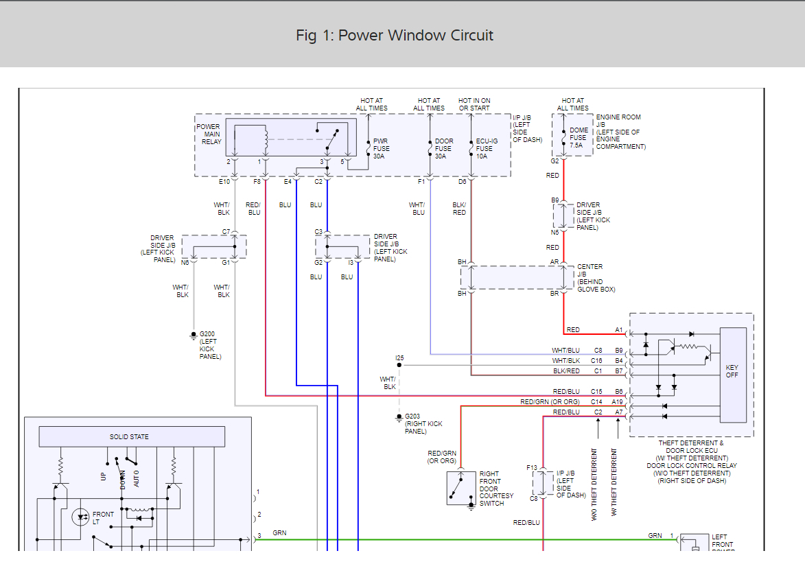

I had two that worked and two not. Then I inadvertently short out a power line behind the stereo and I've replaced almost every fuse , flasher relay, third brake light, etc. I think it's the window relay but cannot find it! Please help guys.
Jul 1, 2019 at 2:55 PM
SCGRANTURISMO
  • 4,897 POSTS
It looks like your vehicle doesn't have a power window relay. I have included the wiring diagram for your vehicle's power window circuits in the diagrams down below. Please use this wiring diagram to locate the problem you are having and get back to us with what you are able to find out.
