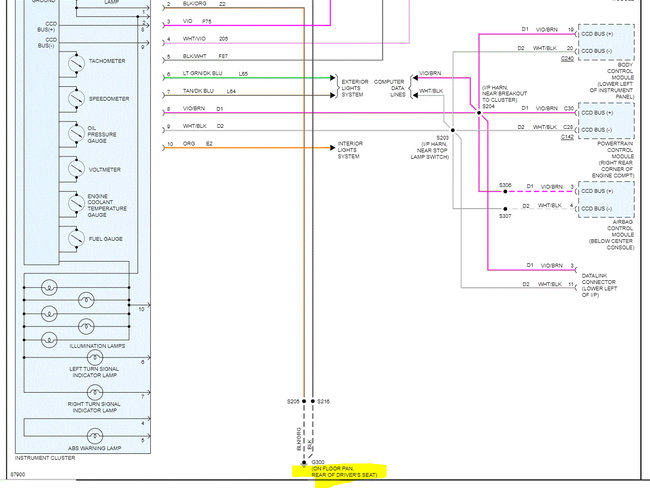

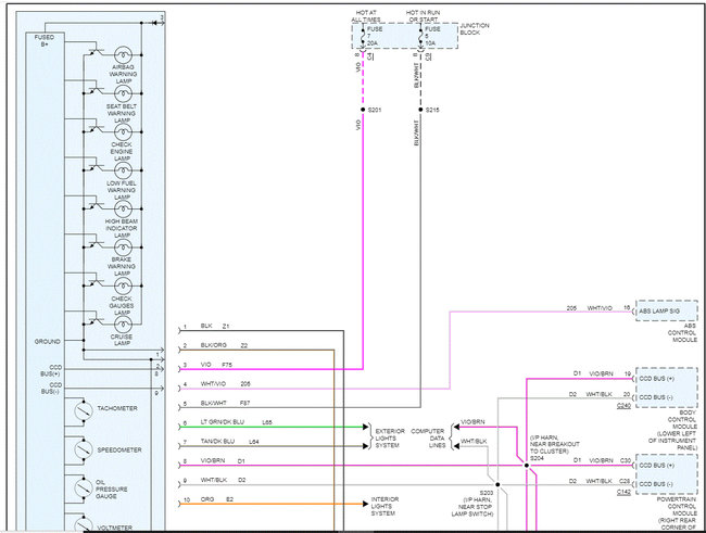

I attached the wiring schematic below for the instrument cluster. I need you to recheck the two fuses indicated in the pic, fuses 5 and 7. Both are located in the junction box located on the right-side kick panel.
In addition to checking the condition of the fuse, confirm there is power to and from them. Here is a link you may find helpful:
Next, if the fuses are good, go behind the cluster and locate the solid black wire in the connector. With everything off, check for continuity to ground. The ground is located in the rear of the vehicle on the floor pan, so it may be corroded, damaged, or loose. Note, if there is no continuity, there is a splice that may have failed as well.
Let me know what you find.
