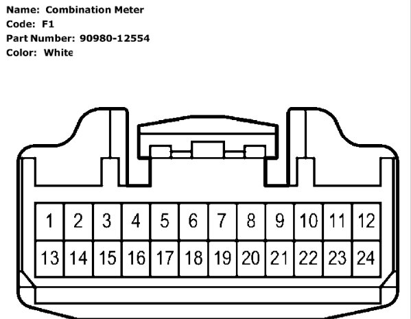

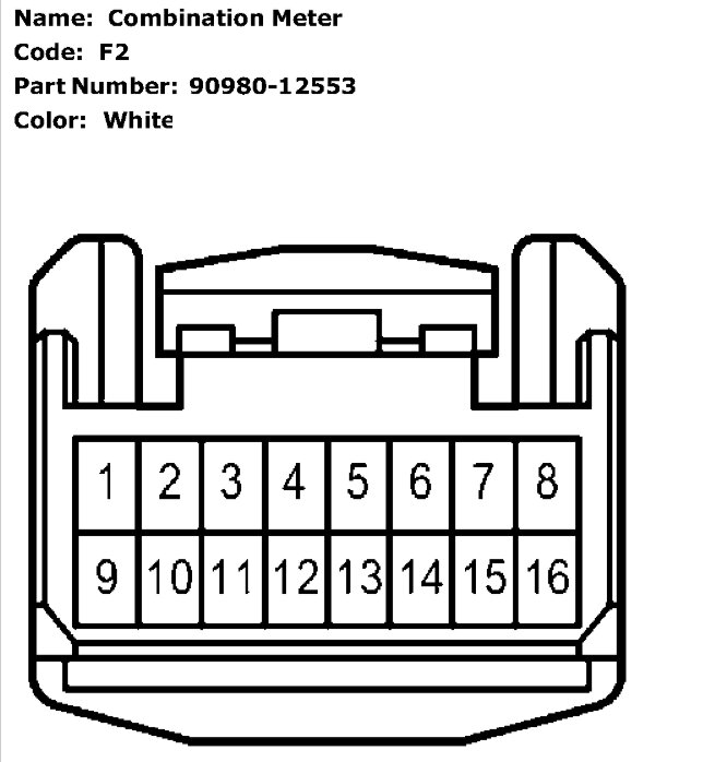

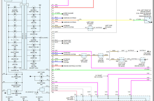

457952-8682-1 A pin out connection
Feb 8, 2026 at 10:16 PM
Experienced Mechanic
55,628 POSTS
Sure, here is the pin out for the dashboard cluster. Let me know if you need anything else. Check out the images (below) Ken
