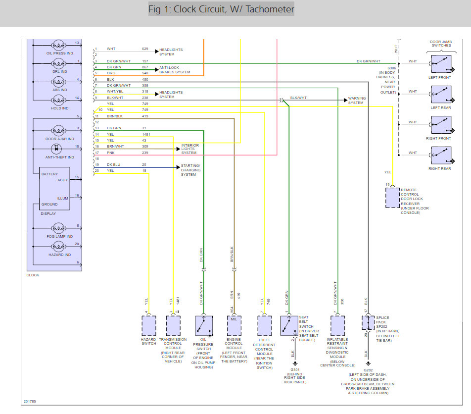

My car's dash clock only comes on when the key is turned to accessories, as well as my dash lights. once i start her the clock rarely stays on, if she does it is intermittent.
Please help

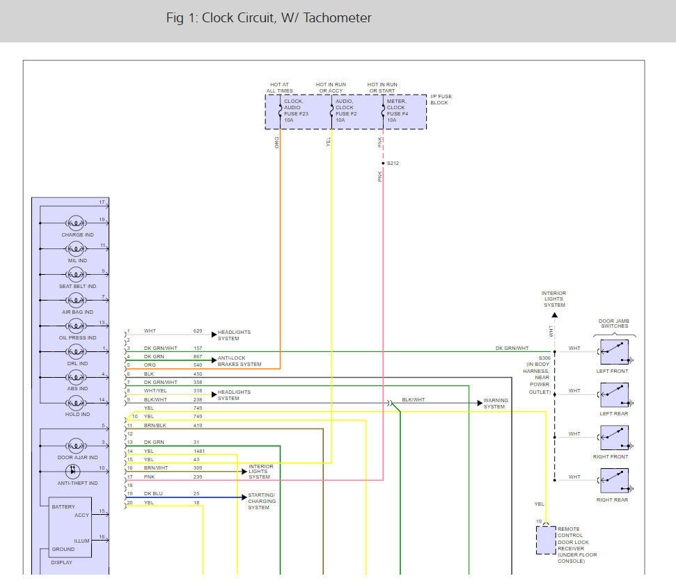

It sounds like the clock module is going out but to be sure we need to see if the clock is getting power and ground while it is not working. This will confirm the failure.
Here is a guide and the wiring diagrams for that clock:
