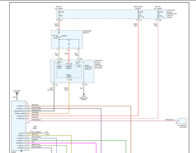

I just bought this car and everything was working just fine. I replaced the radio and the dash board lights don't work. It will show me things like my mileage and blinker and all that but I can't see how fast i am going. I'm not sure what fuse it is to look at or if it's something else.

When you installed your vehicle's new stereo where did you hook up the yellow and red wires to?

I added those wires to the correct wires that were on the radio.
Red went to a red/white wire and yellow went to a pink wire.

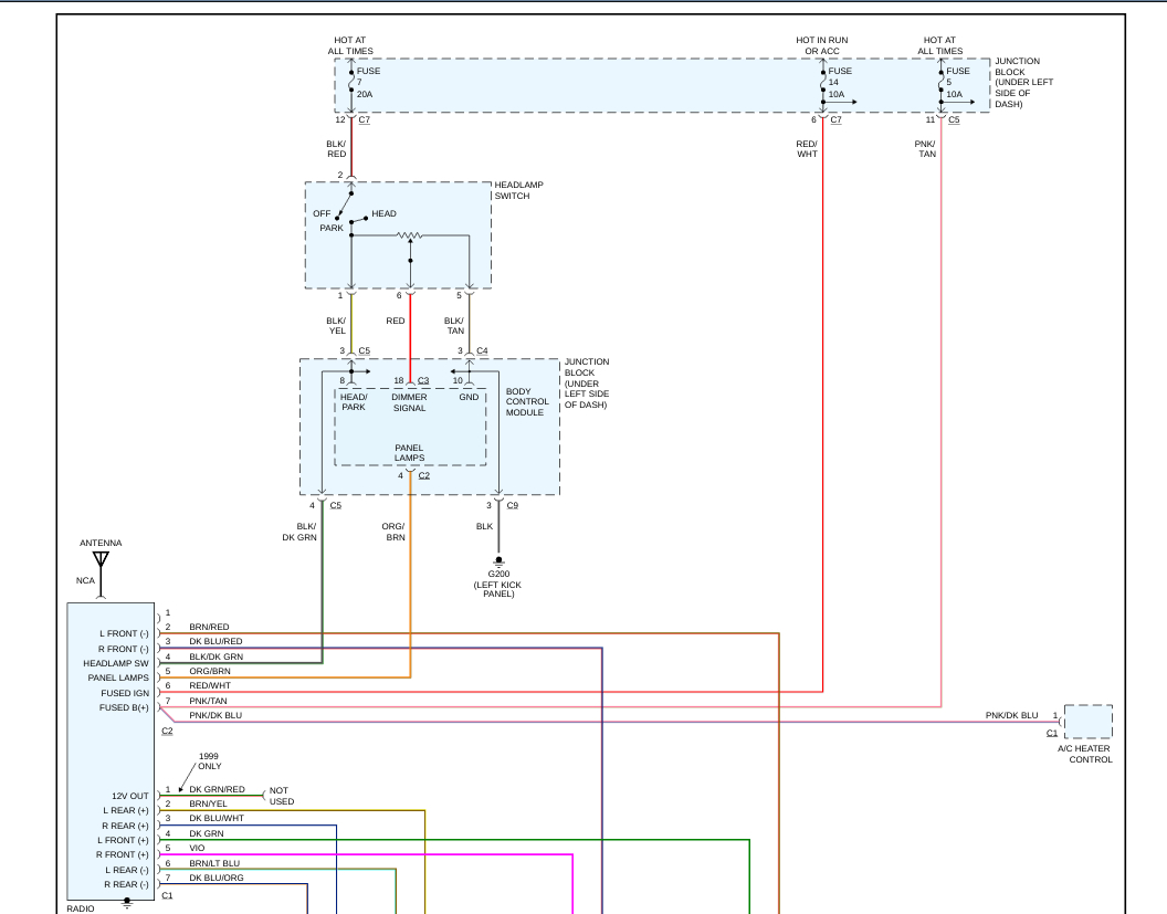

In the diagrams down below I have included the stereo wiring diagram for your vehicle. Please go through this diagram and get back to us with how everything turns out. I hope this helps.
