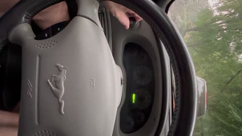

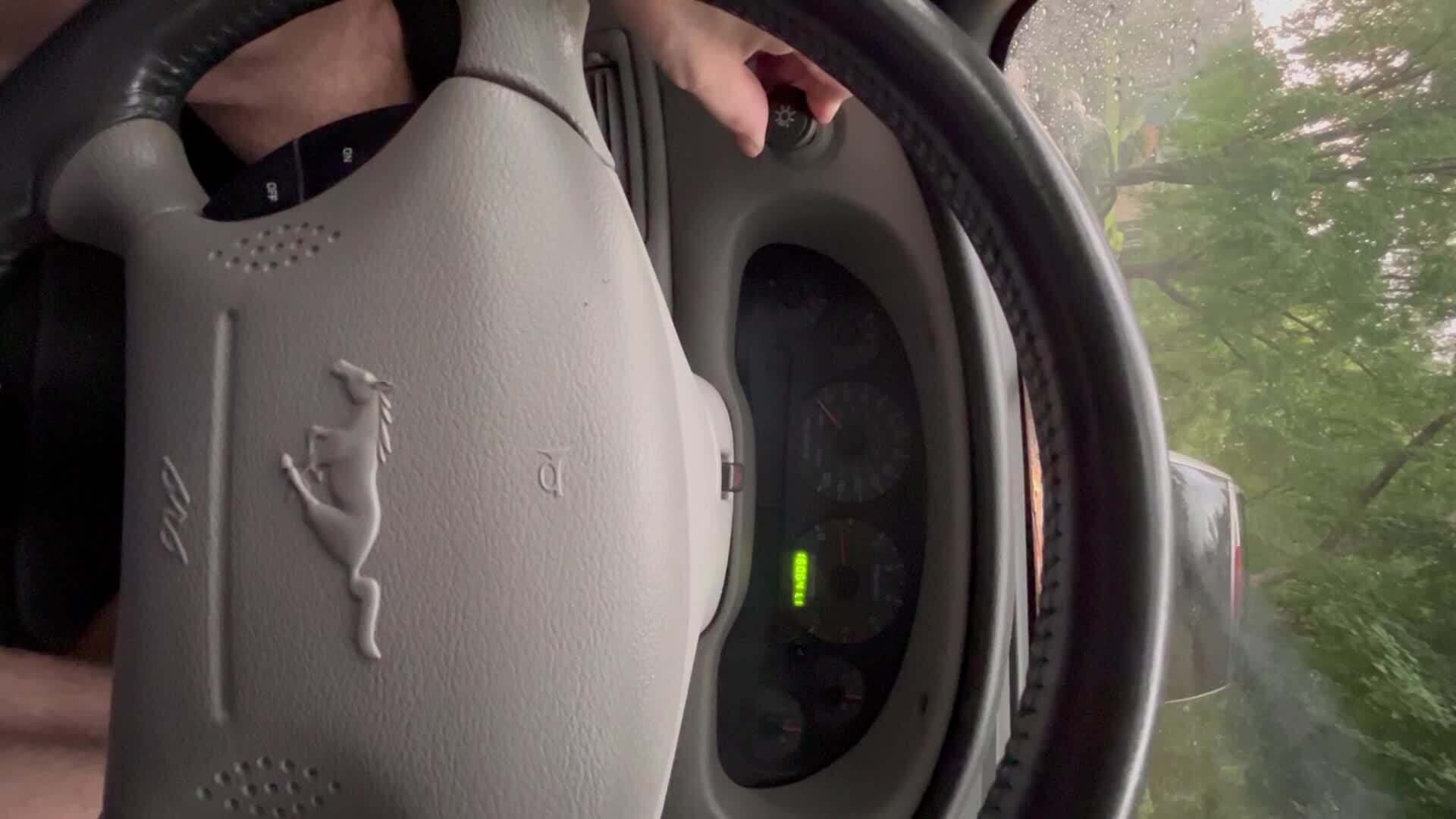

My dash board lights are controlled by a gremlin. Using the dimmer switch, it doesn’t seems to control the lights they way you’d expect. I have to turn the knob several times each way to find the sweet spot that will light up my dash.
Once I have dash lights, if I turn off the headlights and turn them back on, the dash board lights May or may not come back on.
Related to this, the lights for the odometer and tripmeter don’t always light up after starting the car. Sometimes it takes 5 minutes of driving before they come on.
The head lights always work. It’s only the interior dash board lights that have a mind of thier own.
Thanks.
Any help is appreciated.

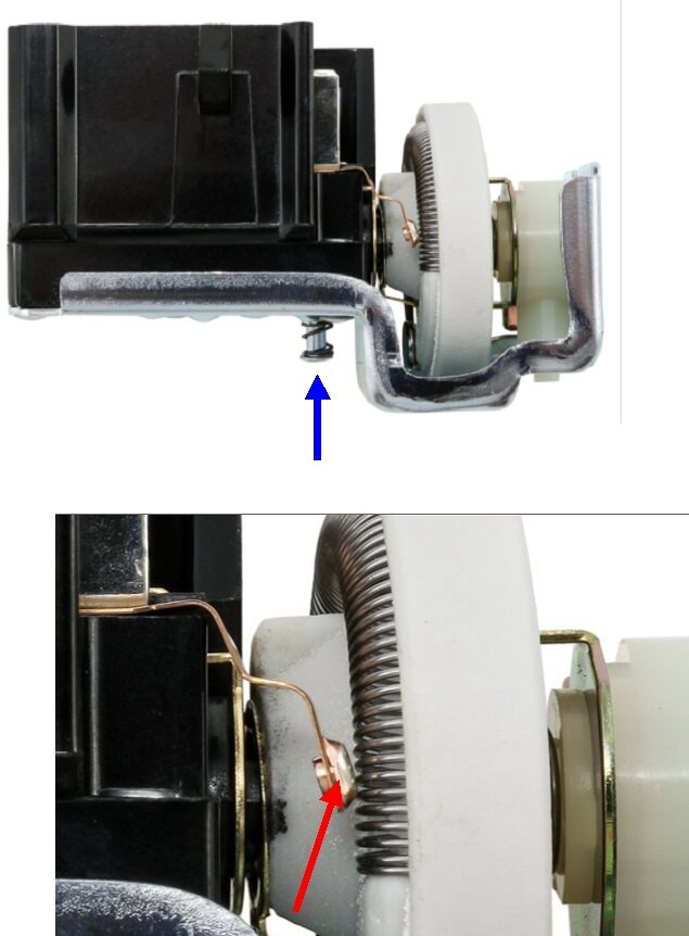

For the dash lights, the common failure is the contact on the rheostat, (red arrow in the photo). Sometimes the springiness is lost so it doesn't make good contact. Sometimes the contact arcs and welds itself to the coiled resistor wire, then, when you rotate it, the contact gets bent over backward. You're lucky then if it makes contact at all. I've also had some where the coiled resistor wire breaks free of the ceramic material it's glued in with, then gets bunched up with high and low spots. I tried to glue that wire back in once with epoxy, and while it did work, that wire gets hot, and my car smelled like epoxy every time I turned the lights on. The better approach is to just replace the switch.
For a hint, push the switch knob in (off), then press the button, (blue arrow). That will allow the knob and shaft to be pulled out.

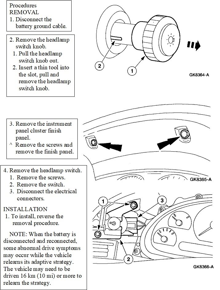

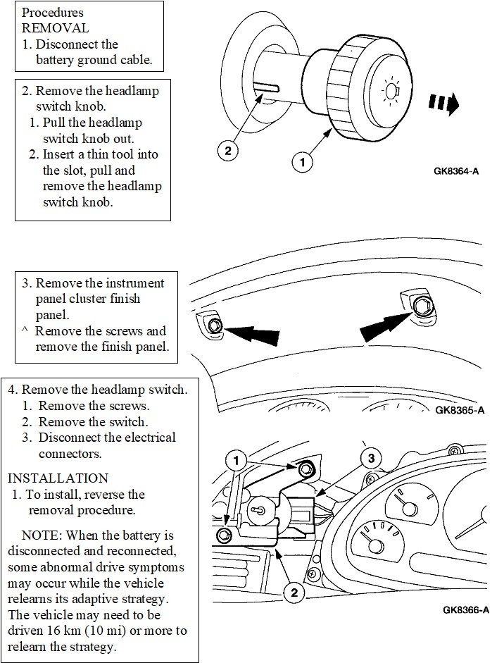

Yup, that's the head light switch. I've never seen where you could buy just the rheostat, although I did switch the one on my Challenger many years ago. The donor switch was different, but the rheostat was the same, and was removable.
As for how to remove it, you'll be the expert once you look at it. The first step is to reach under the dash and feel around for that button, (blue arrow). Press that, then pull the knob and shaft out. Behind where the knob was, will be a thin nut to unscrew. As I recall, some of those had two tiny holes to stick in the points of a snap-ring pliers or a needle-nose pliers to turn the nut. With the nut removed, the switch is pulled out the back.
Oops. Now that I shared that wondrous information, I found the correct procedure. Apparently the knob and shaft come out differently than I've seen before, and there is a trim panel to remove. Follow the procedure I pieced together below, and let me know how you do.
