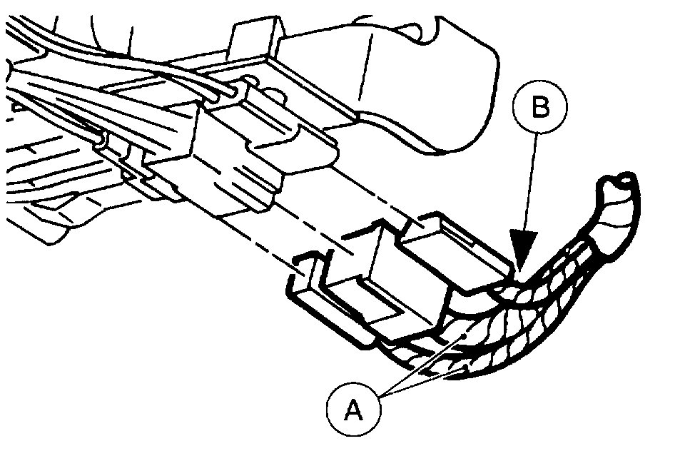

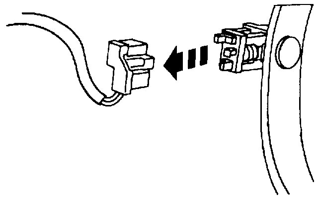

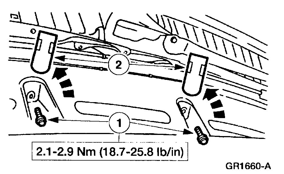

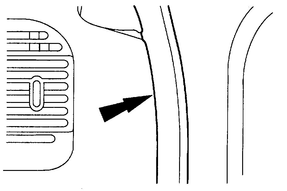

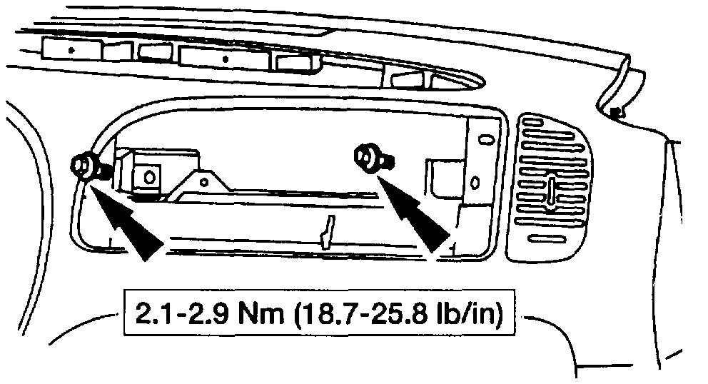

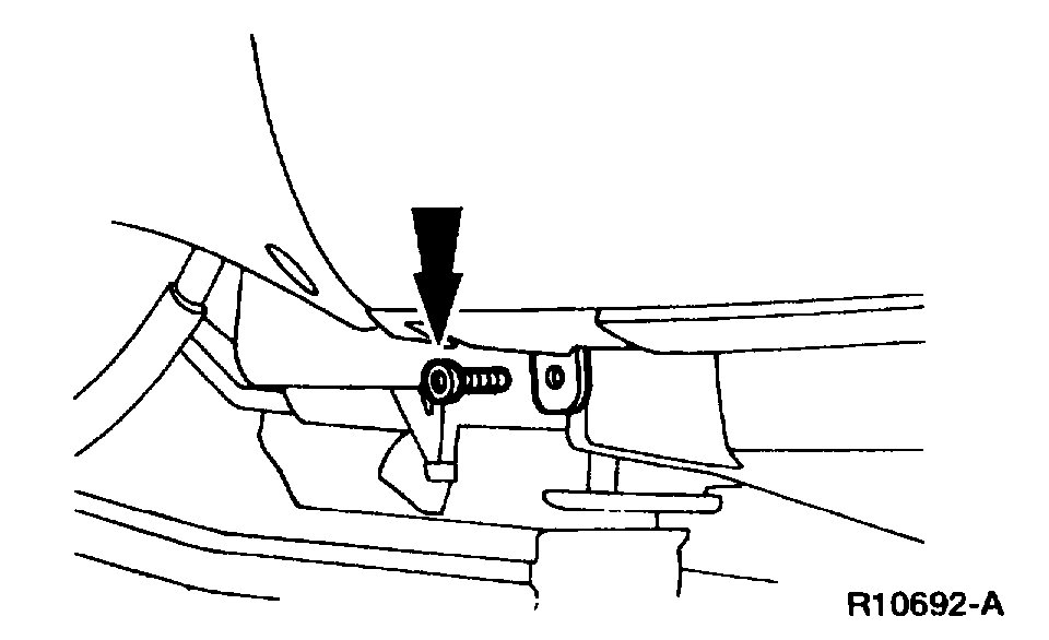

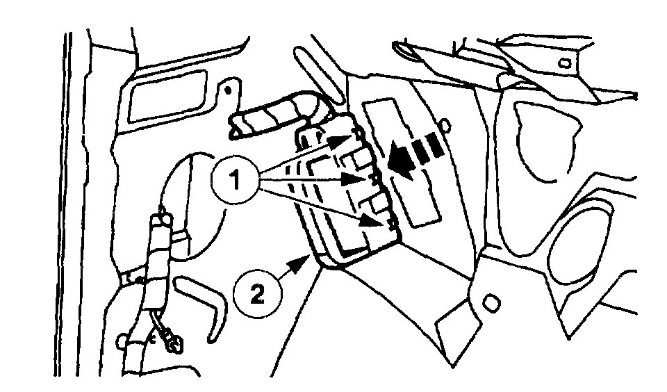

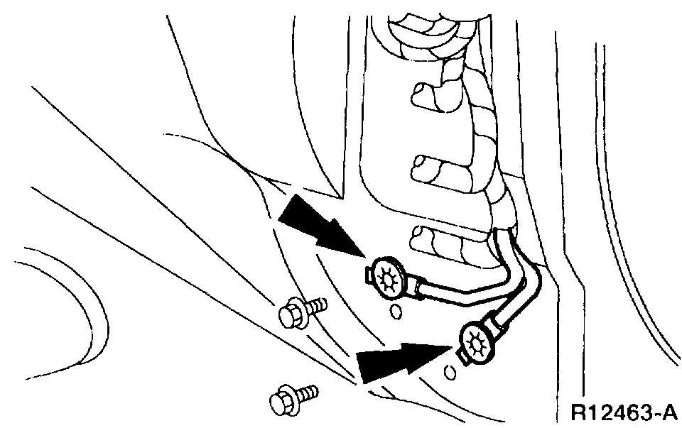

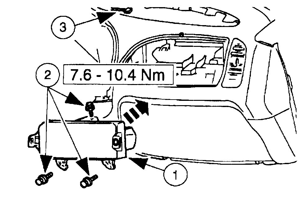

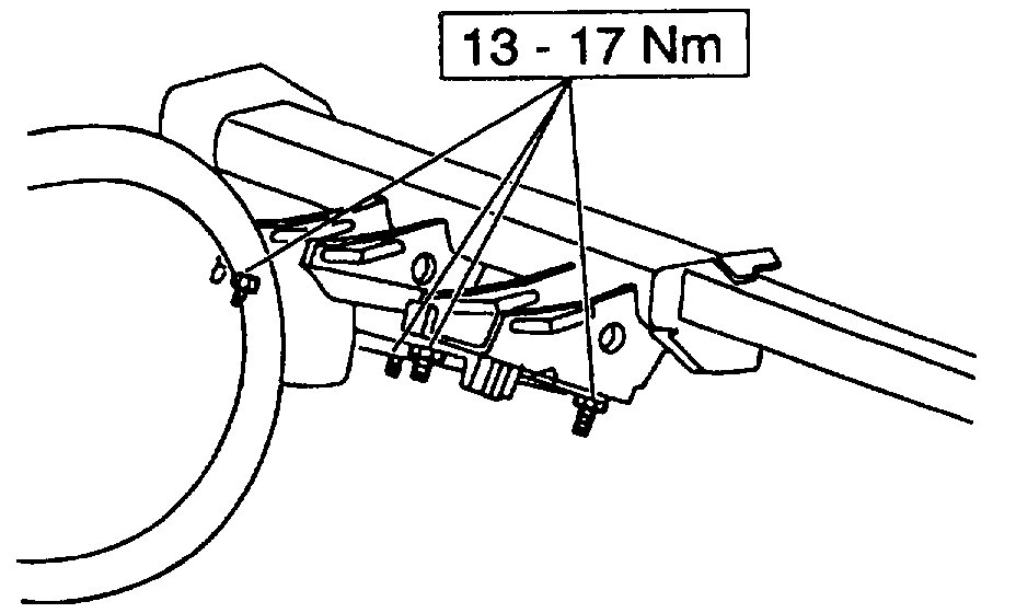

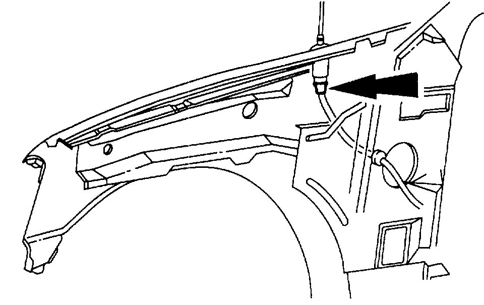

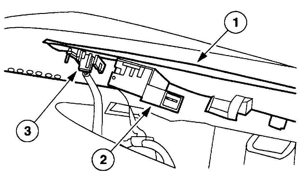

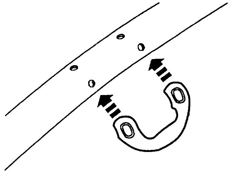

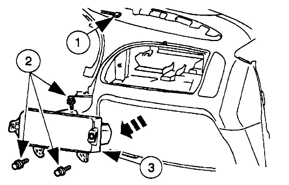

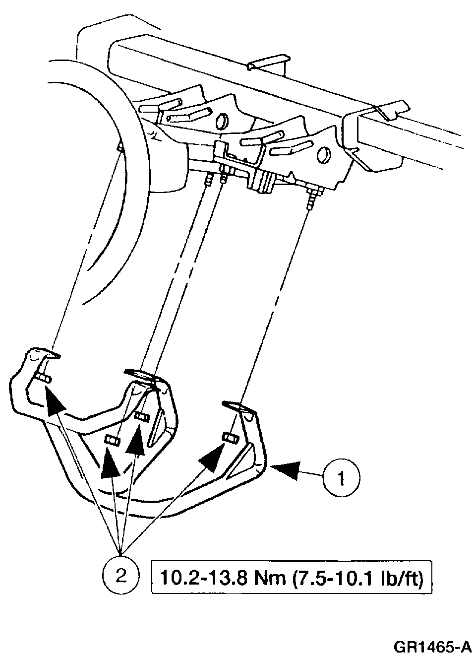

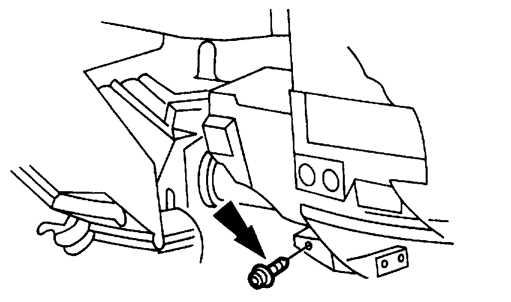

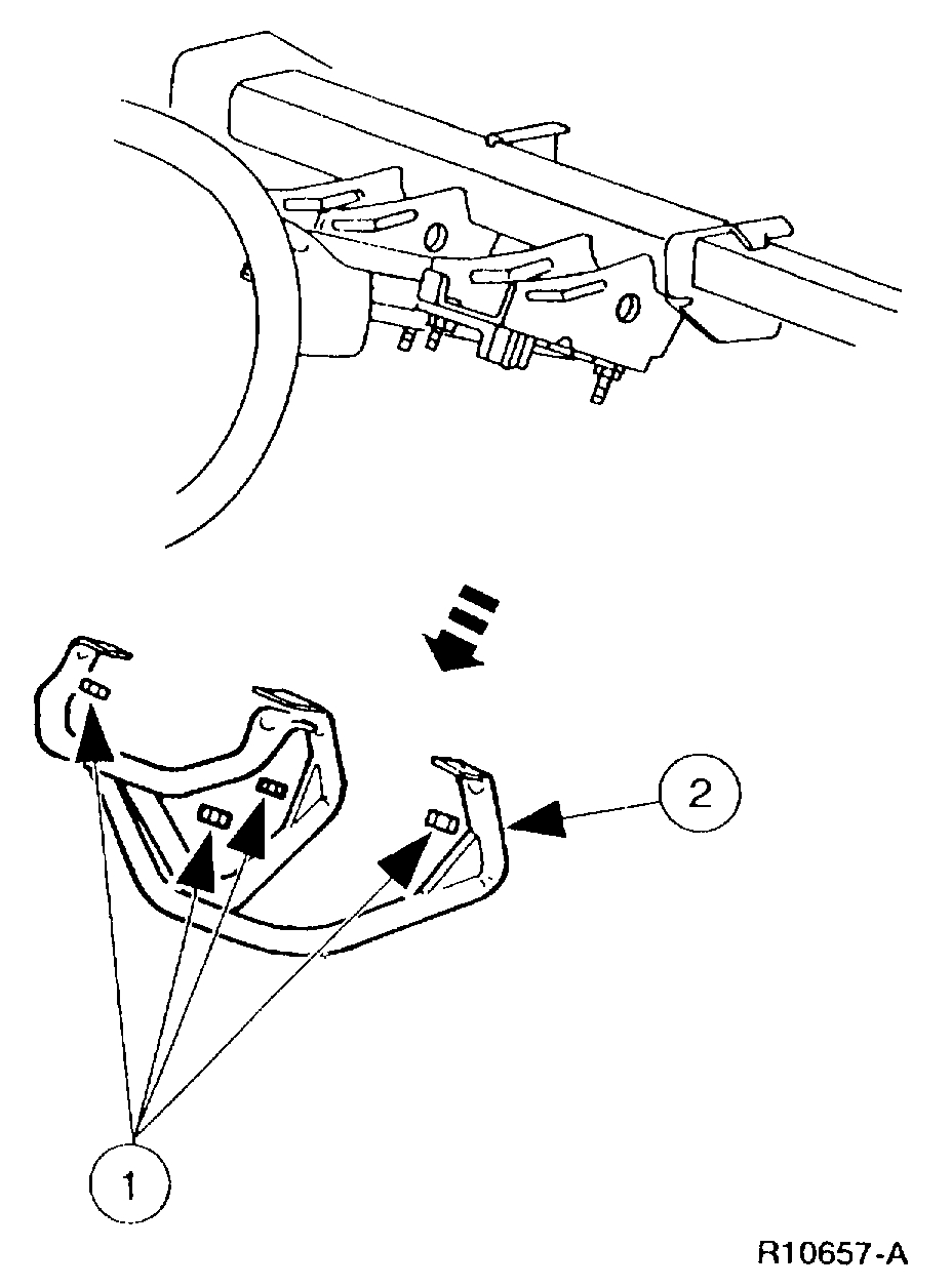

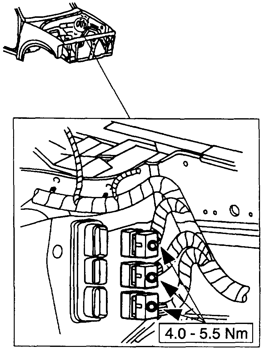

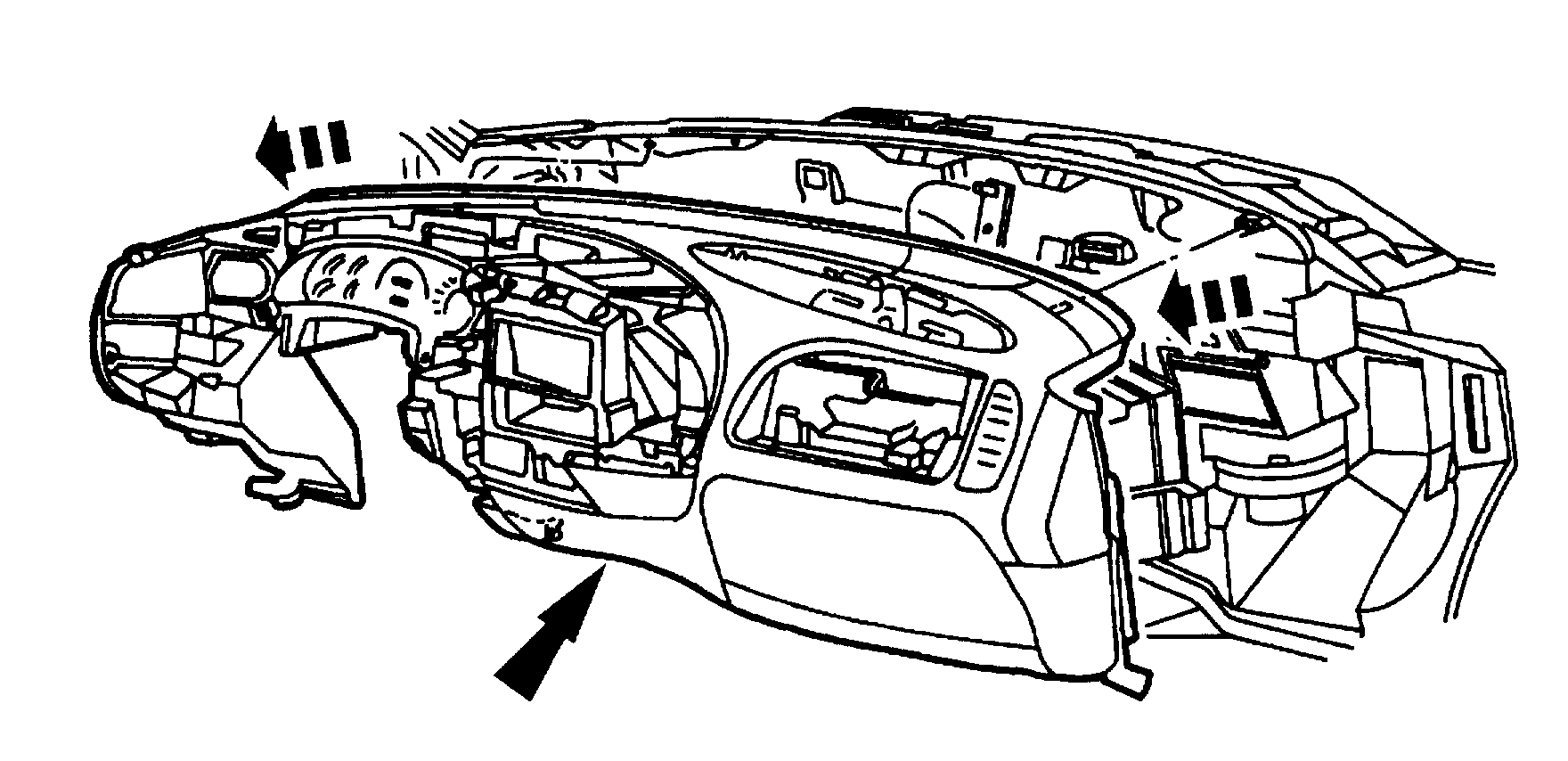

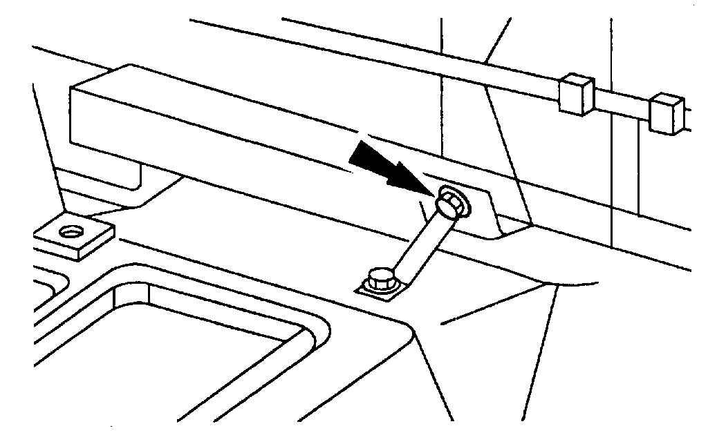

Could I get diagrams of how the dash is assembled please?
Nov 21, 2020 at 1:41 PM
  • 110,240 POSTS

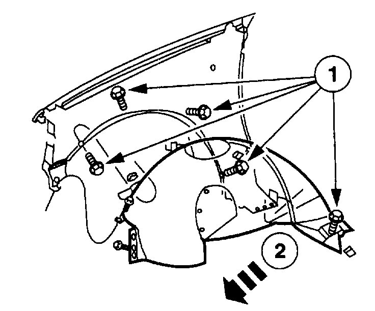

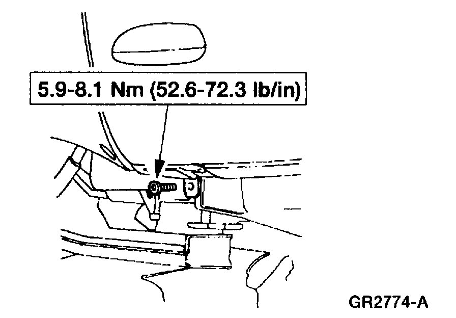

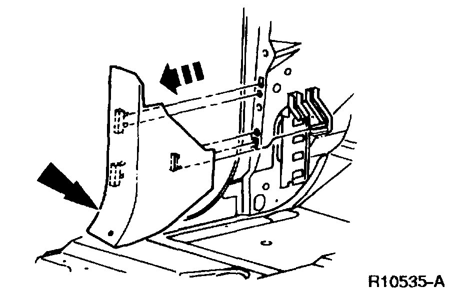

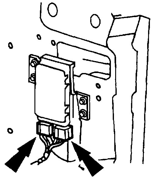

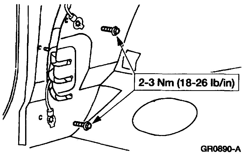

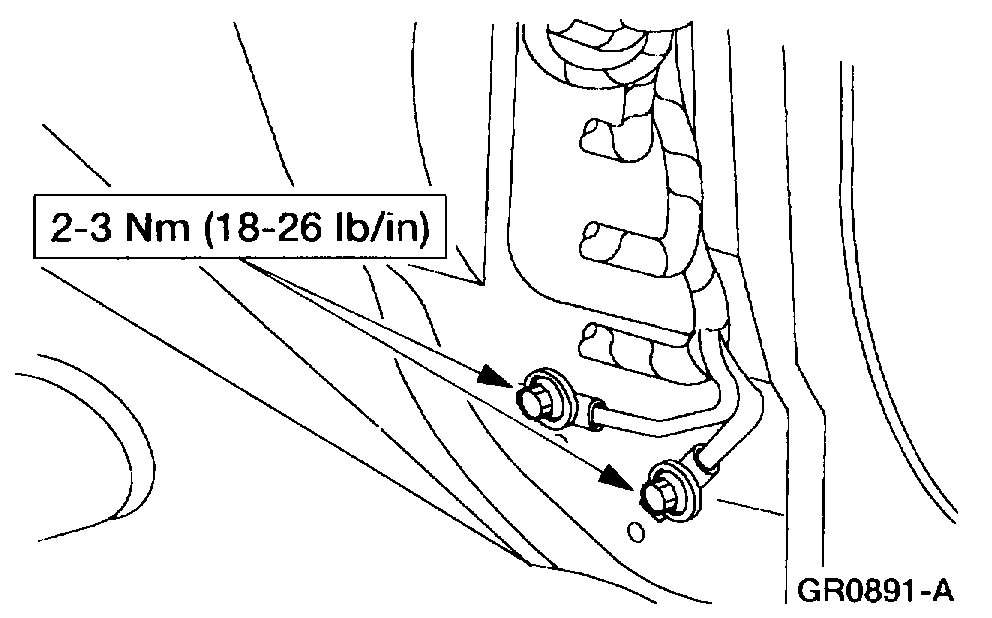

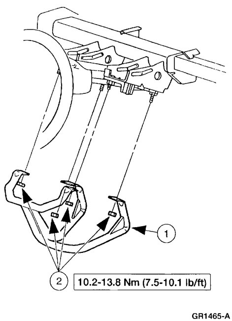

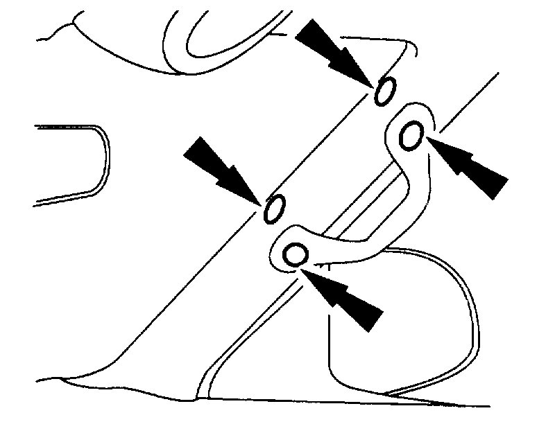

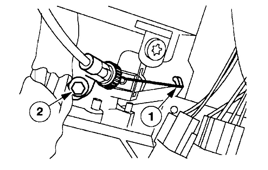

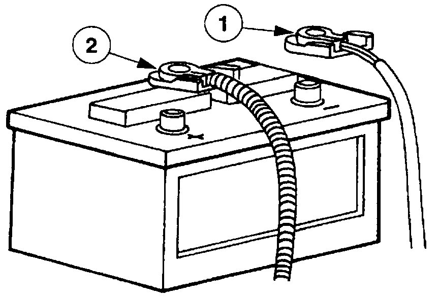

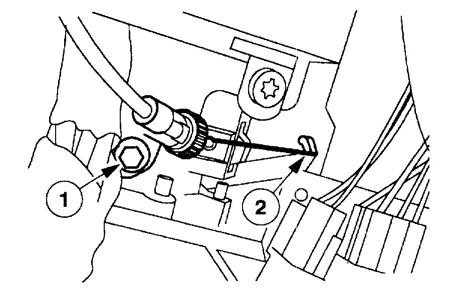

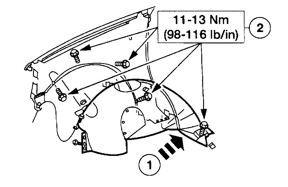

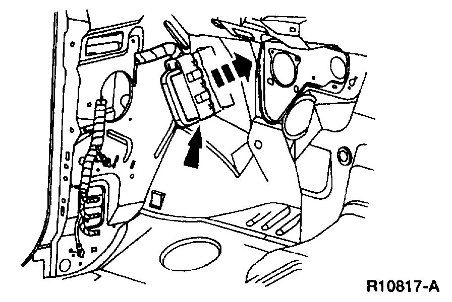

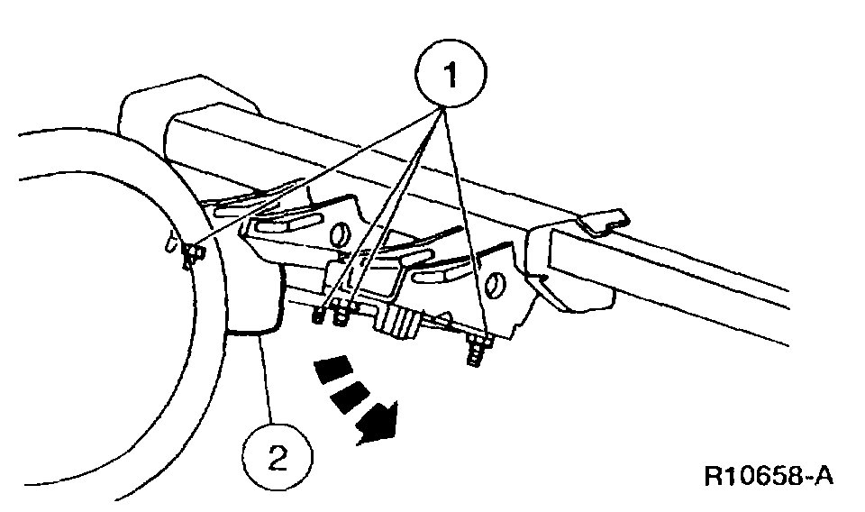

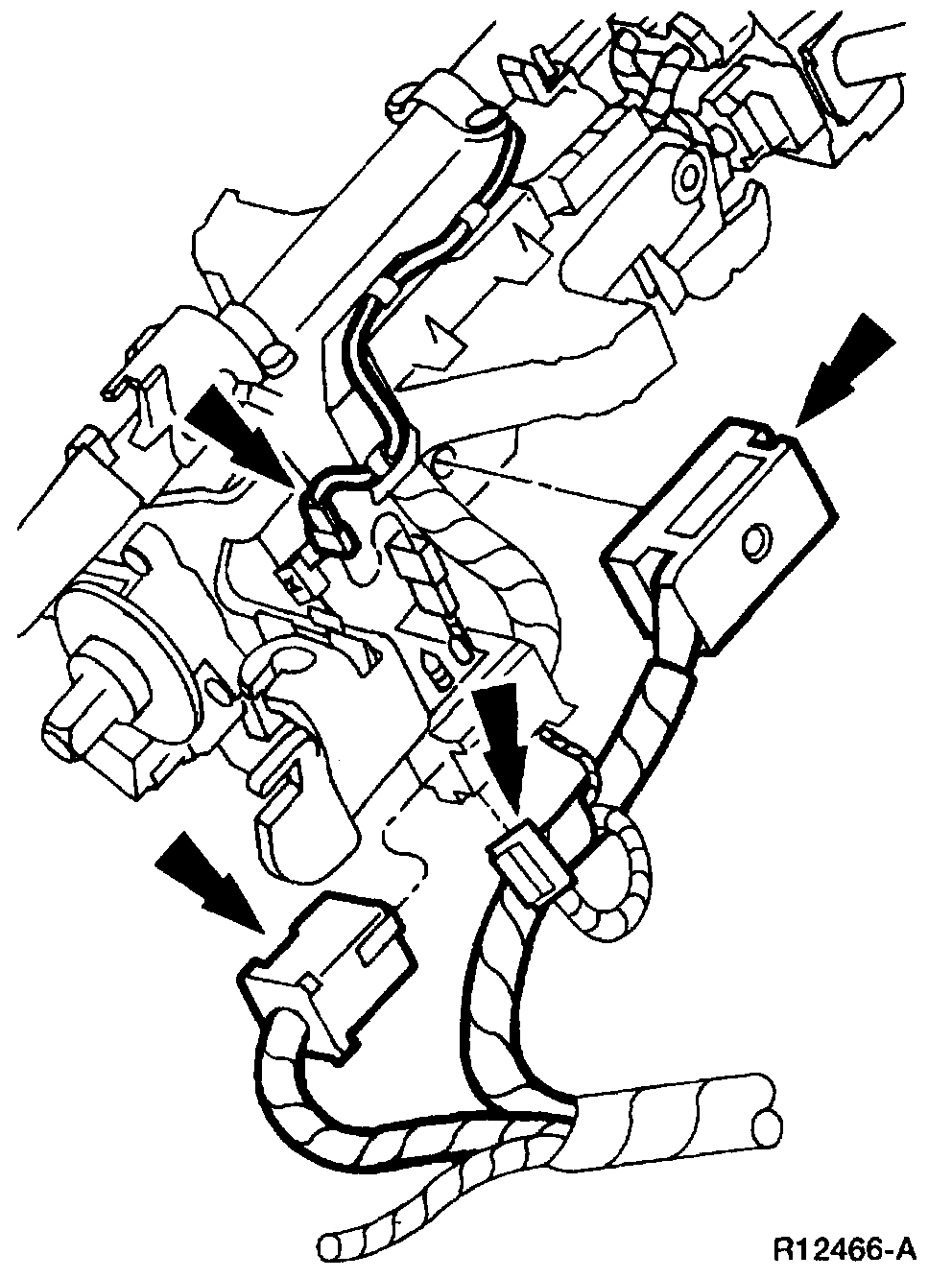

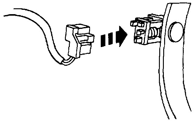

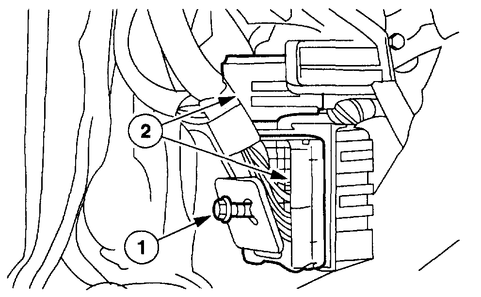

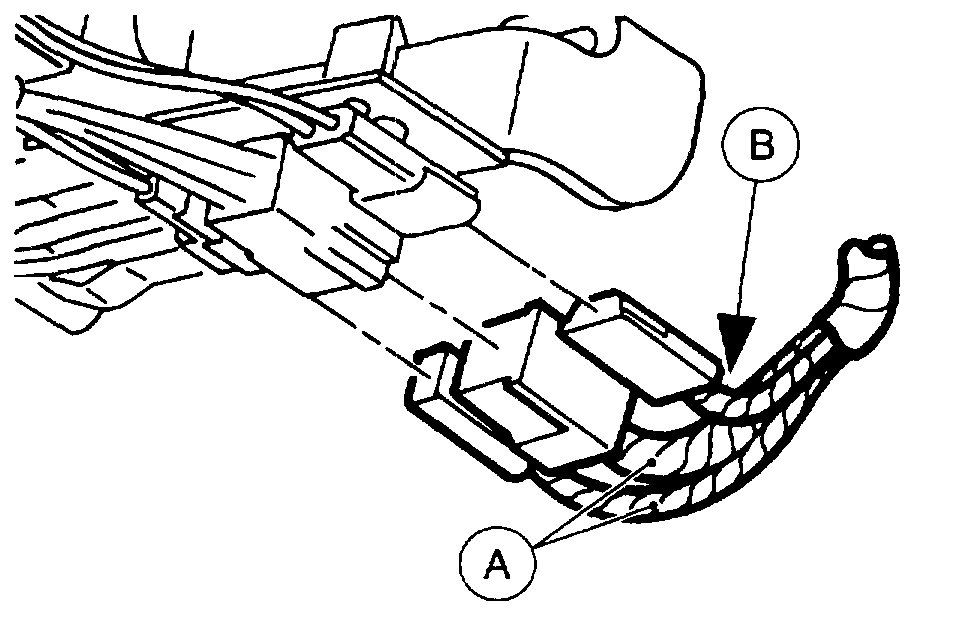

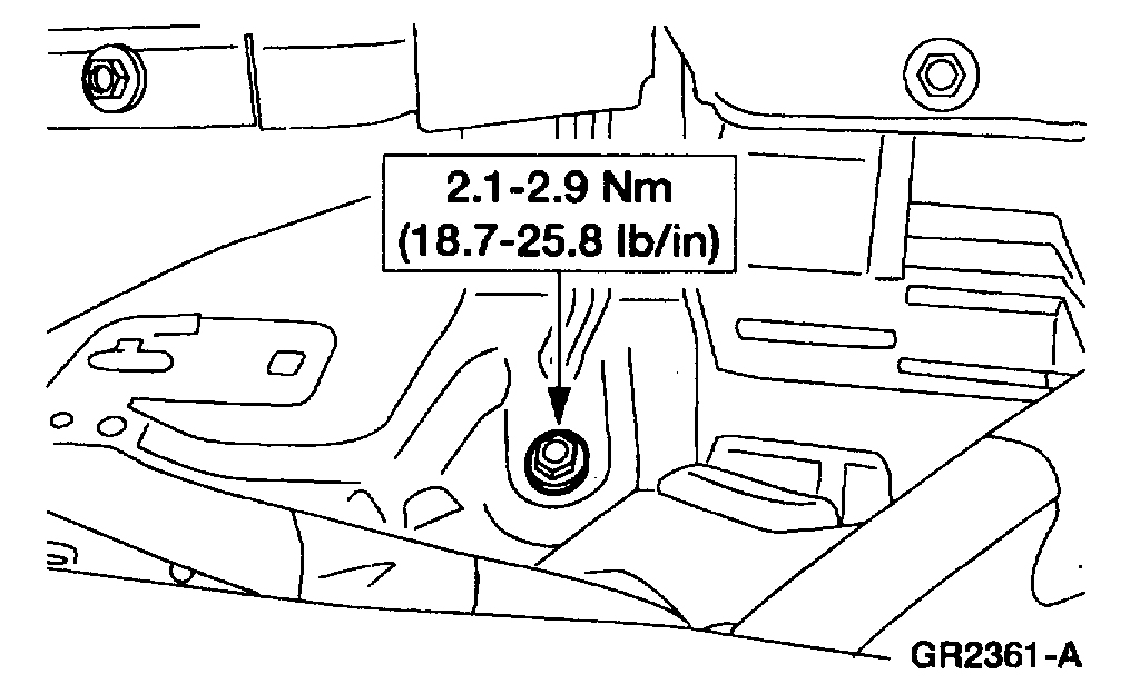

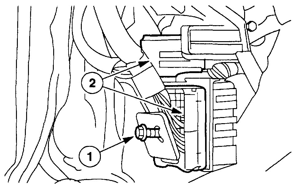

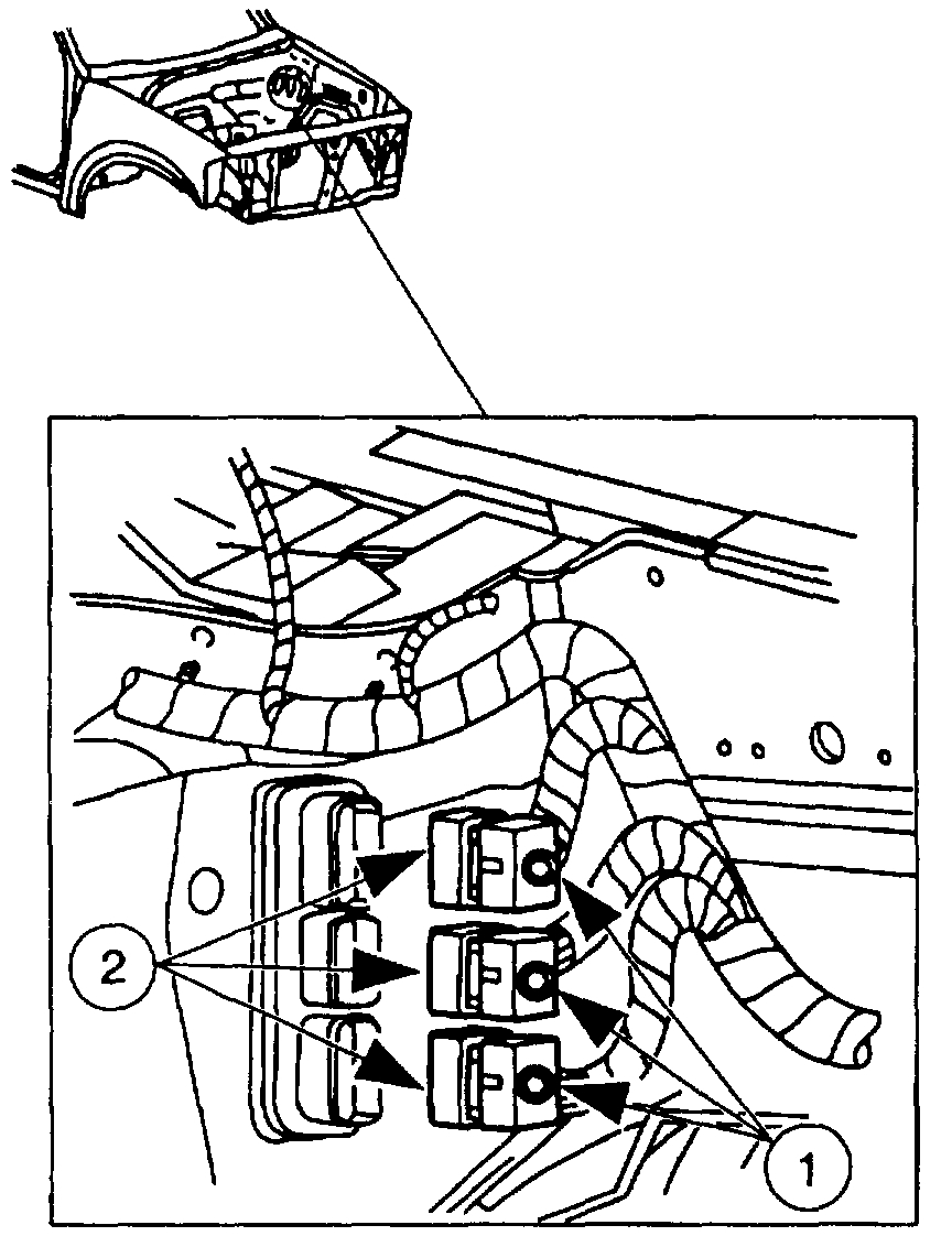

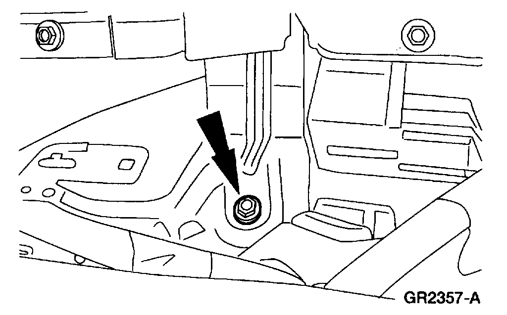

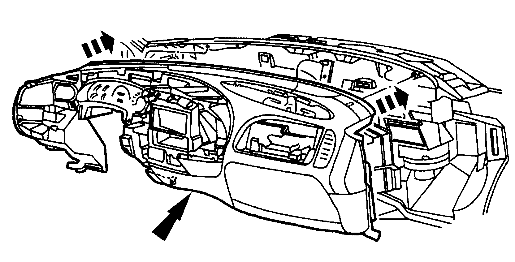

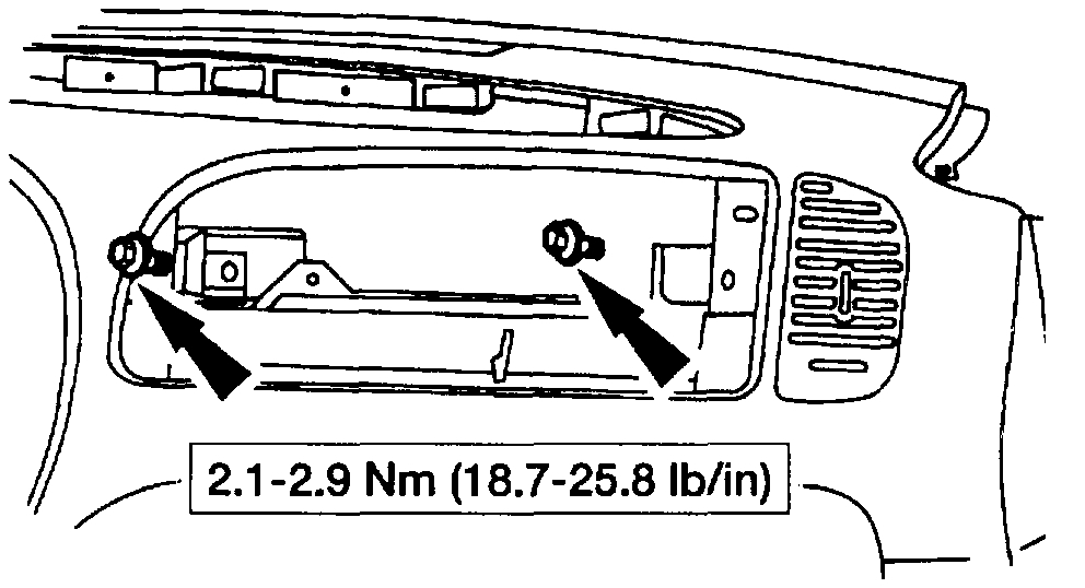

I will provide the directions for the removal and installation of the dashboard assembly. It is extensive. The attached pics correlate with the directions.
____________________________________________
1998 Ford Truck Expedition 4WD V8-5.4L SOHC VIN L
Removal
Vehicle Body and Frame Interior Moulding / Trim Dashboard / Instrument Panel Service and Repair Procedures Instrument Panel - Replacement Removal
REMOVAL
REMOVAL
pic 1

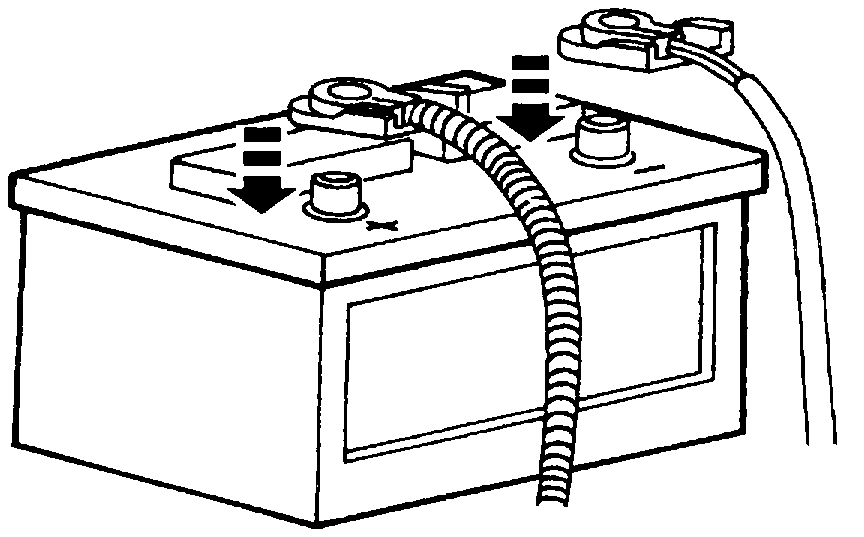

1. Disconnect the battery cables.
1 Disconnect the battery ground cable.
2 Disconnect the battery to starter relay cable and wait one minute for the backup power supply to be depleted.
Warning: to avoid accidental deployment and possible injury, the backup power supply must be depleted before repairing or replacing any air bag system components. To deplete the backup power supply energy, disconnect the battery to starter relay cable and wait one minute.
2. If equipped, remove the front floor console assembly.

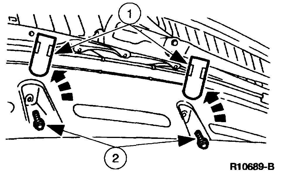

3. Remove the instrument panel steering column cover.

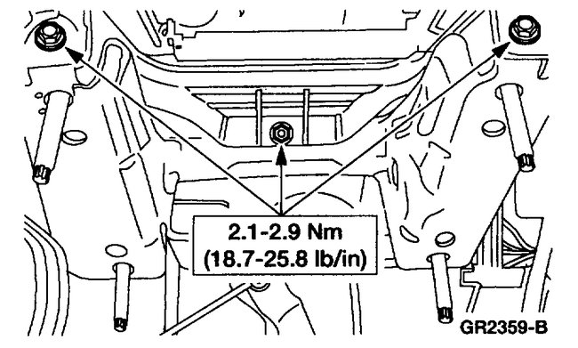

pic 2

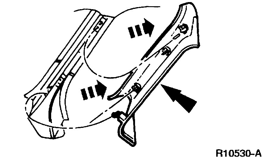

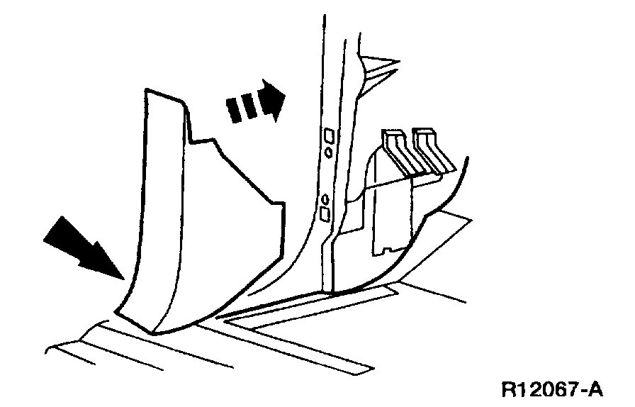

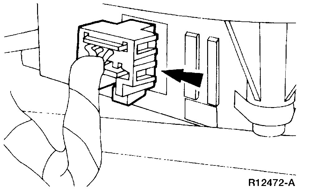

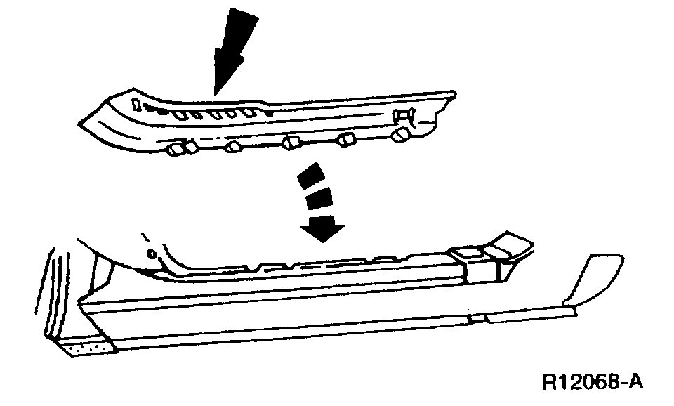

4. Remove the LH and RH scuff plates.
pic 3

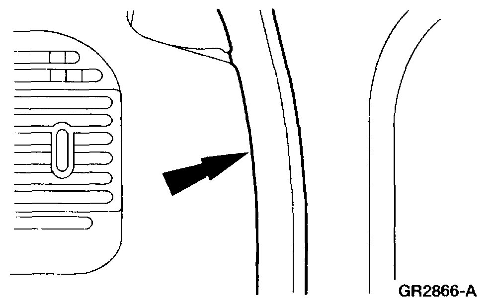

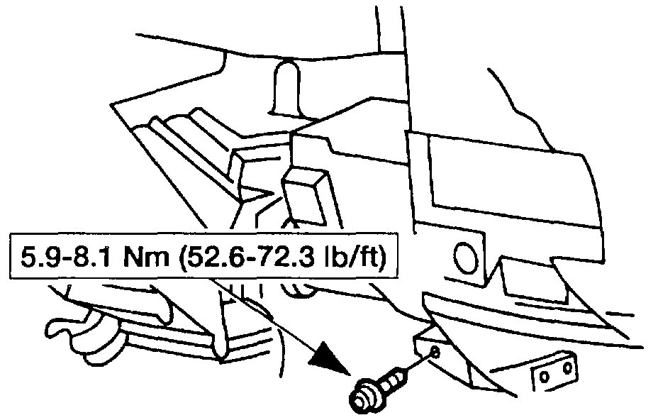

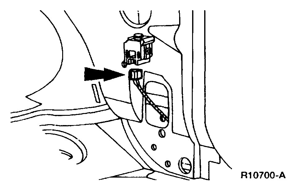

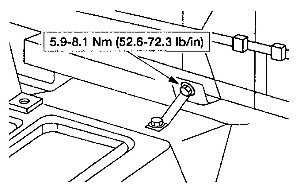

5. Remove the LH and RH cowl side trim panels.
pic 4

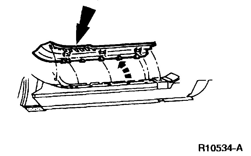

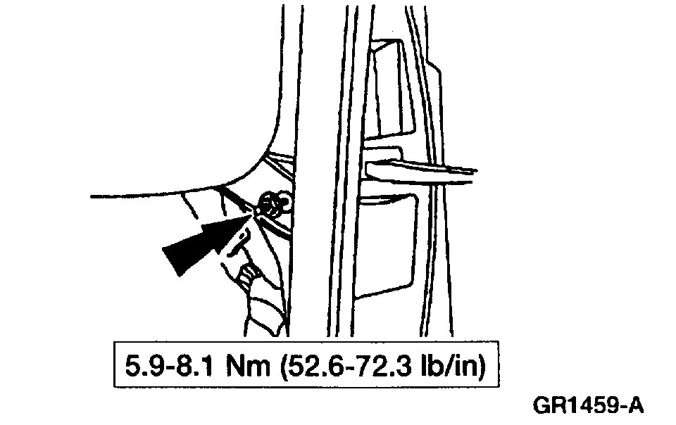

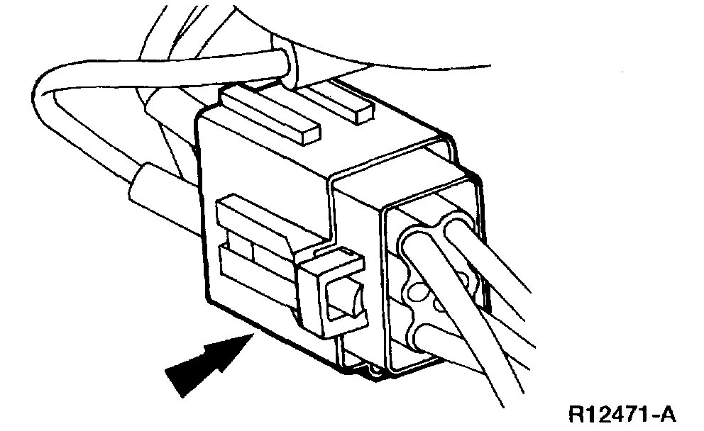

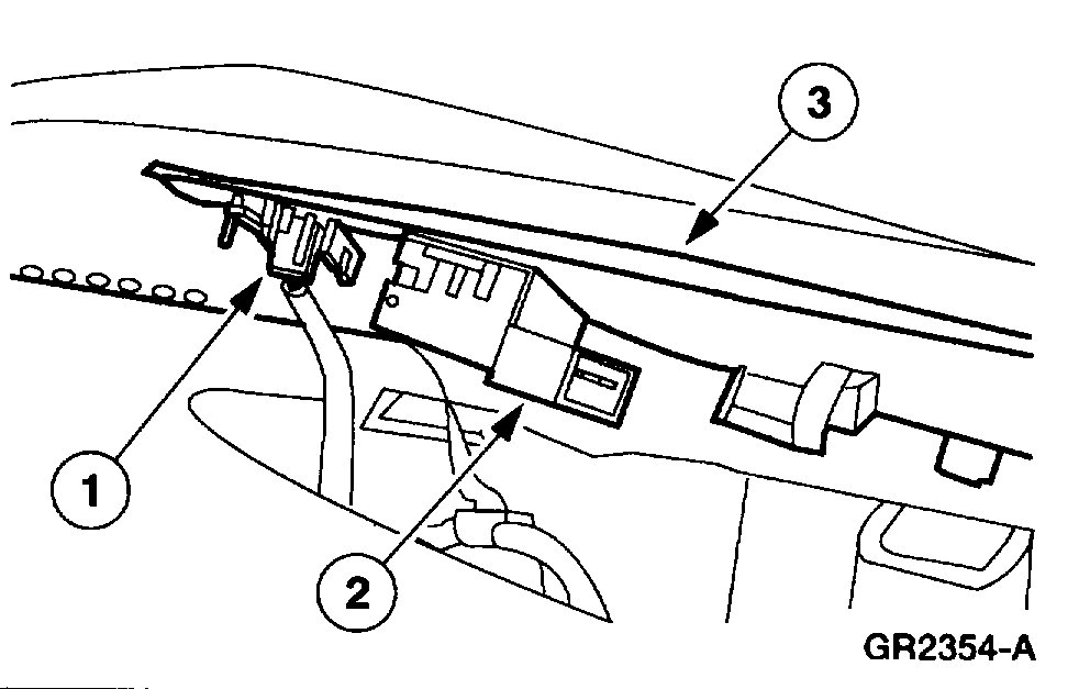

6. Disconnect the Brake Pedal Position (BPP) switch electrical connector.
pic 5

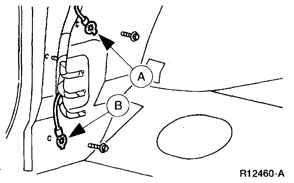

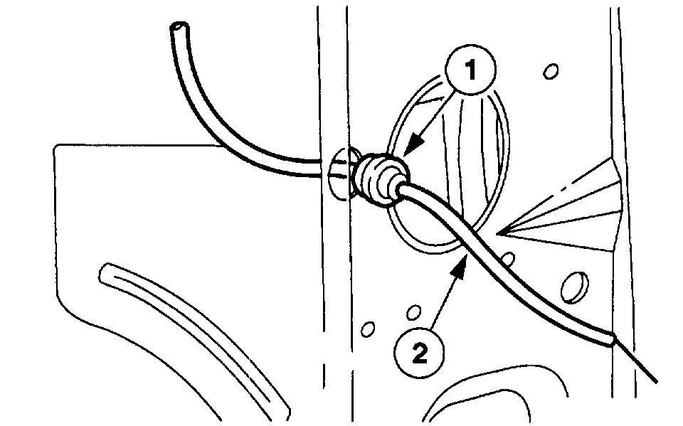

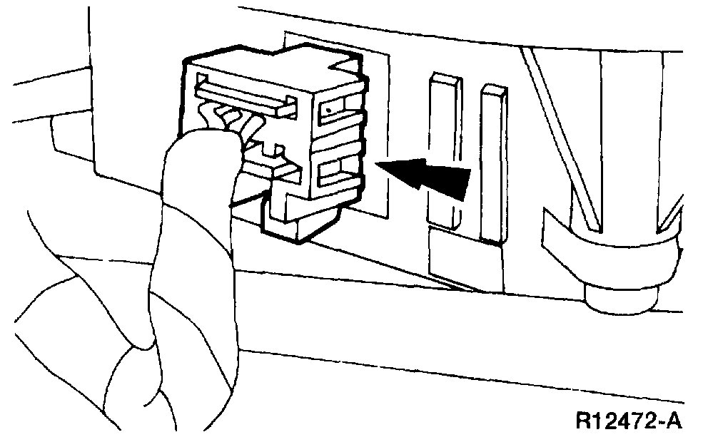

7. Remove the (A) radio ground and the (B) GEM/CTM ground bolts.
pic 6

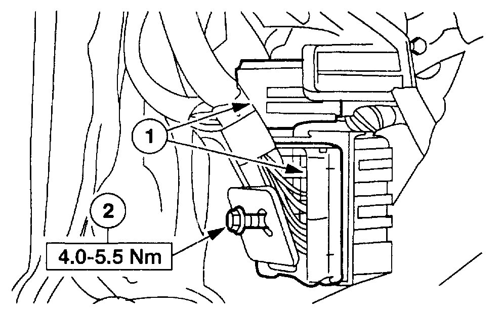

8. Disconnect the LH instrument panel main harness connectors.
1 Loosen the bolt.
2 Disconnect the LH instrument panel main harness connectors.
pic 7

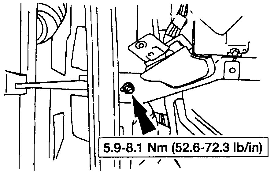

9. Remove the bulkhead wiring harness electrical connectors from inside the engine compartment.
1 Loosen the bolts.
2 Disconnect the bulkhead electrical connectors.
pic 8
10. Remove the bulkhead electrical connector from the dash panel.
1 Release the six locking tabs.
2 Remove the bulkhead electrical connector from the dash panel.

11. Disconnect the air bag diagnostic monitor electrical connectors.
pic 10

13. Remove the RH ground bolts.

14. Disconnect the RH instrument panel main harness connectors.
pic 13

17. Remove the instrument panel steering column opening cover reinforcement.
1 Remove the nuts.
2 Remove the instrument panel steering column opening cover reinforcement.
pic 16

19. Disconnect the remaining electrical connectors on the steering column.
pic 18
20. If equipped, disconnect the transmission range indicator from the steering column.
1 Remove the bolt.
2 Disconnect the cable.
pic 19
21. Lower the steering column.
1 Remove the nuts.
2 Lower the steering column.
pic 20
22. Position the RH front fender splash shield away from the dash panel.
1 Remove the screws.
2 Position the RH front fender splash shield away from the dash panel.

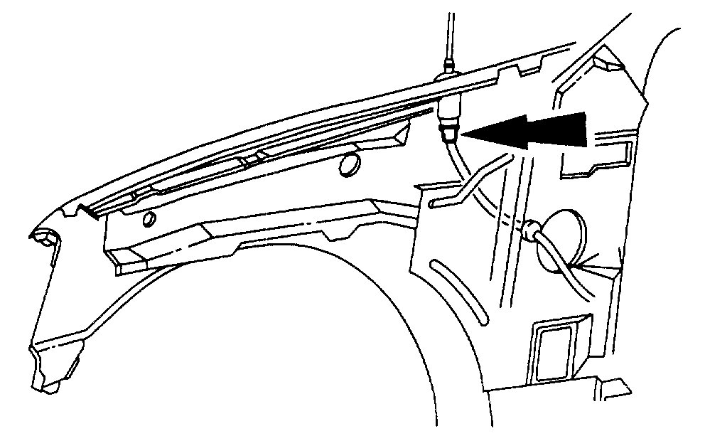

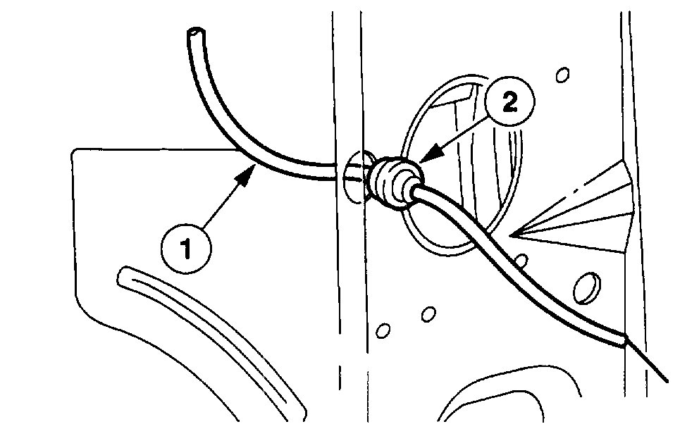

23. Disconnect the antenna lead in cable from the antenna base.
pic 22
24. Feed the antenna lead in cable through the cowl side panel.
1 Unseat the antenna lead in cable grommet.
2 Feed the antenna lead in cable through the cowl side panel.
pic 23

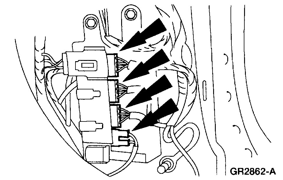

25. Remove the instrument panel relay cover.
1 Remove the cover.
2 If equipped, disconnect the autolamp sensor.
3 If equipped, disconnect the sunload sensor.
26. Remove the glove compartment.

27. Remove the passenger side air bag module.
1 Disconnect the electrical connector.
2 Remove the screws.
3 Remove the passenger side air bag module.
Warning:
*Always wear safety glasses when removing and handling an air bag.
*Carry a live air bag with the bag and trim cover pointed away from your body. An accidental deployment will then deploy with minimal chance of injury.
*Place a live air bag on a bench or other surface with the trim cover up.
pic 25

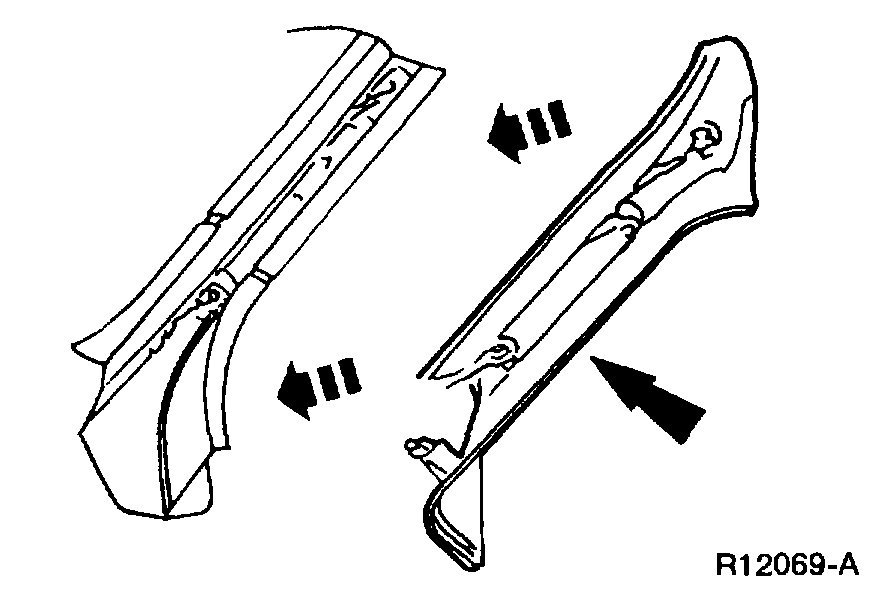

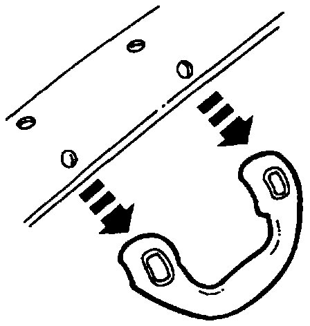

28. Remove the RH assist handle screw covers.
pic 26

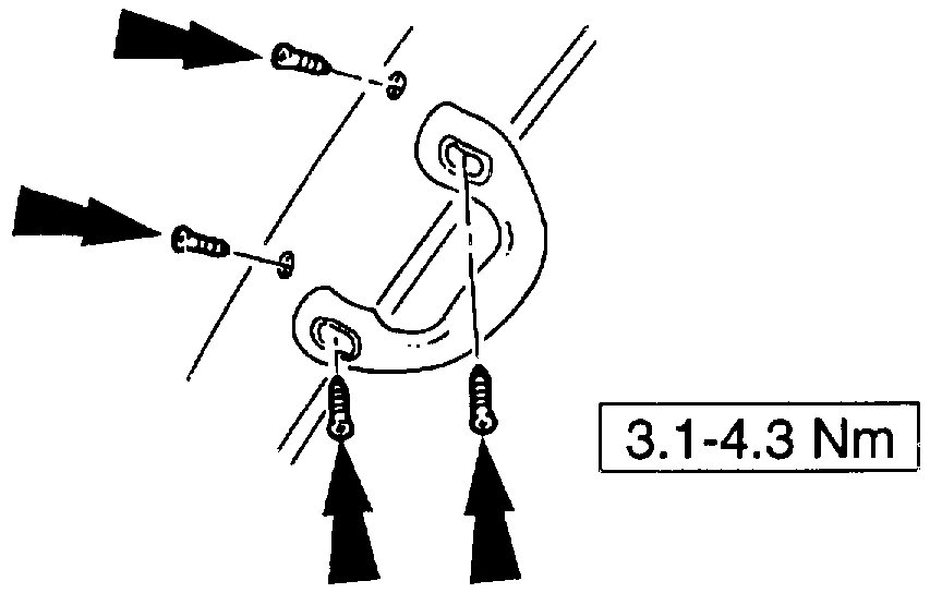

29. Remove the RH assist handle screws.
pic 27
30. Remove the RH assist handle.
pic 28
31. Position the LH and RH door weather-strip seals aside.
pic 29
32. Remove the RH and LH windshield side garnish mouldings.
pic 30

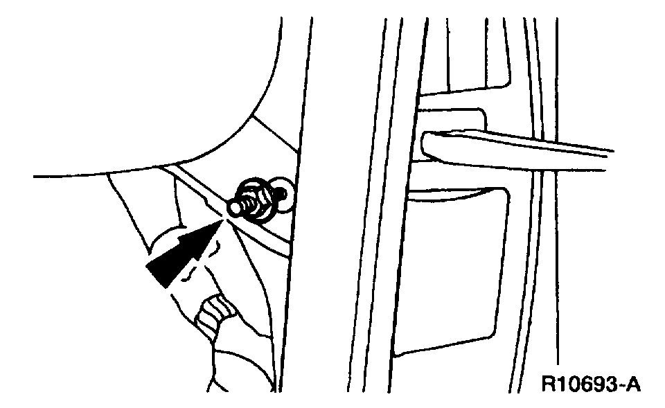

33. Remove the instrument panel reinforcement bolt below the LH corner of the glove compartment.
pic 31

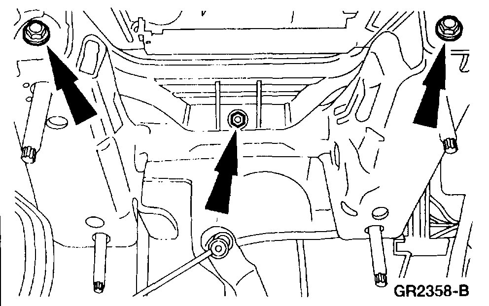

34. Remove the instrument panel bolts through the passenger side air bag module opening.
pic 32

39. Remove the LH instrument panel cowl side nut.
pic 37
40. Remove the instrument panel bolts through the steering column opening.
pic 38
41. Remove the instrument panel to floor brace bolt.
pic 39
22
42. Remove the instrument panel.
NOTE: Two bullet connectors secure the instrument panel to the bulkhead.

1. Position the instrument panel.
^ Align and seat the instrument panel to the bulkhead.

6. Install the instrument panel bolts through the passenger side air bag module opening.
^ Install the RH bolt first.

7. Install the instrument panel bolts through the steering column opening.
pic 47
8. Install the LH instrument panel cowl side nut.
pic 48

15. Connect the radio ground and the GEM/CTM ground bolts.
pic 55
16. Connect the LH instrument panel main harness connectors.
1 Connect the instrument panel main harness connectors.
2 Tighten the bolt.
pic 56
17. Connect the Brake Pedal Position (BPP) switch electrical connector.
pic 57
18. Install the RH ground bolts.
pic 58

20. Install the LH and RH cowl side trim panels.
pic 60
21. Install the LH and RH scuff plates.
pic 61

pic 62

24. Install the RH assist handle screws.
pic 64
25. Install the RH assist handle screw covers.
