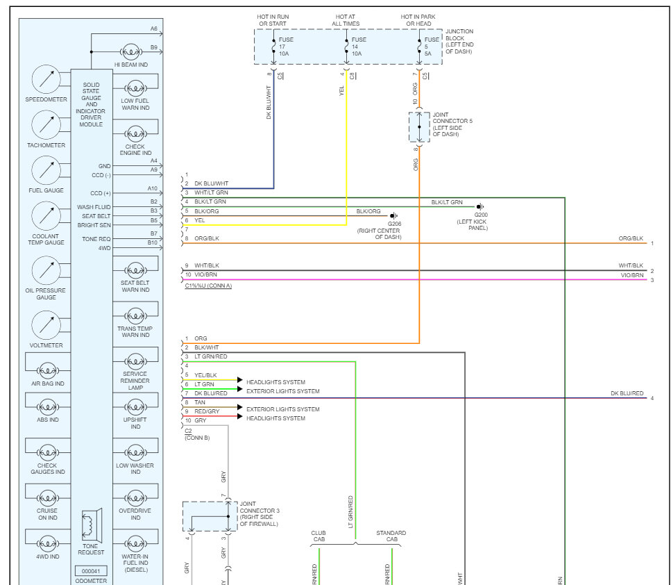

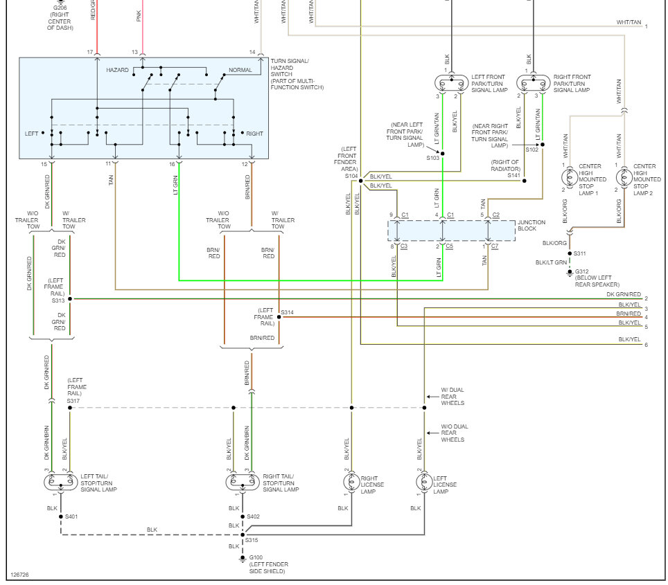

The dash lights won't come on and the blinkers and hazards won't work. I have check fuses relays and grounds, but I cannot find anything wrong.
Jun 4, 2023 at 7:47 AM
  • 55,456 POSTS

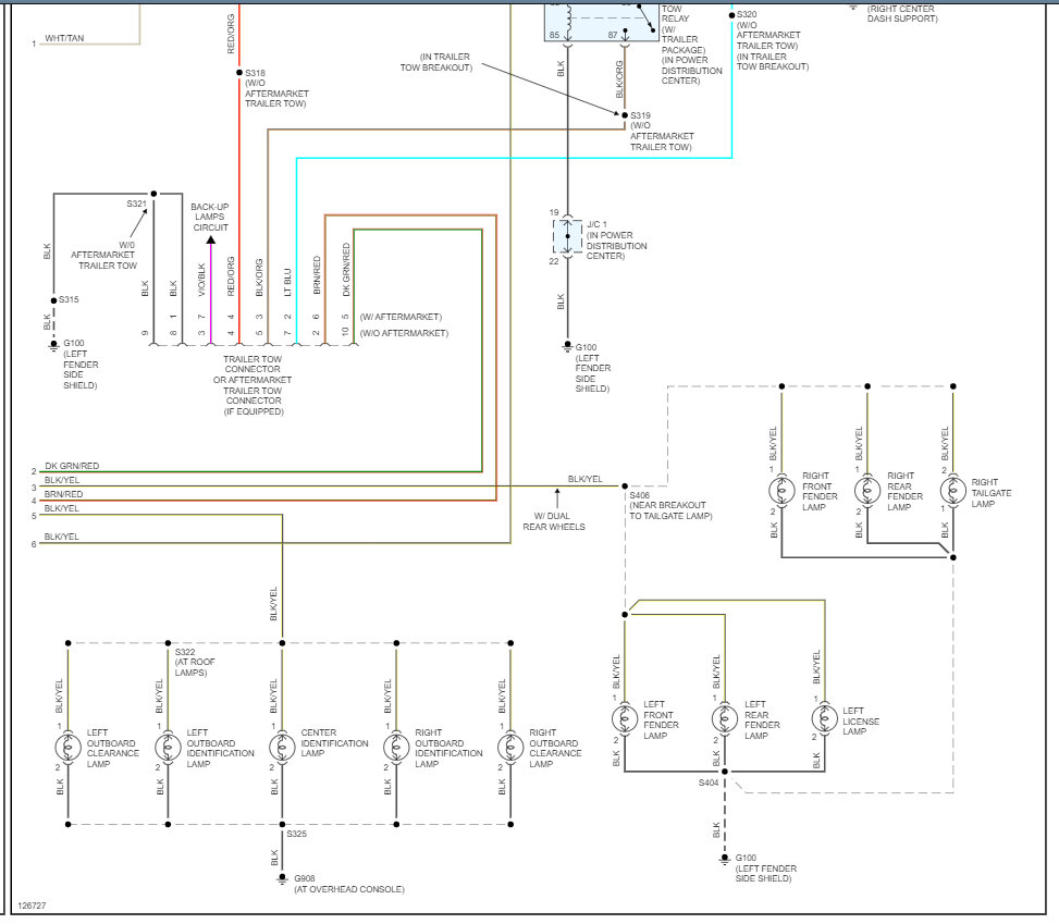

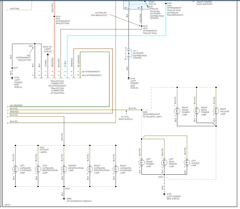

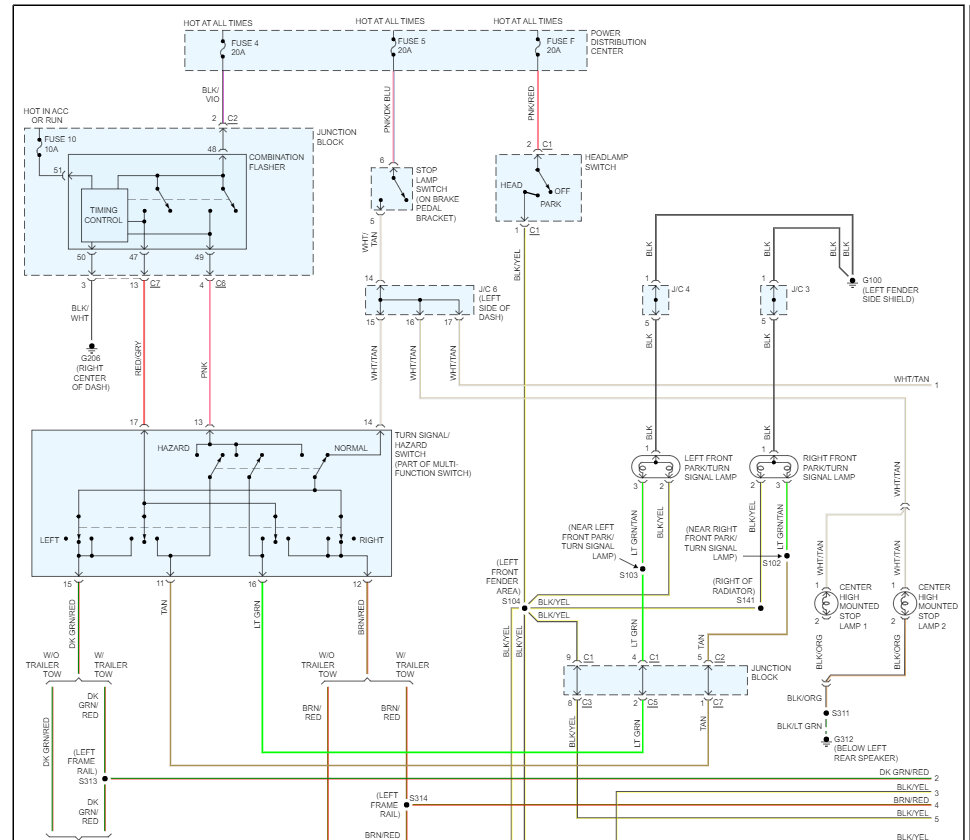

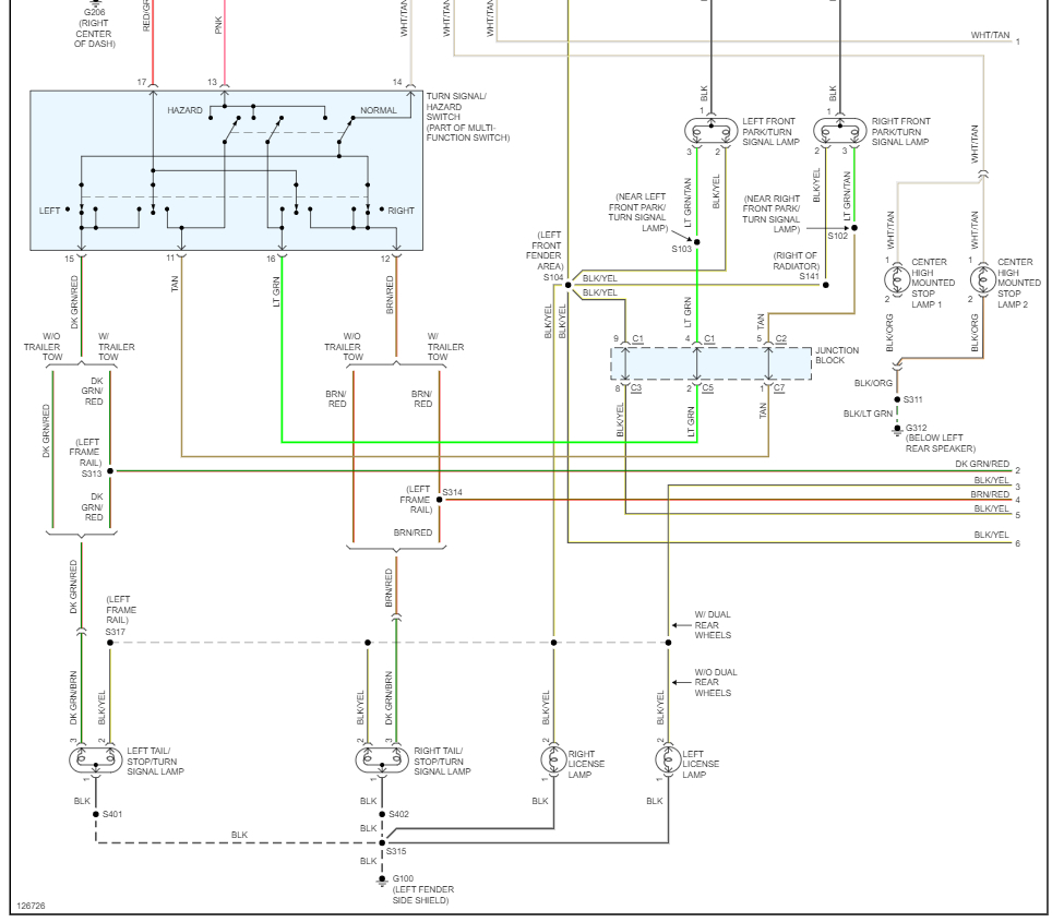

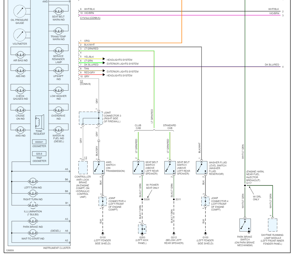

I would check for power at the fuses in the wiring diagrams below which show the fuses used and how the lighting system work, it sounds like the headlight switch might be out or a have a shorted lighting socket.
Check out these guides to help:
and
https://www.2carpros.com/articles/no-tail-lights-exterior-running-lights-tail-lights-out
Jun 5, 2023 at 6:04 AM
JHALE
I have done that already, there is power there.
Jun 5, 2023 at 11:57 AM
JHALE
I have also switch all of the switches out with ones that I know for sure work.
Jun 5, 2023 at 12:00 PM
  • 55,456 POSTS
Where is there power? I need more details and images of the problem.
