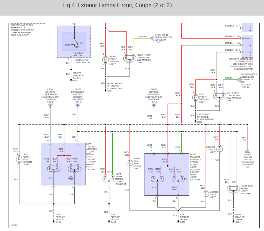

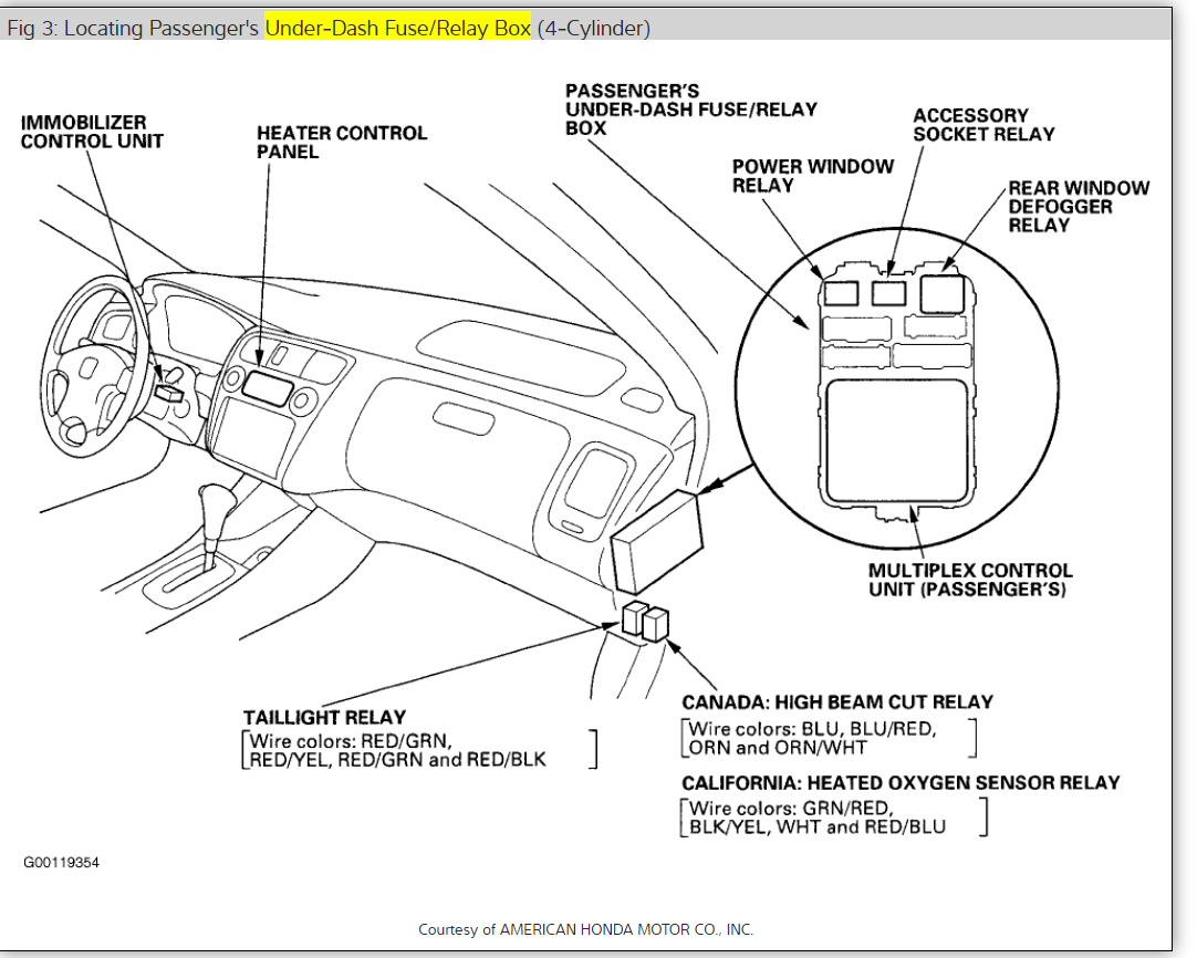

It sounds like you have a tail light relay that is out. Here is a guide to help you test it and the relay location with the wiring diagrams so you can see how the system works:

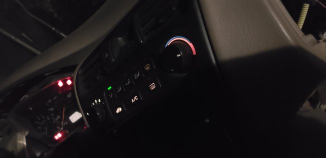

When I connected my test light to this wire red with green stripe all the dash, taillights and climate control lights came on but it was like they stayed direct meaning it was as if they were getting direct power because they stayed on even with the key off the ignition and light switch off. If I had the wiring diagram for this plug maybe I could get somewhere.

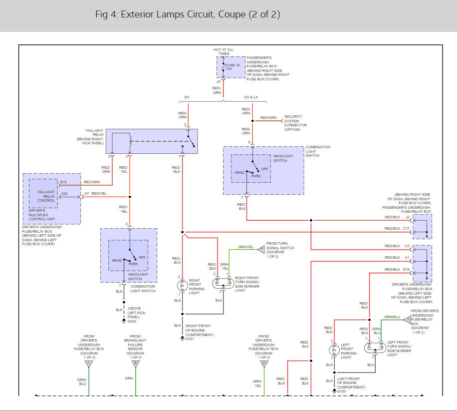

I see the drivers side multiplex unit involved in the lighting system just two wires which are controls the taillight relay. Lets try jumping the wires to see if the system comes to life. Red/green - red/black let me know.

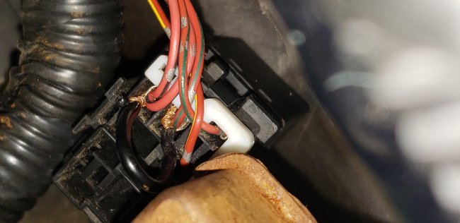

I jumped the red/green with the red/black on the taillight relay plug and the lights did come on, but I turn the light switch on and off and the lights stay on even with the key out of the ignition and light switch on the off position. Then when I un-jump the connection they turn off and do not work anymore. Here are the two wires I jumped on the taillight relay plug!

Can you make sure the bulb are grounded? Here is a guide to help confirm. Check the wiring diagrams to see where you are losing power.
https://www.2carpros.com/articles/no-tail-lights-exterior-running-lights-tail-lights-out
Cheers

Sorry, here is a guide that will help you get started. See if there is power coming out of the red and black wire from the tail light relay with the lights on.

If the relay is working the red and black should have power check out the wiring diagrams above it shows the connection.

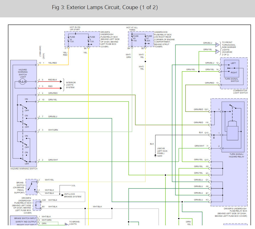

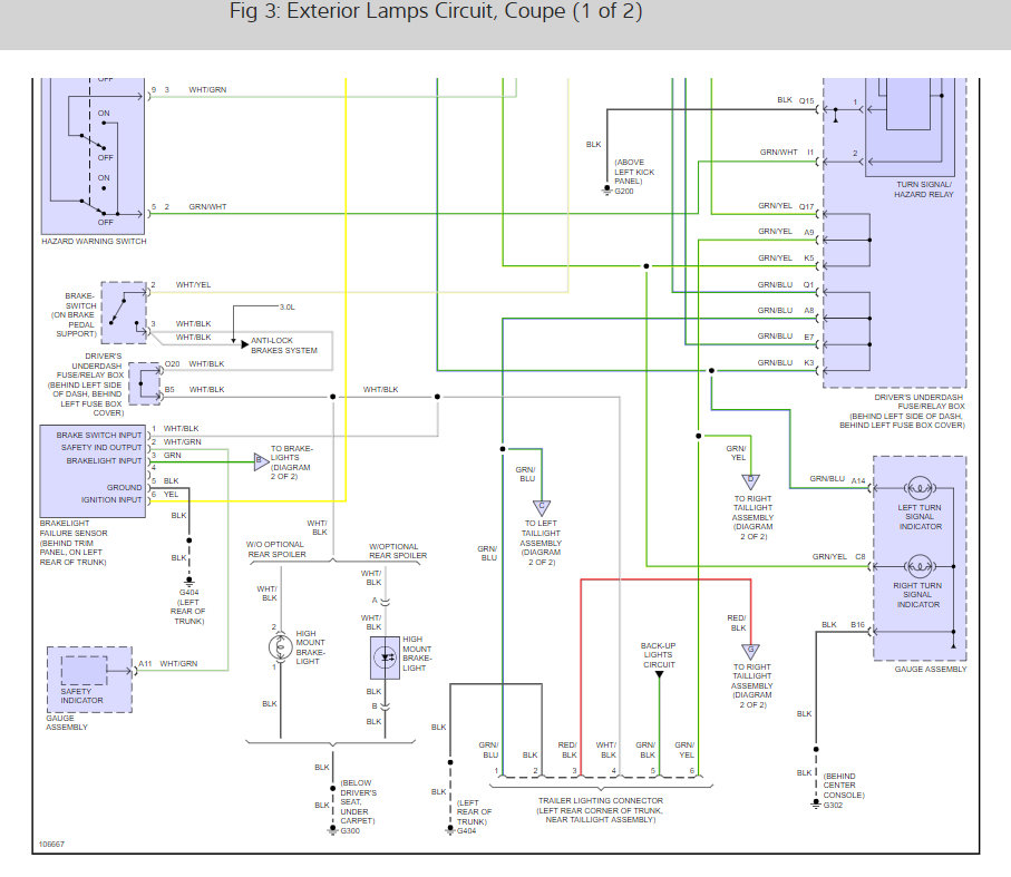

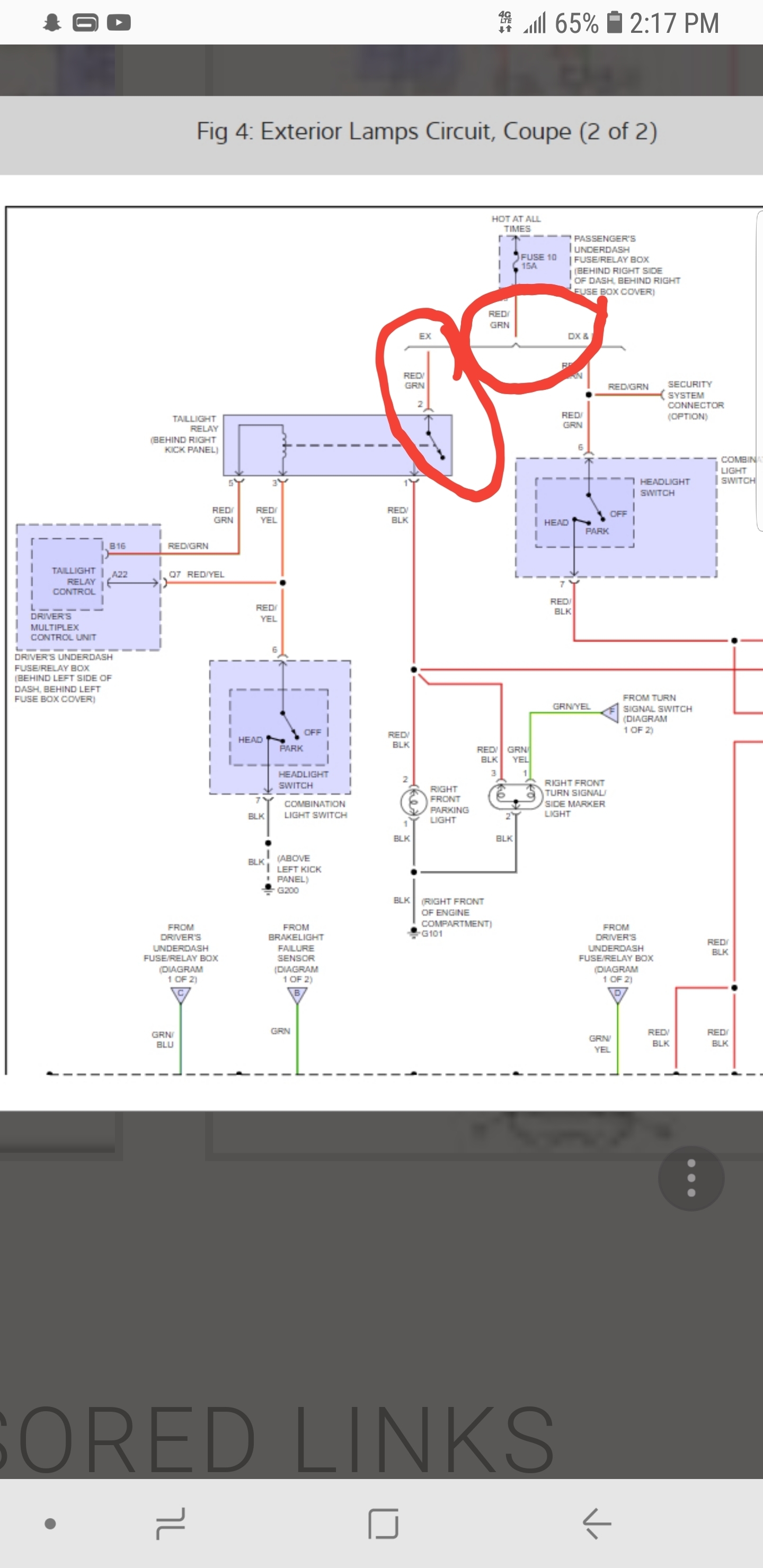

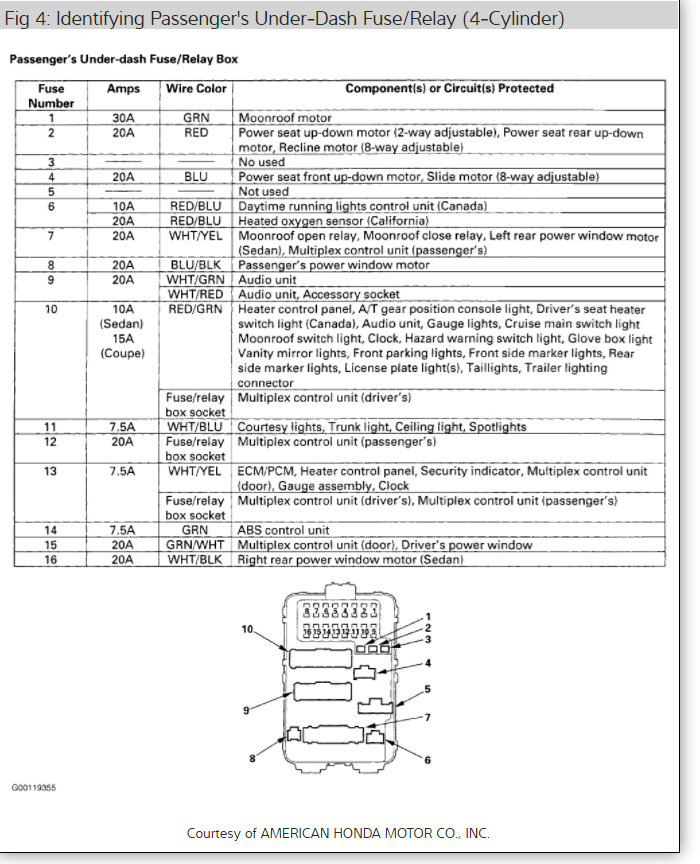

Red and green is power or am I reading the diagram wrong. I highlighted the wires on the diagram below that are hot at all times. Does that not make it a power wire? Also, I checked the relay and it was good, I even replaced it with a new one to be 1000% sure. If the red and green is power then the relay is getting power to it.

See the wiring diagrams and the switch of the relay goes to red and black which goes to the lights. Put power down red and black to see if the lights come on.

If the red and green have power then the relay is not working. Red and green connected to red and black through the relay. Are you sure the relay is good. How is the wiring going to it does it have power and a ground trigger?

Red and green are power from the fuse panel, check the wiring diagrams it shows the circuit.

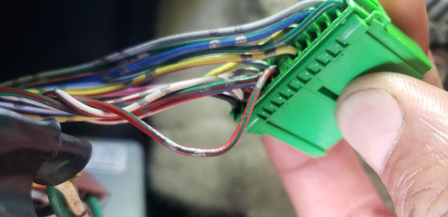

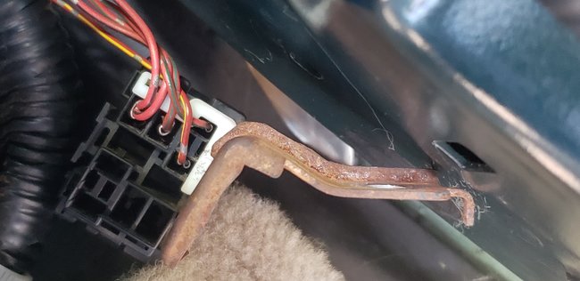

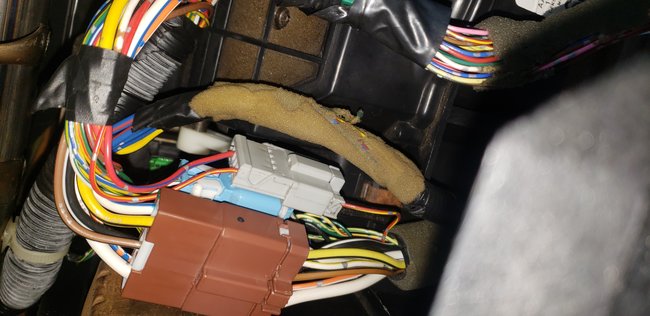

I found out what the problem was. This plug!!
The lower red and yellow wire was pinned with the red and blue wire instead of it being pinned with its twin on top. Why it was like that I have no clue?
May 17, 2021 at 5:30 AM
CARLOSV3326
  • 17 POSTS
All I did was re-pin the lower red and yellow wire over so it could connect to its upper red and yellow twin and voila it is Christmas in fall. Haha
