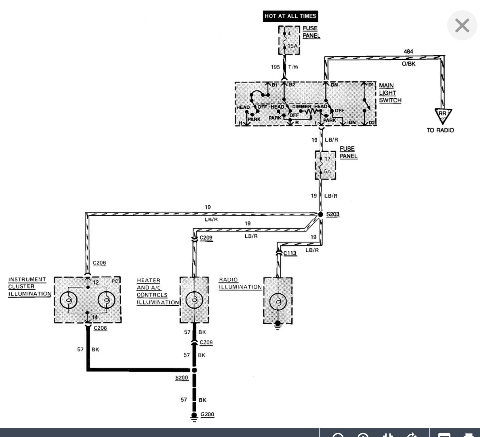

When I pull my switch on halfway, the dash and running lights all come on, but when I pull the switch out all the way to turn the headlights on, the dash and running lights go off. Is this just a bad switch or a bad connection?
Feb 20, 2022 at 5:30 PM
I would first and foremost think the switch is the issue.
I have seen this a number of times over the years, and it normally is a switch issue. So, to confirm this we need to check the voltage coming from the switch in both positions on each of the wires.
Basically, what I suspect is happening is the contacts inside the switch have failed and just no longer make contact when the switch is pulled all the way out on the other lamps. Clearly, they all operate but just not in each of the switch positions that they are supposed to.

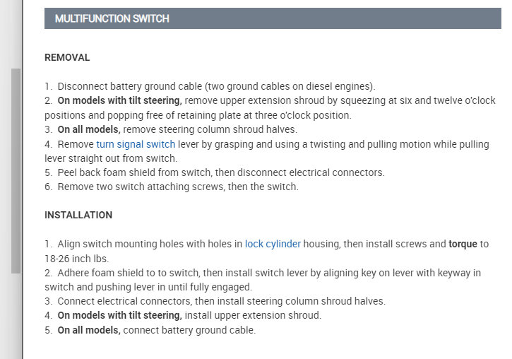

So here is a guide that will help with checking the voltage on these wires:
I am attaching the wiring diagram below but if it were me, I would replace the switch and retest the operation.
Let me know if you have questions or what you find. Thanks

Thank you. I replaced the switch and it works perfect now!
