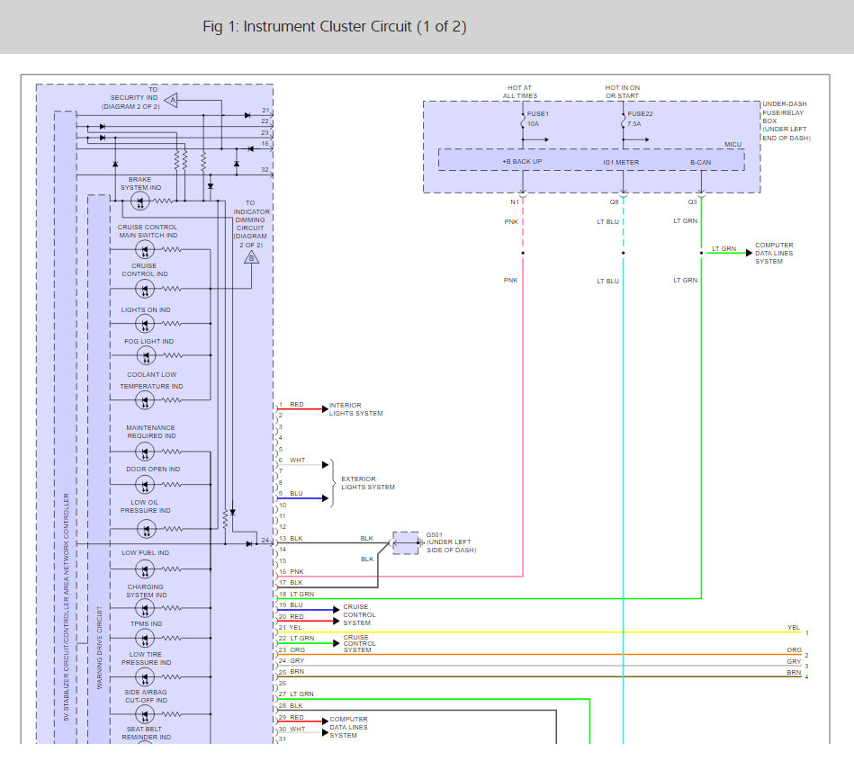

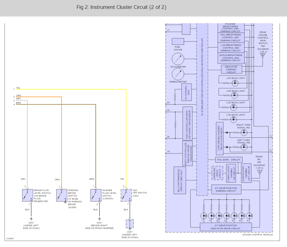

Replaced bad battery. Dash issue very eight seconds the tachometer, speedometer and fuel gauge goes to zero then resets itself. I tried putting + to - no effect.
Jul 25, 2017 at 8:54 AM
  • 55,399 POSTS

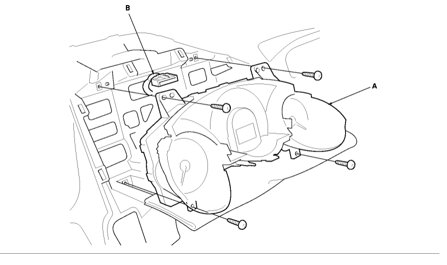

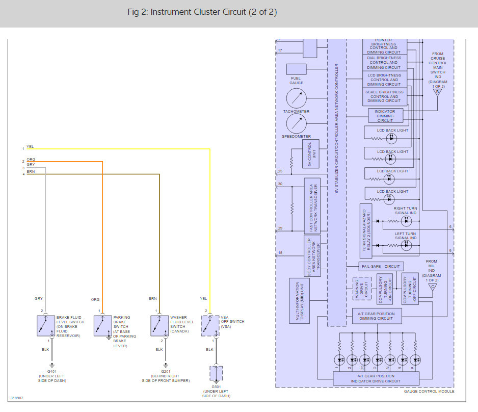

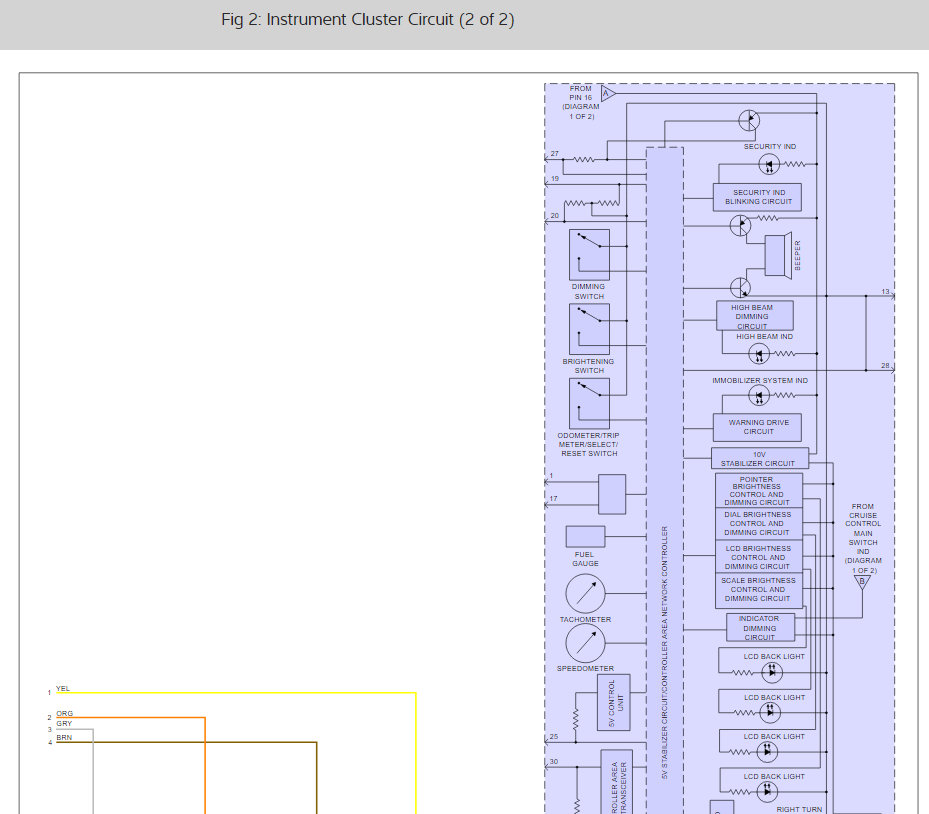

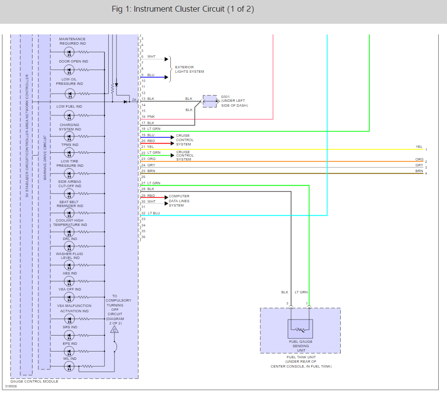

It sounds like you have a cluster that has gone out, or there is a bad connection at the cluster. Here are some diagrams (below) to help you with the problem.
You can check the power and ground as well, here is a guide to help you
