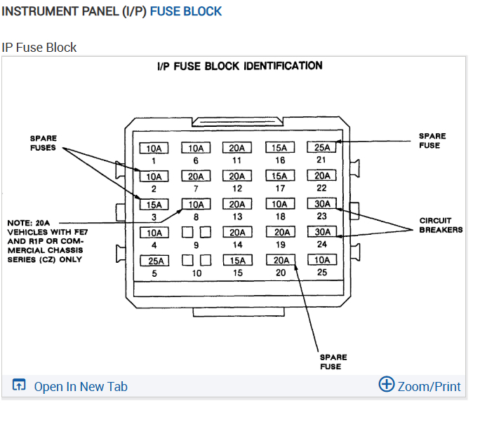

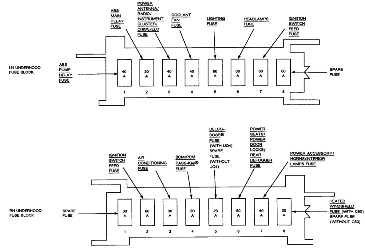

Fuel readout AC and heat all quit at the same time.
Jun 24, 2025 at 1:05 AM
Experienced Mechanic
55,682 POSTS
I would start by checking the fuses, this guide can help start testing with the key on:
