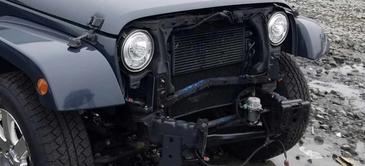

What potential damages that this vehicle have?
2017 JEEP WRANGLER
86,000 MILES • 3.6L • V6 • 4WD • AUTOMATIC
CHARBEL111111
Hi, i want to buy the following wrangler from the auction, can you illustrate to me the potential damages that this wrangler have? Thanks!

Good morning,
That is a light hit but I cannot see all the damage.
You need a radiator support, frame rails straightened out, bumper, grille and possible suspension work.
Based just on that, I would guess at $3,000.00 for that plus any work I cannot see.
I would be very careful considering this purchase.
