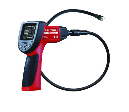

If I understand this correctly the timing chain broke and they can't tell if it damaged the engine?
If that is the case then they are worried the valves made contact with the pistons. The best way to determine this is to remove the injectors and put a borescope (small camera) down the hole to look at the pistons to see if there is damage.
If there is no damage then it should be good to go with the repair.
Please clarify if there are other concerns from the mechanics. Thanks
