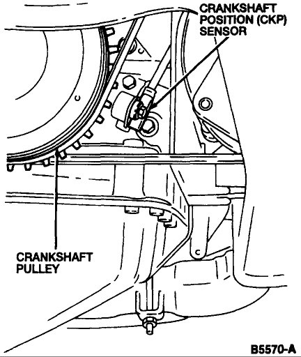

Damage to crank shaft sensor
1996 FORD PROBE
180,000 MILES
SCOTTJBROWN70
Crank sensor is being hit by the flywheel. Only started to occur since engine was replaced. Not sure if there is a difference in engines the would change clearance. Also, not sure if there is supposed to be a shin (flex plate?) in between engine and transmission. Are there more than one length sensor? Please advise.
Thank you in advance. this car is a two door four cylinder.

The crank sensor has to be set for clearance from the pulley when installed. You use a feeler gauge and set it for right around 1mm. Check out the diagrams (Below). Please let us know if you need anything else to get the problem fixed.
