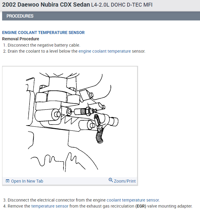

I just had a service which cost me £420 abd my car was returned with the temperature gauge not working. I'm sure it was working before the service.
Thank you Fred Williams
Dec 29, 2009 at 10:49 PM
SQM
  • 6,383 POSTS

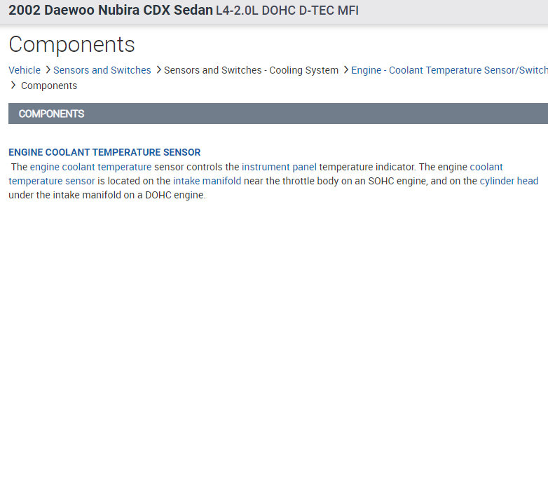

Was the service done for the gauge not working or cooling system related?

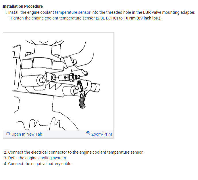

If the temperature was working before, then it is possible that the connector could have came loose or was not secured.
Check the wire harness that is attached to the back of the sensor. Make sure it is secured and clear of any corrosion.
https://www.2carpros.com/articles/coolant-temperature-sensor-cts-replacement
