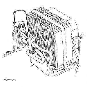

I bought into the car manual that promised diagrams and images, and I spent 2 hours trying to find the location of the expansion valve for my mechanic... I am a bit frustrated and still empty handed... can you help?

Inside evaporator box under dash TXVon inlet to EVAP
