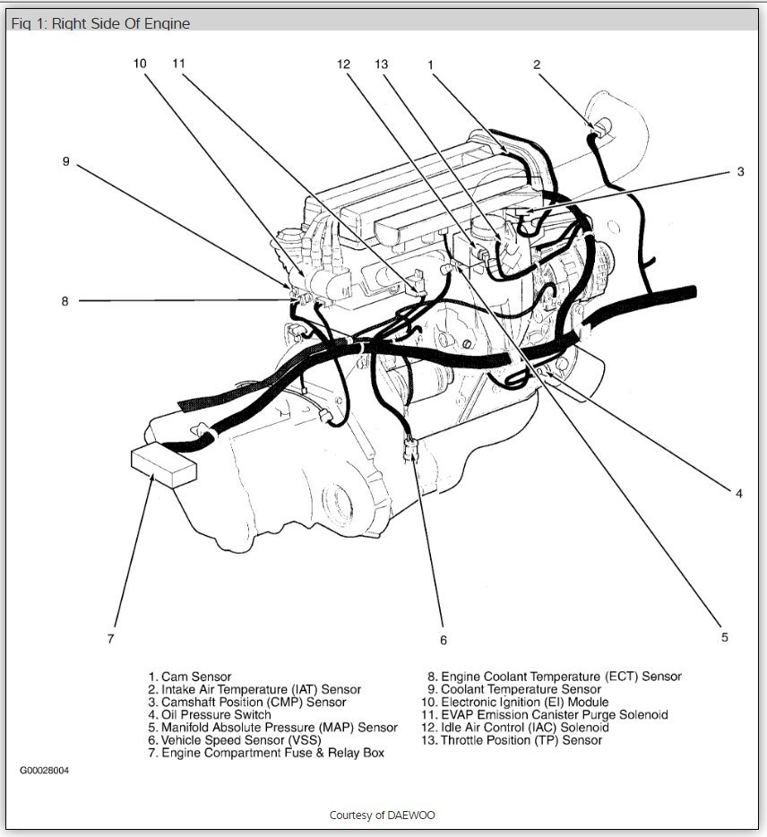

I have found that the vehicle speed sensor (VSS) on my 2000 Daewoo Nubiria wagon is bad. I have the new part, but I can not locate the existing sensor. Can you tell me where to find it?
Thanks.
Aug 27, 2009 at 5:17 PM
  • 55,423 POSTS
It is down on the transmission just behind the engine, here is a diagram showing the exact location.
Please let me know if you need anything else to get the problem fixed.
