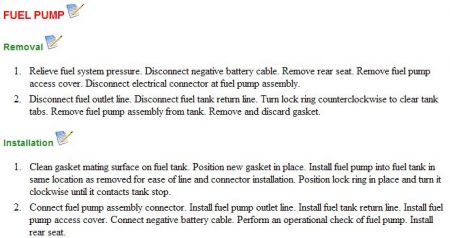

2000 Daewoo Nubira 4 cyl Front Wheel Drive Automatic
IS THERE AN EASIER WAY TO CHANGE THE PUMP WITHOUT DROPPING THE TANK? PLEASE GET BACK TO ME AS SOON AS YOU CAN.
Mar 11, 2009 at 7:18 AM
BLUELIGHTNIN6
  • 16,542 POSTS
Your vehicle is equipped with an access panel, no need to drop the tank..Replacement procedures are below..
https://images.2carpros.com/forum/automotive_pictures/261618_Noname_316.jpg
