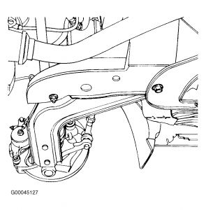

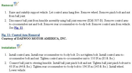

How do I install a lower control arm?...how do I remove the old one and replace with the new?
