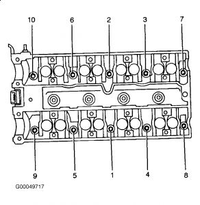

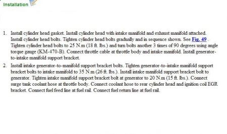

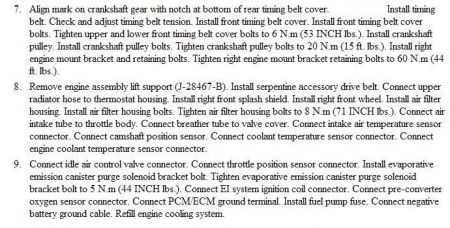

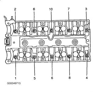

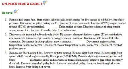

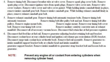

2000 Daewoo Nubira 4 cyl Two Wheel Drive Automatic

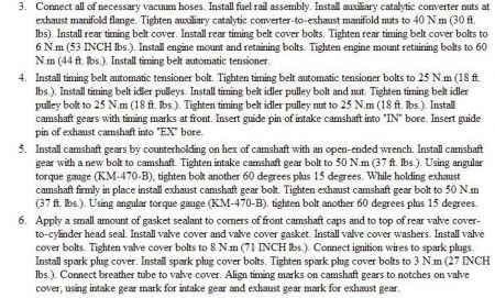

I have never changed a head gasket in a daewoo
and I don't want to mess up anything in the process
if I could just get step by step process instructions I know I could fix it Can you help me?

https://images.2carpros.com/forum/automotive_pictures/261618_Noname_652.jpg
https://images.2carpros.com/forum/automotive_pictures/261618_Noname2_166.jpg
https://images.2carpros.com/forum/automotive_pictures/261618_Noname3_62.jpg
FIGURE 15
https://images.2carpros.com/forum/automotive_pictures/261618_15_1.jpg
https://images.2carpros.com/forum/automotive_pictures/261618_Noname4_37.jpg
FIGURE 49
https://images.2carpros.com/forum/automotive_pictures/261618_49_1.jpg
https://images.2carpros.com/forum/automotive_pictures/261618_Noname5_18.jpg
https://images.2carpros.com/forum/automotive_pictures/261618_Noname6_11.jpg
