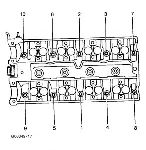

torque specs on the head and camshafts

Torque to yield tool needed Step 1-25 ft. lbs. Step 2 - 90 degs. Step 3 - 90 degs Step 4 - 90 degs sequence
https://images.2carpros.com/forum/automotive_pictures/198357_Graphic_690.jpg
