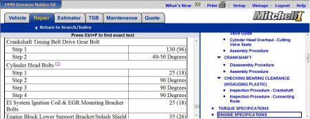

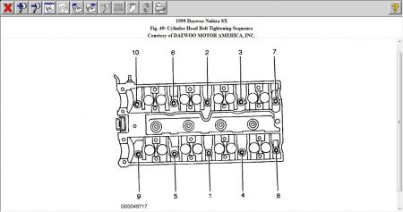

what are the torque specifications for the head and the bolt tightening sequence?
Jul 29, 2009 at 11:07 AM
  • 75,992 POSTS
Here you go -Good Luck Step1 and then follow the rest 90deg turn see below
