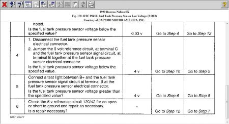

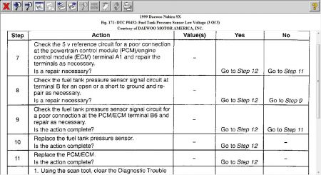

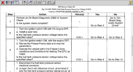

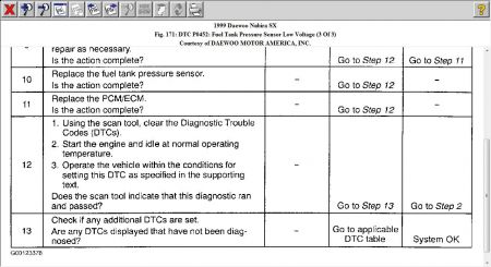

THE CAR HAS A P0452 FUEL TANK PRESSURE SENSOR LOW VOLTAGE CODE i would like to know to go about this in diagnosing what it is and not just buying stuiff that isnt broke thank you for your time and patience

P0452 Flow Chart
